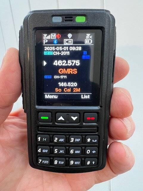

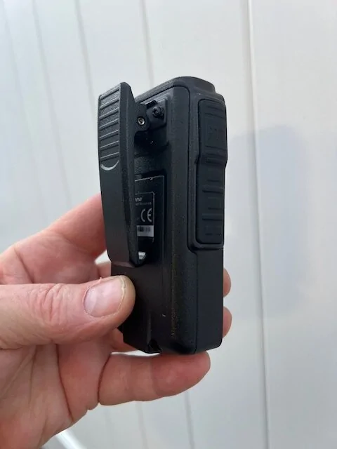

I've had another radio for a couple of years mostly as a base station, an Anytone AT-578UVIII Plus that covers 2m amateur and VHF commercial, 440 amateur and UHF commercial and the 220 amateur band with DMR digital and works really well, but its front panel display is way too small to see at arms length and it does not have a removable control head. At least it didn't until recently when they came out with a wireless Bluetooth hand held control head/speaker mic. I recently got the wireless control head and its a fantastic solution for any cramped space mobile installation. You can stick the main radio under a front or rear seat and run power/antenna to it then forget about it. You then run the wireless control head with display, speaker and mic and clip that to your shirt or a sun visor or stick it anywhere since its smaller than a pack of cigarettes.

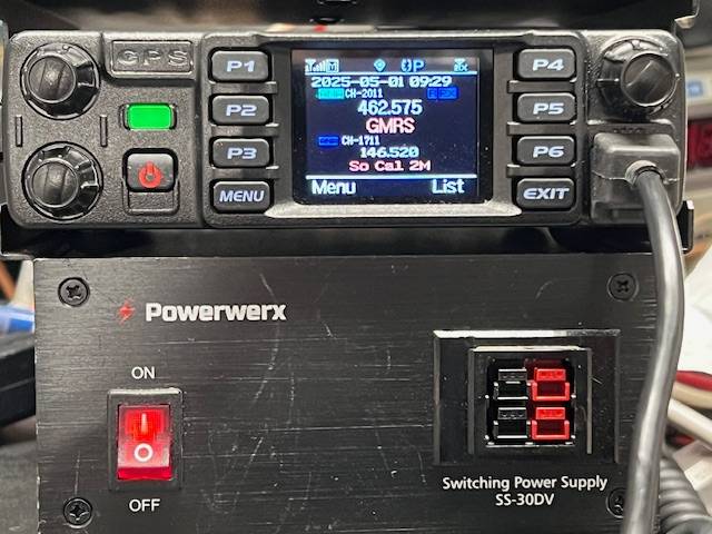

Here is a picture of my radio currently mounted to a power supply with grab and go case and the new wireless control head thing.
