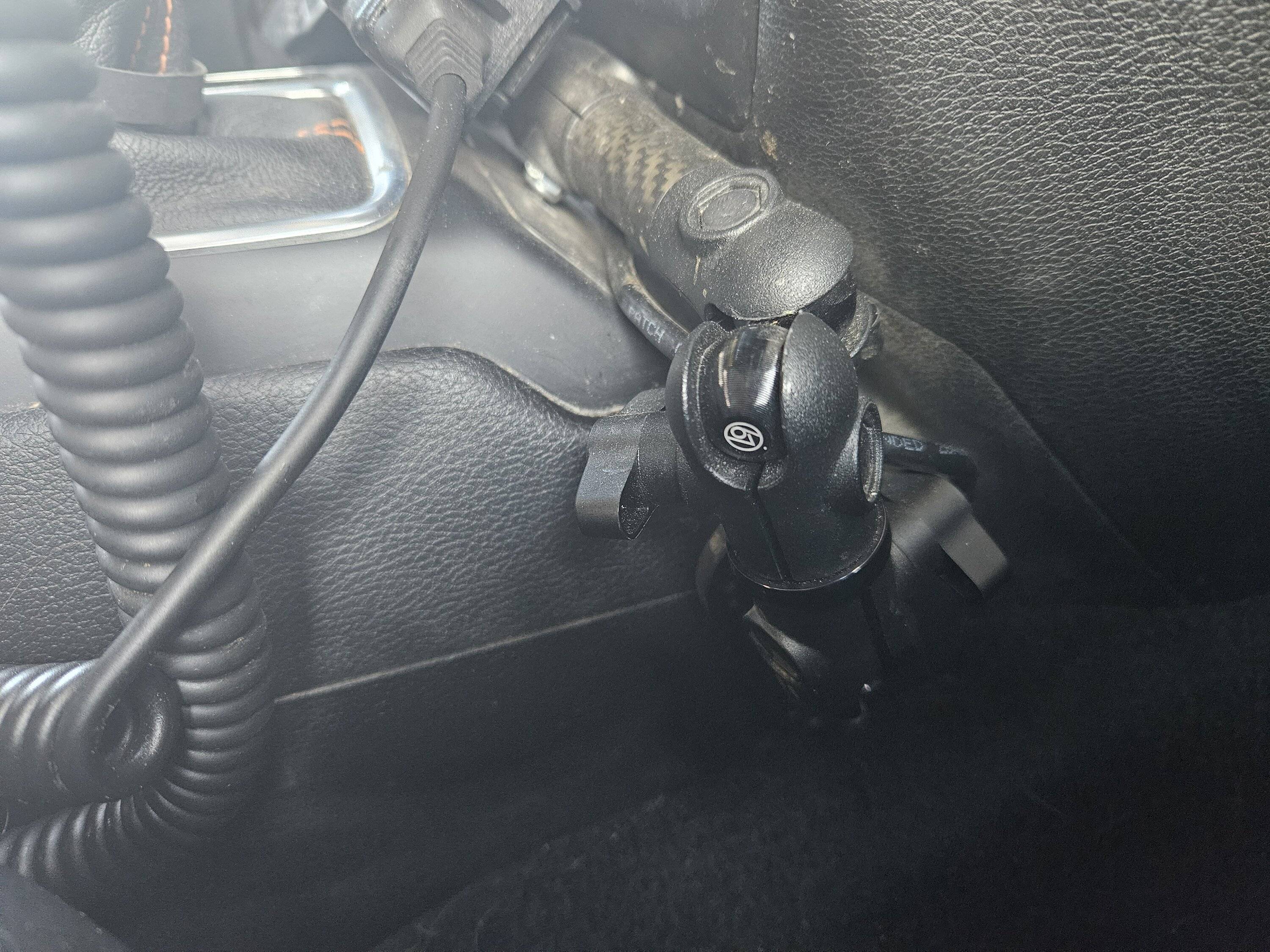

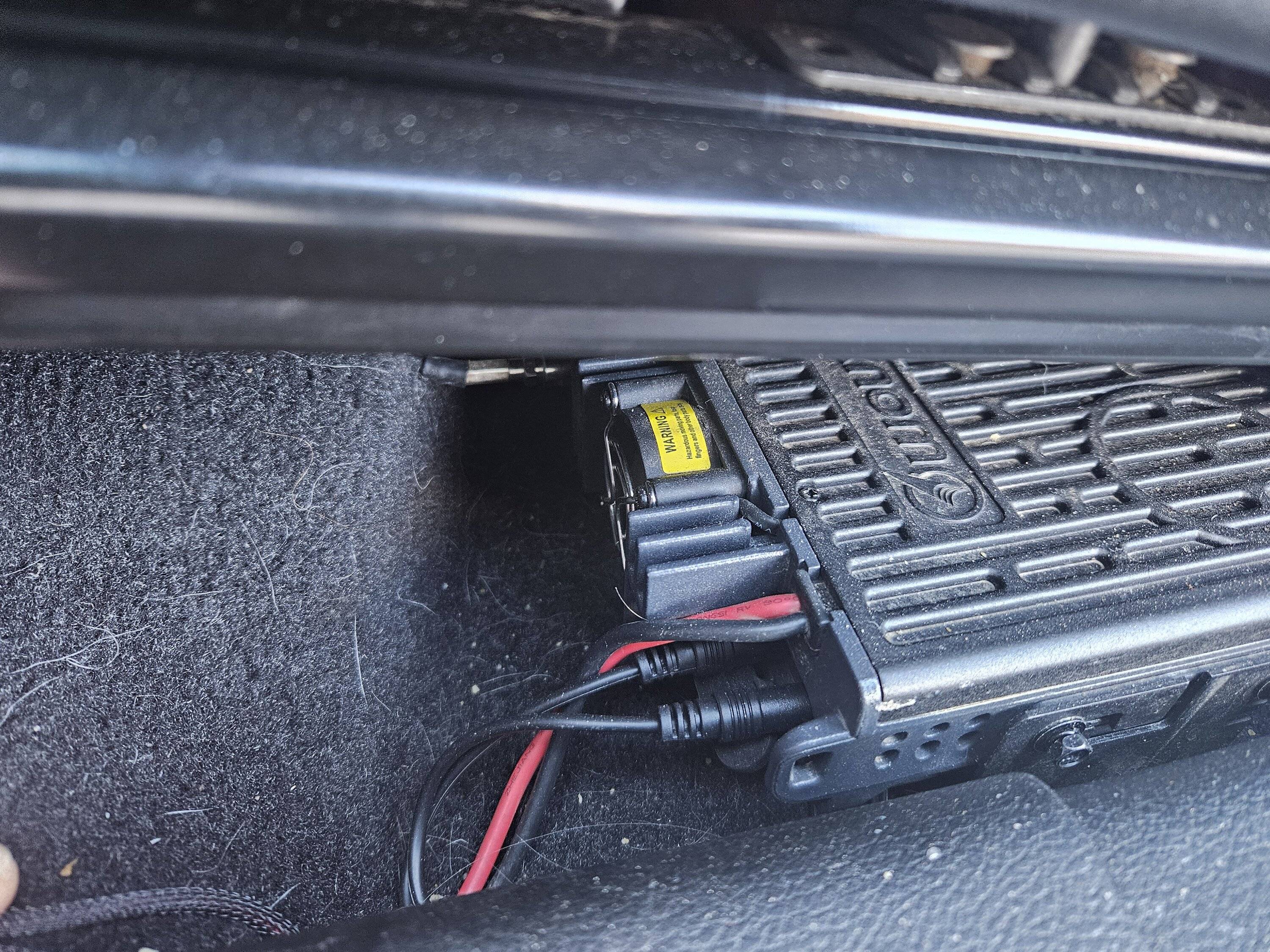

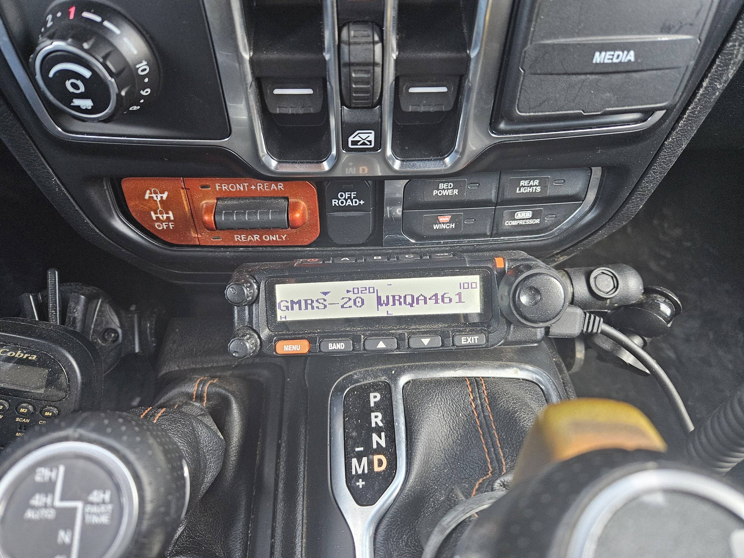

Here are the pics for my Wouxon Install. I wired the external speaker output to the front left dash speaker using THE WIZ External Speaker Wizard and PAC APH-CH03 AmpPro Harness, which is quite nice while running around with top off/doorless
Do you have the base unit's bracket screwed to the floor? Do you get water in from the mounting screws? (new to the jeep thing)
