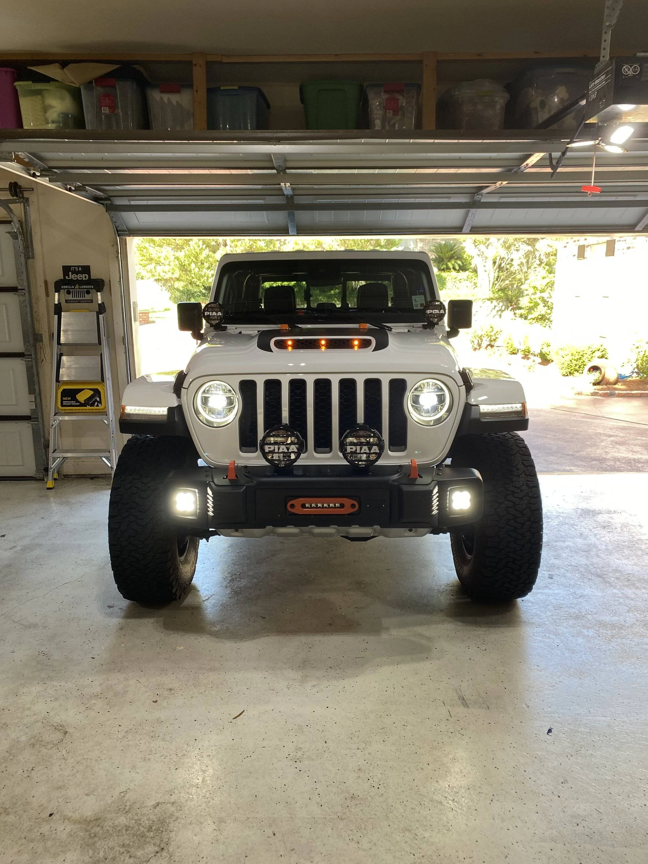

What mount did you use for the Flex Era 3's on the bumper? Thanks a lot!
I didn’t use any mount, I removed a couple of the bumper bolts that weren’t attached to anything and they fit in perfectly.

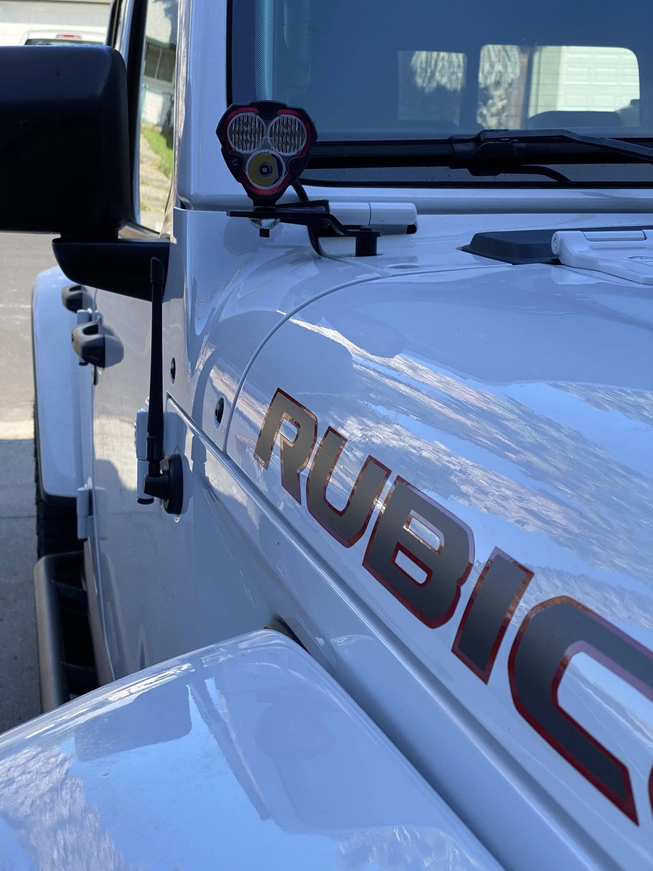

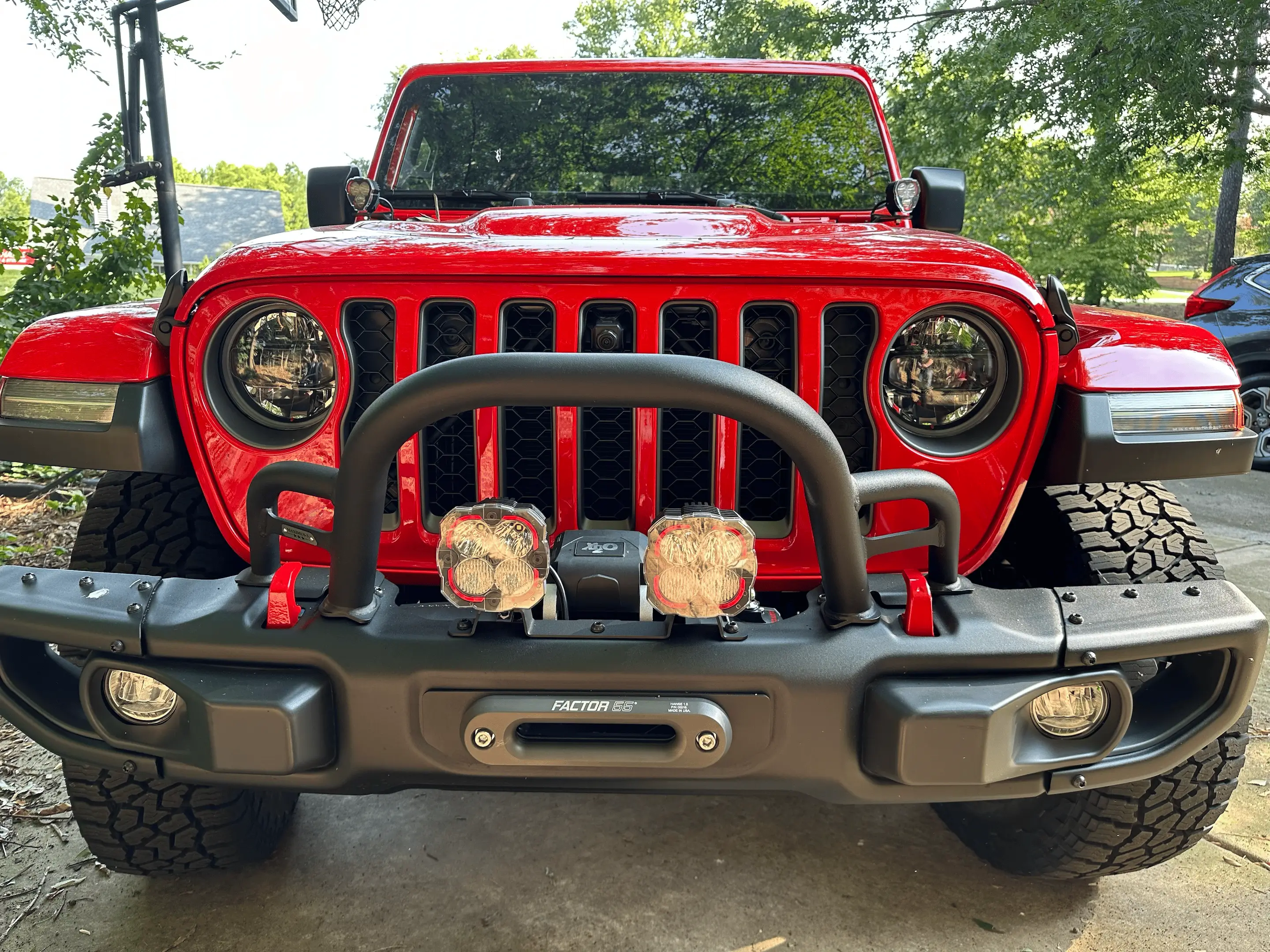

I have had one pair of flex era 4’s on my bumper for almost 3 years. They’re amazing. I also swap in amber covers for bad weather, or to be a little less harsh on people in front of me on the trail. The amount of light they give off is more than plenty. I’ve never even thought about needing more. I have the combo spot and flood lens. I love that I can change them.

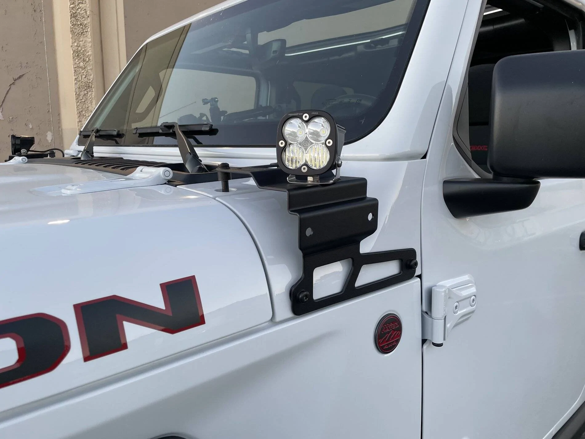

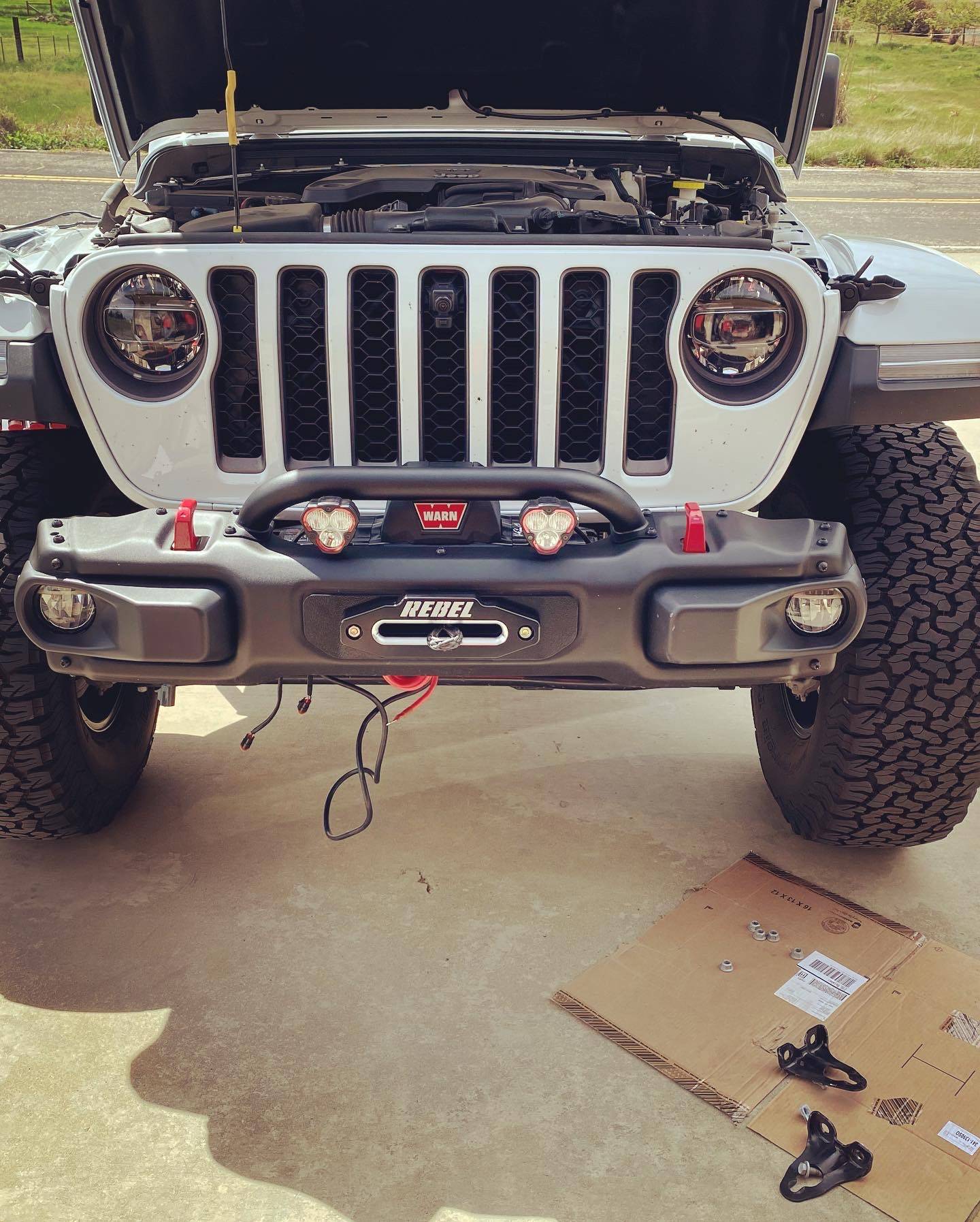

Wiring question: did you use the provided wiring harness, and if so, did you eliminate/remove the switch, relay, fuse/fuse holder?
Yes, removed everything except the wire going to the light and just wired to the OEM harness for the AUX switch
I did similar, but I kept the inline fuse.

Thanks so much for helping me with this project. Hopefully one last question: did you get any static in your radio when you turn on your pillar lights, and if so, how did you correct it?
Arisdocjk
Aris
Aug 18, 2021
264
419
Shreveport, Louisiana
2021 gladiator Mojave
Optometrist
No static, I would check your ground wire and make sure nothing is loose.

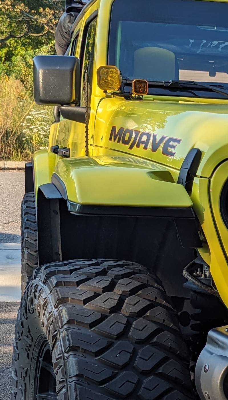

I like my Mopar lights and brackets. Have had them for 3 years. They’ve held up well and give good light.
I've never seen any mounted off to the side like this. I like the idea for visibility sake. How's the noise? Any issues with door opening or anything else?
