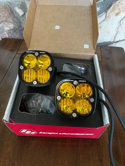

Whats going on Jeep fam!
I recently installed the Baja Designs Squadron sport lights on the A pillars and i just wanted to share with you guys how i went by installing them, hoping i can save yall the headache and some money. After replacing my bumper with a steal stubby from VKS Fab, i no longer was going to have fog lights. So i went ahead and use the factory harness of the fog lights and wired them to the new lights, that way i can use the oem fog light switch. (In case youre wondering my truck did NOT come with the Auxilary switch panel)
I apologized in advance for the picture quality, i have an iphone 13 but i had to upload the pics in a smaller size.
https://www.4wheelparts.com/p/baja-...combo-led-lights-amber-557813/_/R-FGXX-557813
(heres the link to the lights i bought)

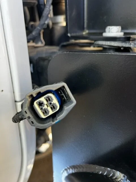

This is the plug coming from the truck.

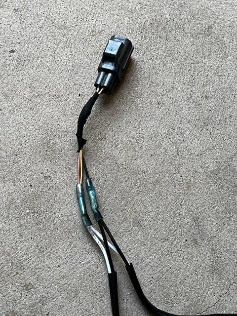

Heres what it looks like from behind

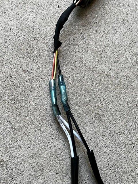

I spliced and used these butt connectors to wire them together. after the heatshrink i wrapped them up with electrical tape.
Both of the white wires from the lights are wired to bothe the white wires that are tied into the harness that came off the bumper.

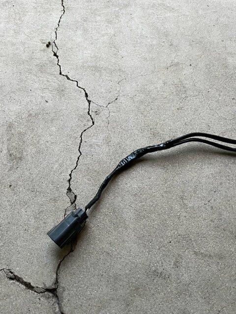

Here is what it looked like after i was done. i dont know if itll help yall but I followed this video on youtube for installation.
