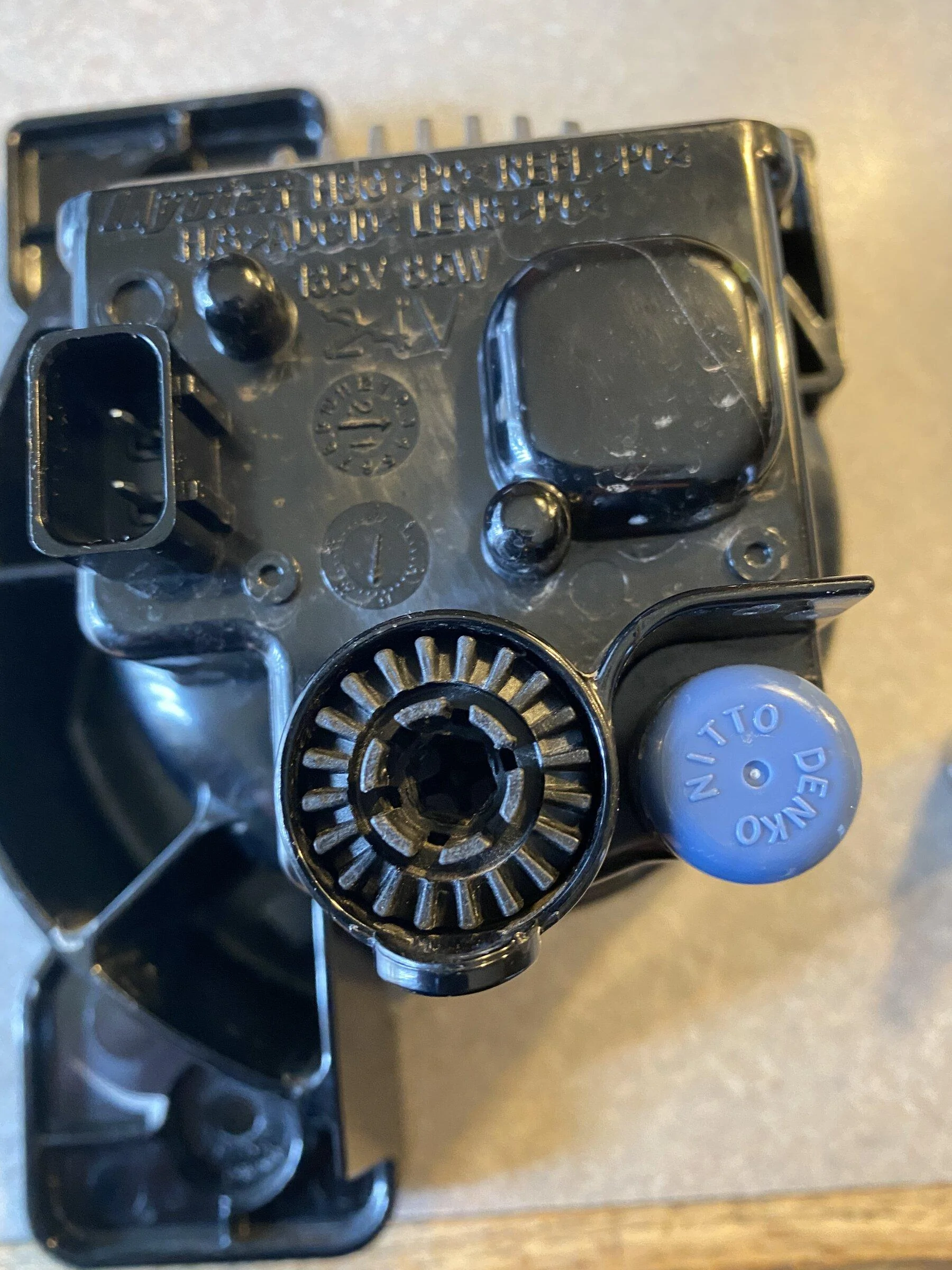

Ok so I ordered a new Mopar LED for the right front. Programmed for LED with a Tazer; and it appears the lights are now working. I’m not sure why only one fog light would have burned out; maybe the right front was defective from factory. The new light (mopar 6830 4048 AF-001) is slightly different from the one that it replaced. The original fog lamp had a blue attachment on the rear labeled “NITTO DENKO”; and I’m not certain what that is; the replacement does not have this. Can anyone illuminate me (pun intended)?
Jeep Gladiator Mopar Halogen Fog Lights to Mopar LED Fog Lights B6EF0CD6-2B20-4DA2-9CE5-EAD063ACF2D4

Moisture vent?
