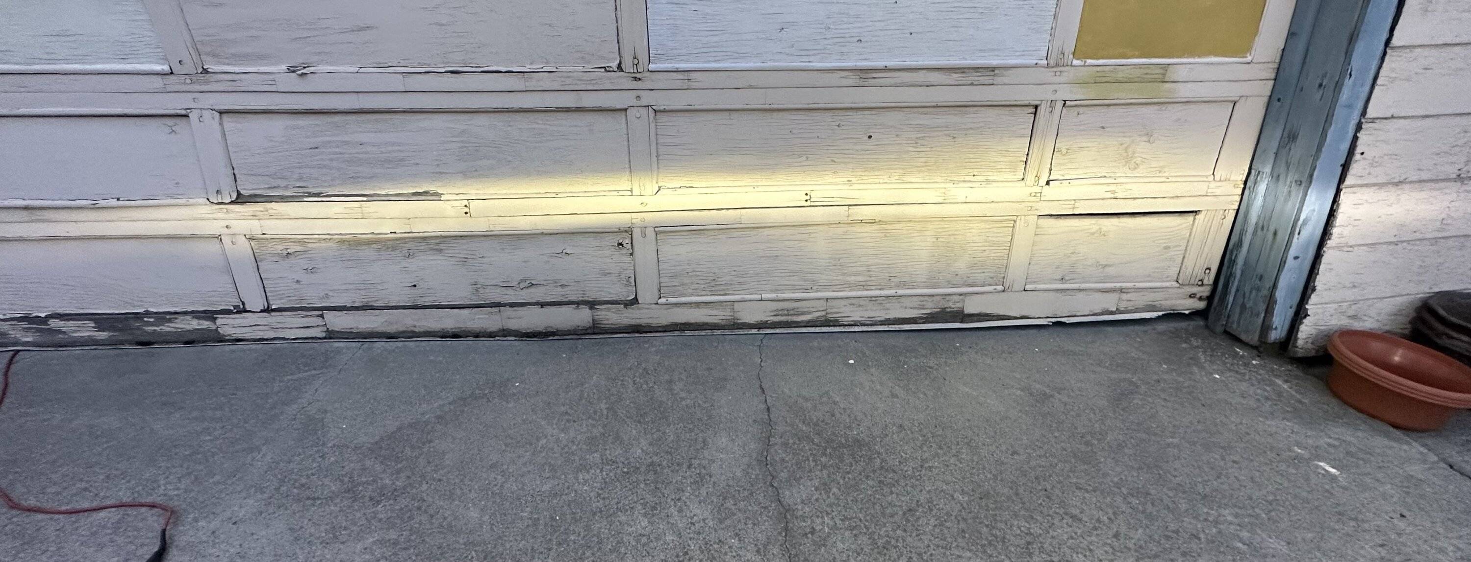

Well…
Jeep Gladiator Halogen vs. LED Fog lights 1688615729434
There is certainly a more focused beam with the LED light.
The illumination to the side looks to be slightly less.
I’ll reserve final judgment until I get them both installed and go out for a drive.

Let's see them. What are the bulbs and post up some output pictures of them with OEM LEDs side by side. Or even side by side with the halogens.
The picture above shows the OEM LED (left) vs. halogen with LED bulb (right.)
I don't have a picture comparing the halogen vs. LED in the halogen light, but the beam pattern was a bit better with the LED bulbs (you'll have to take my word for it.)

I installed LED bulbs in the fog lights, and got the results seen above.
I had LED bulbs in the headlights, and had no issues with being flashed.
If the light source of the LED bulb is in the same location as the light source for the incandescent bulb, the difference in beam pattern will be negligible.
I will admit that the beam pattern was improved when I went to true LED headlights.
