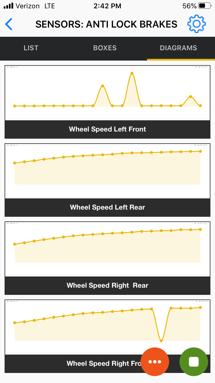

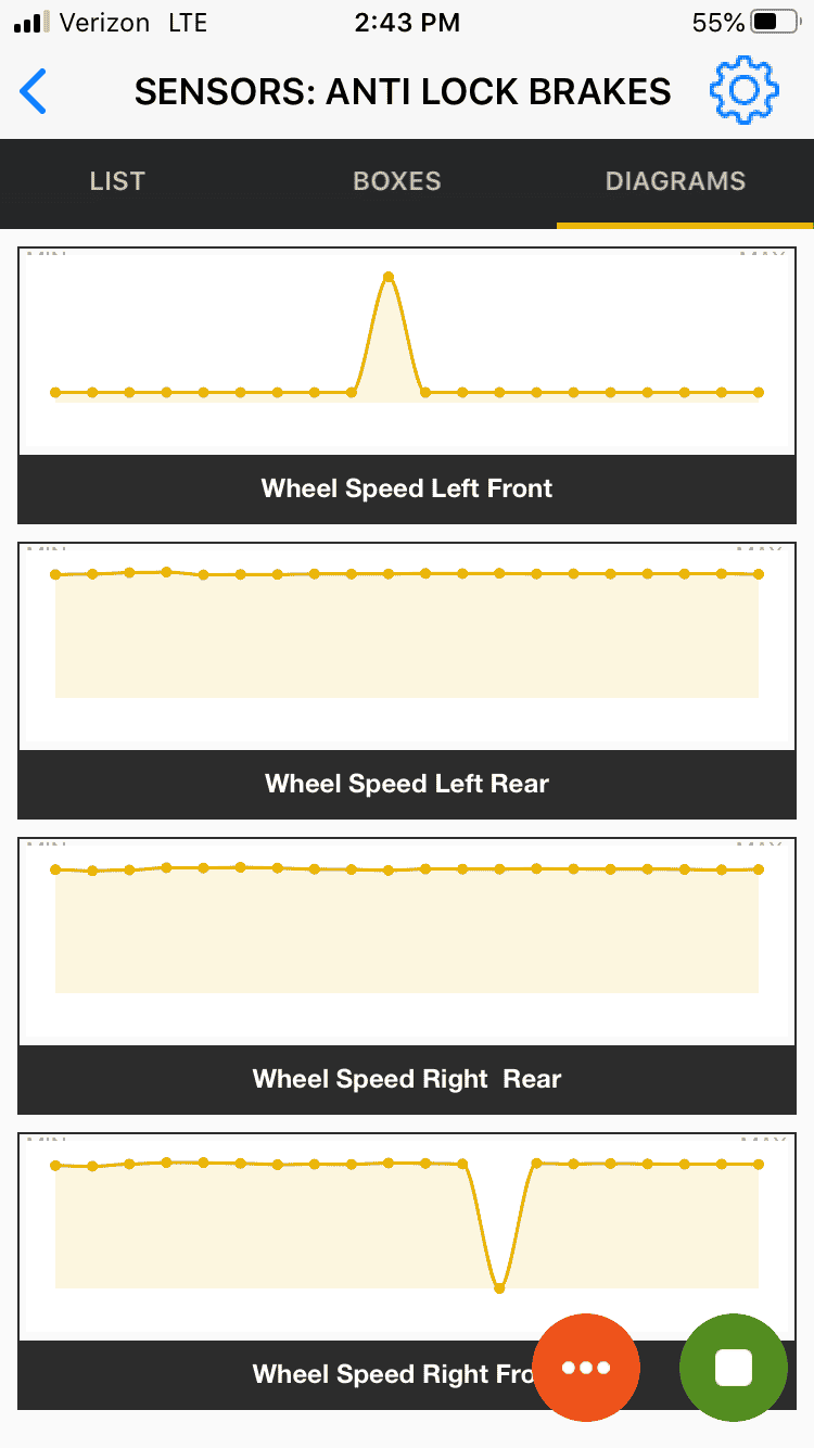

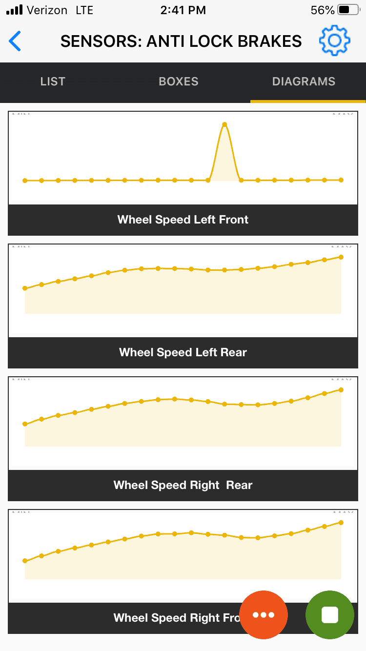

Well I put the factory wheels and tires back on with the oem TPMS, put the wheels size back to factory with JScan. Didn’t help. I did do another test of my wheels speed sensors, this time using the diagram function and my wife watching while I drive. Might have found an issue. Occasionally two of the wheels would dip out. I only had her take screen shots when I was driving straight at a constant speed. This doesn’t seem normal, but I also have never done this before.

Happy to report that I finally was able to get the JT into a dealership and it was as simple as re-flashing the system.
