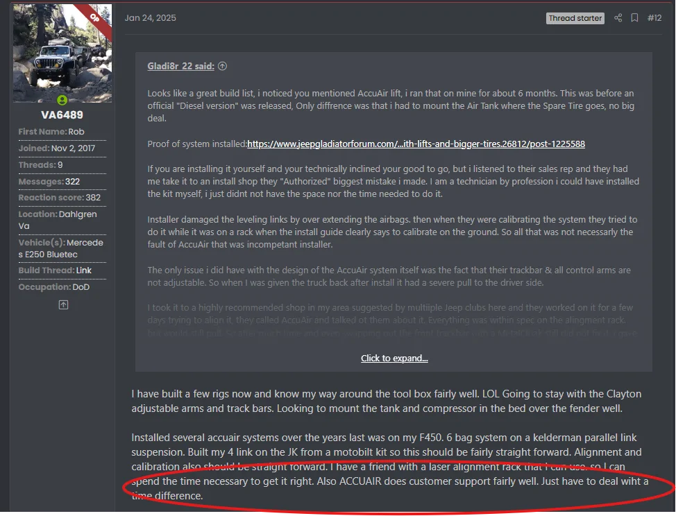

You system has much room for improvment. the soft bushing in the control arms needs to be of a much stronger material. The right height sensors could be tighter in tollerance. Track bar bushing material is ok for a stock rig on the street but with wheel and tires the loads those bushing and causes drivability issues.
The "kit " was install by your supplied directions and found to be less than desirable. Off road the sensors when out of range with the kit as designed..... Hence the upgrades to Johnny joint control arm end, thicker less flexy control arms and track bars.
Empty the rear springs are ok, shock dampening is too weak to control the pogoing and with a load of 500# the rig is a handful to drive with you supplied kit. the modification to your kit greatly improved the street manners but in the end with a RTT rack and Fridge the loading was too much to wheel with and the off road response was all over the place.
I offered constructive feedback only to be met with blame for changing your design. the design is in adequate for anyone more than a casual off roader.
The $7500 experiment failed to live up to my expectations. The worst part is the interaction with your staff to try to resolve issues. That is the real issue Product support. You have my number be happy to carry this conversation on further.
