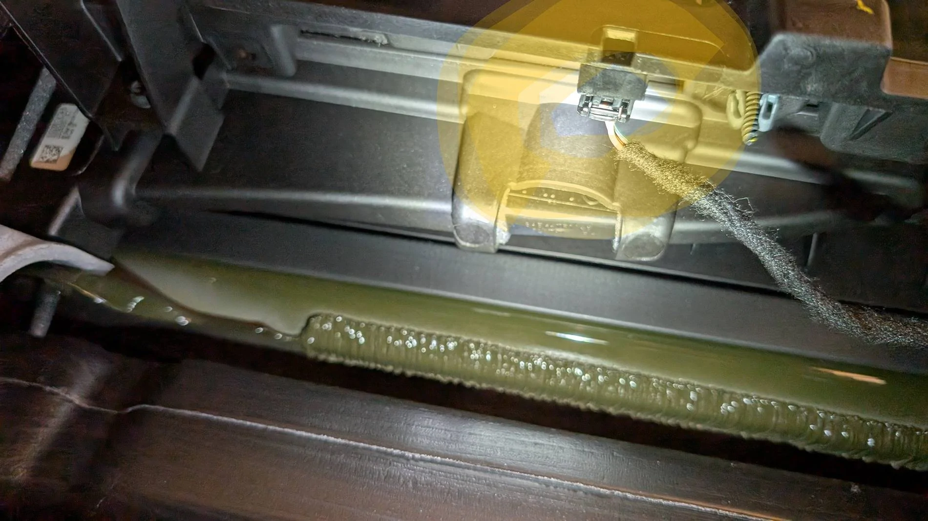

Update: It works!
Ordered compass module 68264745AA. Pulled the passenger side airbag. The harness plug for the compass module was present and just plugged into nothing.
Jeep Gladiator Adding Compass Module 1000007661
The compass module mounted up right next to that plug (there are bolt holes present).
Jeep Gladiator Adding Compass Module 1000007644
Reassembled the dash. Now I get compass readings on my instrument cluster even though I have an aftermarket head unit.
It *is* off by about 90 degrees at the moment. I'm thinking calibrating it will resolve that.
