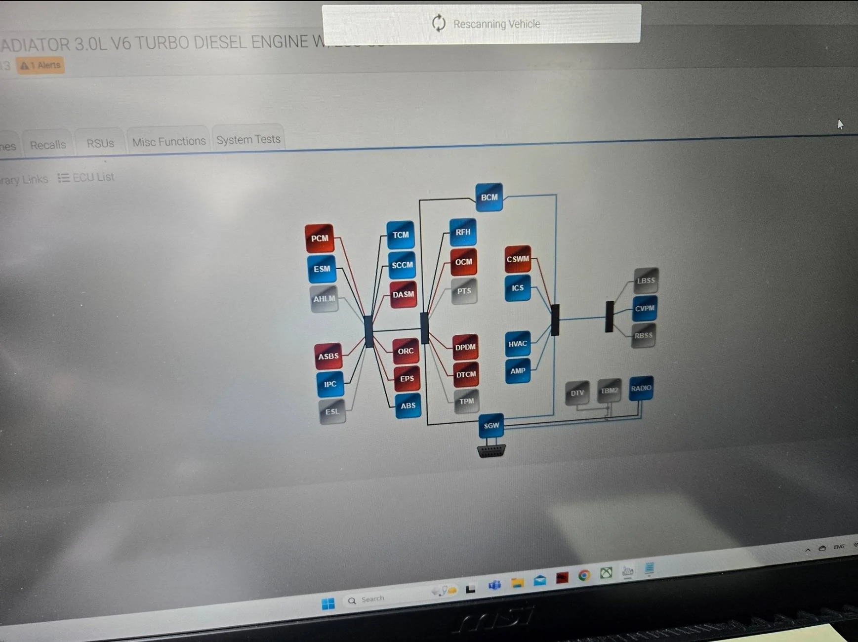

Witech is the software you can purchase as a subscription monthly and also per VIN number per month. Dealers get access and you can purchase the subscription as a independent shop. They call this aftermarket subscription.
Once the subscription is purchased you need J2534 connector and an Internet connected notebook running Windows.
Witech is web based software so if you lose Internet connection, you lose ability to connect to the vehicle.
The purchasing of the subscription and activating the account is rather cryptic but there is information out there to get that done.
When all the software and hardware are setup, when you connect to vehicle, it will check for VIN and get vehicle configuration from their database/sales code.
So if you have modified anything after sales and flashing stuff just based on sales code, you may even lose features added.
Prior to flashing any ECU, the software prompts you a warning that you are doing this at a risk that it can cause further damage if the ECU and configuration is not matched.
Someone mentioned already, reflashing ECU is not like an incremental update on iOS or Android that they are developing to improve quality of the product. It is written to fix very specific issues that became apparent that are present on "some" vehicles so it is not beneficial to just flash them unless you have problems that you are specifically after.
Jeep Gladiator Module software updates at home 20241025_164707
Jeep Gladiator Module software updates at home 20241025_164239
Jeep Gladiator Module software updates at home 1000037504
I have played around with Witech a little bit for me to install the ACC on my Gladiator and to fix issues on my Ram.
I have to agree someone above reporting a ECU person was saying how bad Chrysler ECUs are with issues. I am partial to Jeep and it's family of products but I have never seen ECU so fragile and loses it's configurations with a battery change. It is quite pathetic.
