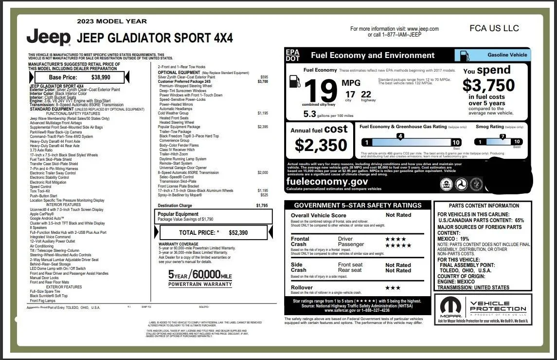

I have a Sport, bare bones, no Sirius/xm,
does have 2 sun visors.

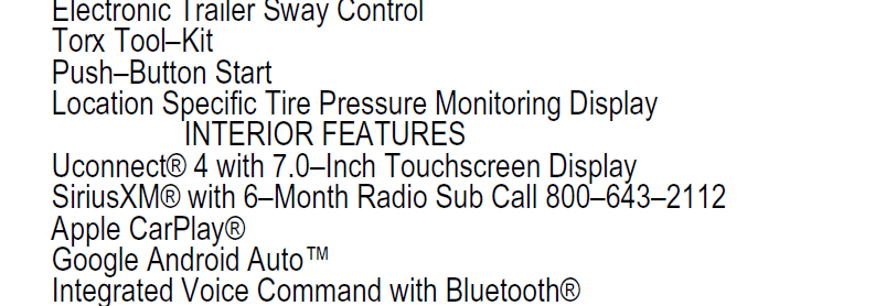

I have a '21 with the same radio. Look at your window sticker to see if its set up for Sirius.
If you don't have the window sticker, I believe you can get it if you copy or paste your VIN to the end of this link after the "=" .........
https://www.jeep.com/hostd/windowsticker/getWindowStickerPdf.do?vin=
not on the sticker
not on the sticker
Interesting. Didn't know it was possible to get the 7" screen without SiriusXM. That said, though, he says he has a Max Tow. With all the other options Max Tow forces you to get as well (or at least used to), I'm still a little skeptical that he doesn't have it.

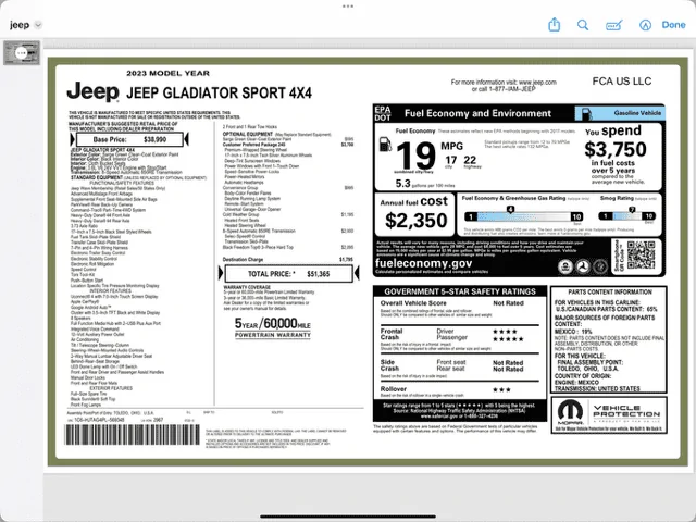

My 2023 Sport with 7" also did NOT come with SiriusXM
Jeep Gladiator Adding SiriusXm 1 - 2023 Jeep Gladiator Window Sticker - Redacted Info.02

Thanks for the replies. I have the sticker and there is no mention of Sirius and it doesn’t appear as an option on the radio page of the touch screen. There are options to retrofit but the easiest ones appear to need a satellite plug on the back of the radio. I just don’t know if this radio has that plug and haven’t had time to refer to the first reply link (dealing with a lift and tires first).
Again, all comments and experience appreciated.
