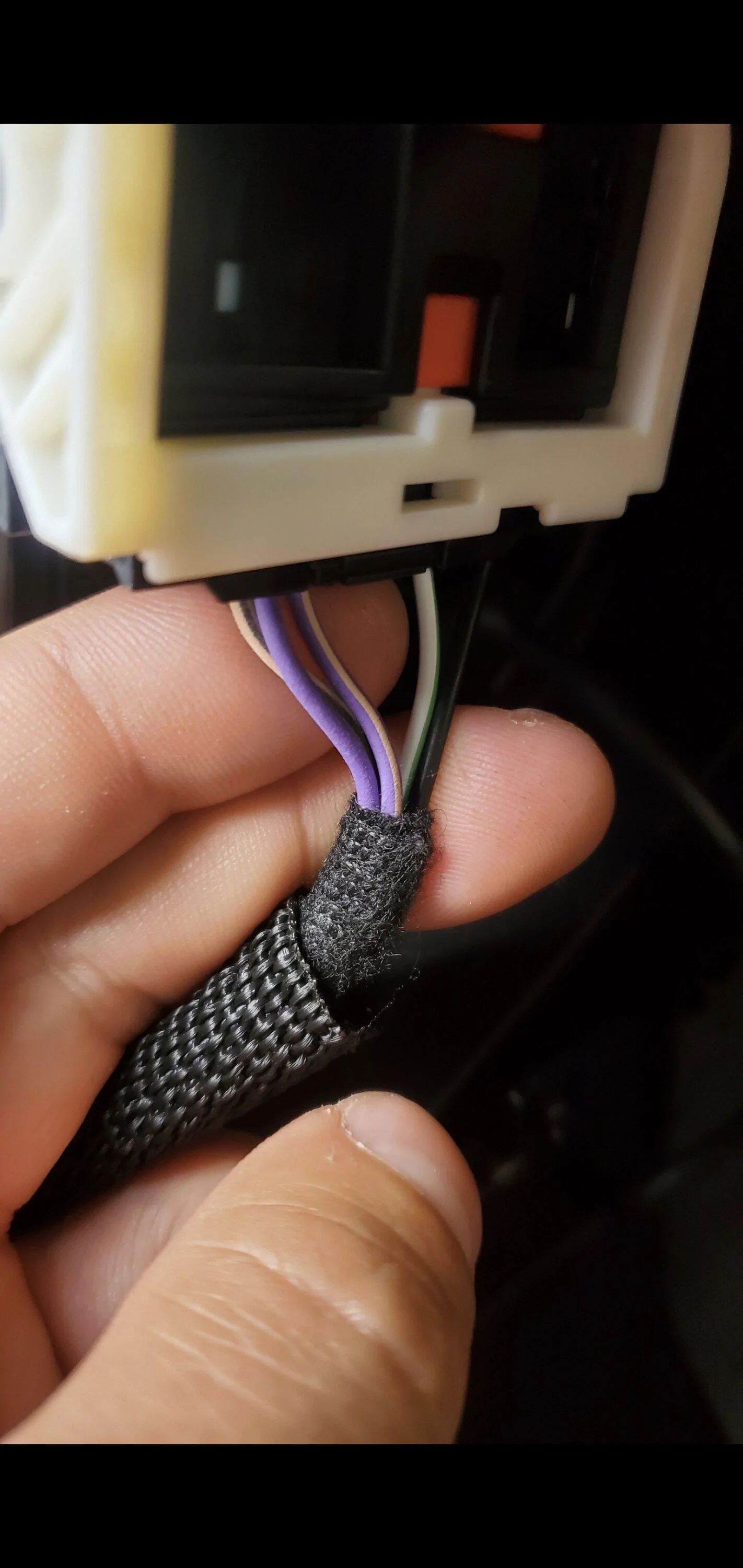

I'm working through this slowly and am confused on a couple things. I'm also working on a new spreadsheet to consolidate all of the wiring additions, pins, wires (with lengths) and Mopar parts needed in one file. Yeah... OCD.
The front doors have jumpers listed but the rears do not. Where do these jumpers go in the front? Are they used to "jump" from the body side, through the door strap/loom and into the door or are they used somewhere else?
My 2023 only has 2 wires in the rear door wiring that goes through the door strap/loom but all wires are present in the body side connector. Will only the door wiring (part numbers 68312445AG and 68312444AG) suffice for the rear wiring? Plus the latches of course.

I'd be interested in a copy of the spreadsheet, if your willing to share it.
if its the mopar jumpers, they will attach to the door harness for the switch, light, and mirror controls.
Yes. how may wires do you have in the xy600 connector? if its like mine, this is where the majority of the work will be (xy600, xy650, 315 & 313)
