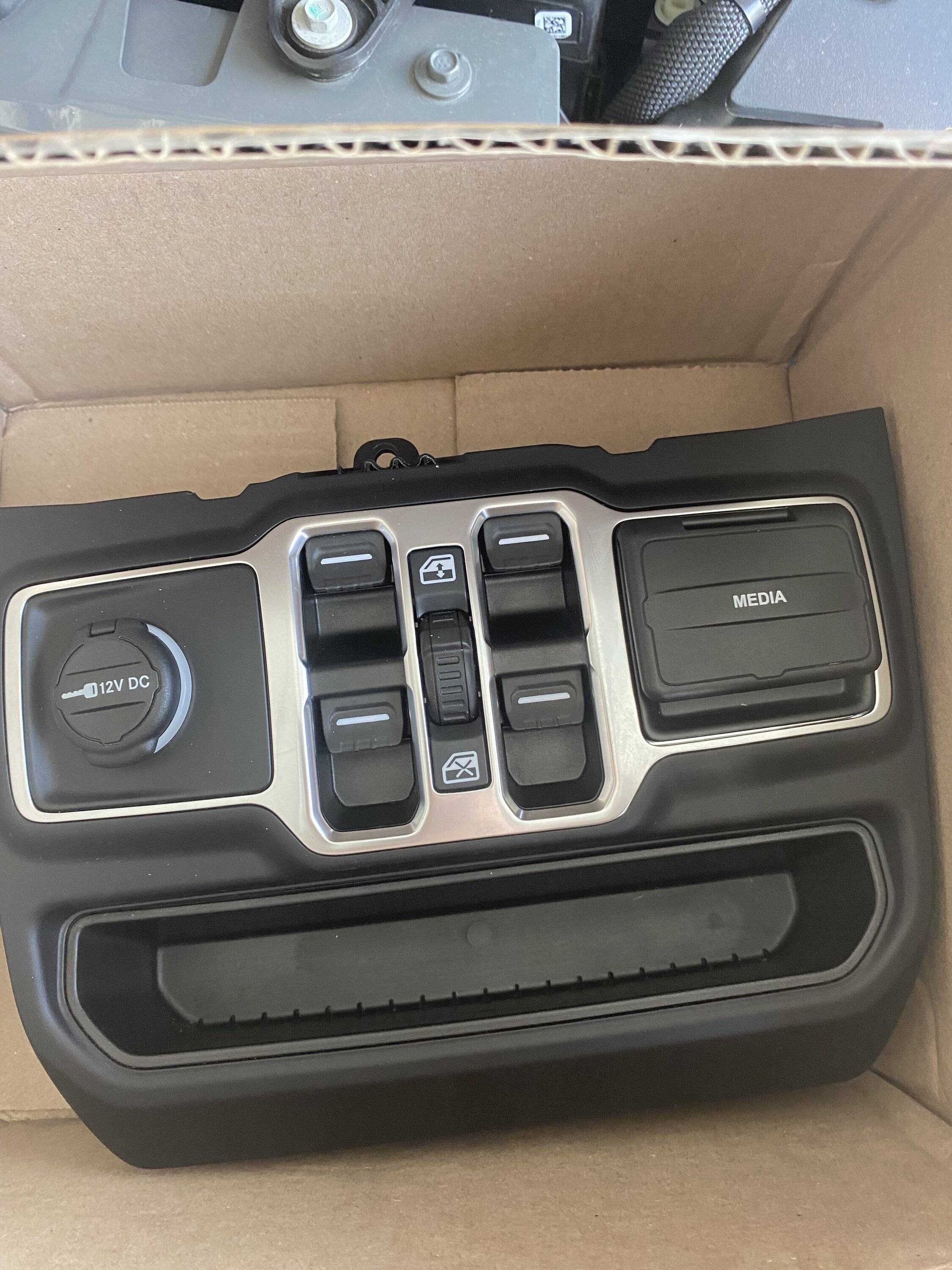

Just got the dash switch for the windows today from ebay. $50, couldn’t pass it up
Jeep Gladiator Adding Power Locks to a Sport - Success ! IMG_0723

You da man, thank you
