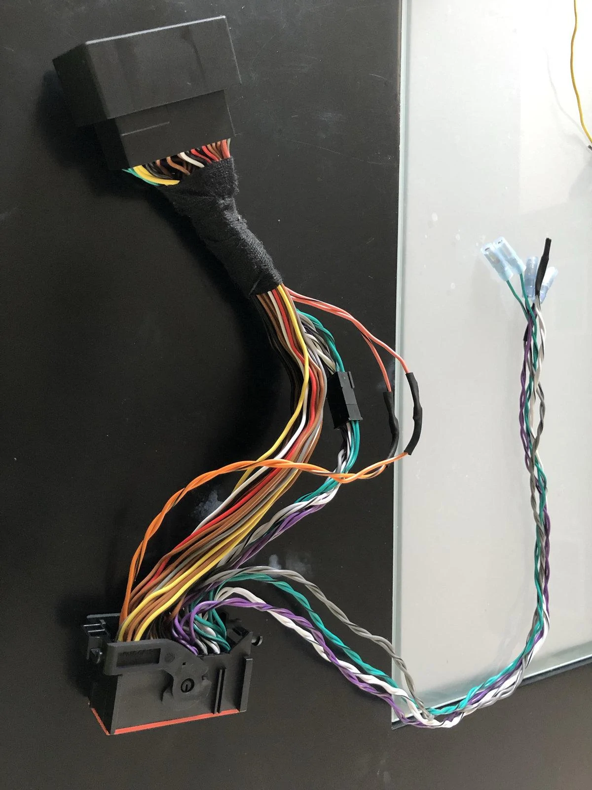

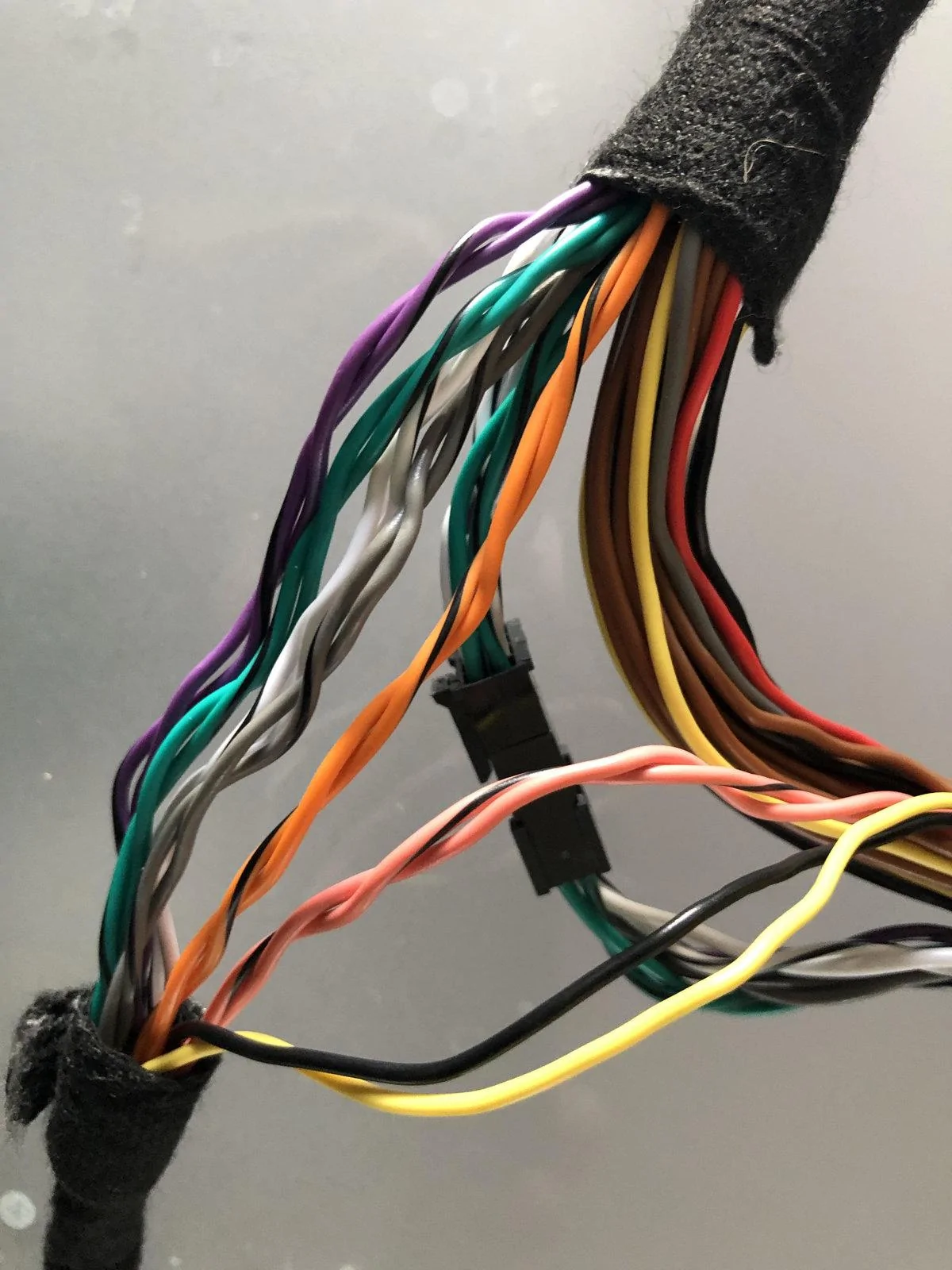

Remove the tape on the PAC harness (this harness installs in-between your factory headunit and the factory 52-pin connector. The pink and orange wires are the CANbus lines. The yellow and black (on the bottom of the picture) are the power and ground for the PAC unit.
Jeep Gladiator Adding Subwoofer and PAC Hack unnamed (3)
Connect the orange and pink CANbus wires together. Match up the solid pink wire to the solid orange wire and the striped pink wire to striped orange wire.
Tape off the yellow and black wires (power and ground for the PAC device).
Now, you have all four factory wires to send to an amp, sub, or line-converter. And, the factory speakers still work too!
Purple wire - Right Rear Speaker
Grey wire - Right Front Speaker
White wire - Left Front Speaker
Green wire - Left Rear Speaker
The striped wire is the negative line, solid color is positive.
Jeep Gladiator Adding Subwoofer and PAC Hack unnamed (4)
I powered my sub using one the AUX switches and grounded it to a rear seat bolt.
I ended up with a really expensive wire harness, but I have an unused PAC control module if anyone wants it. Wires not included! :)
Enjoy.
