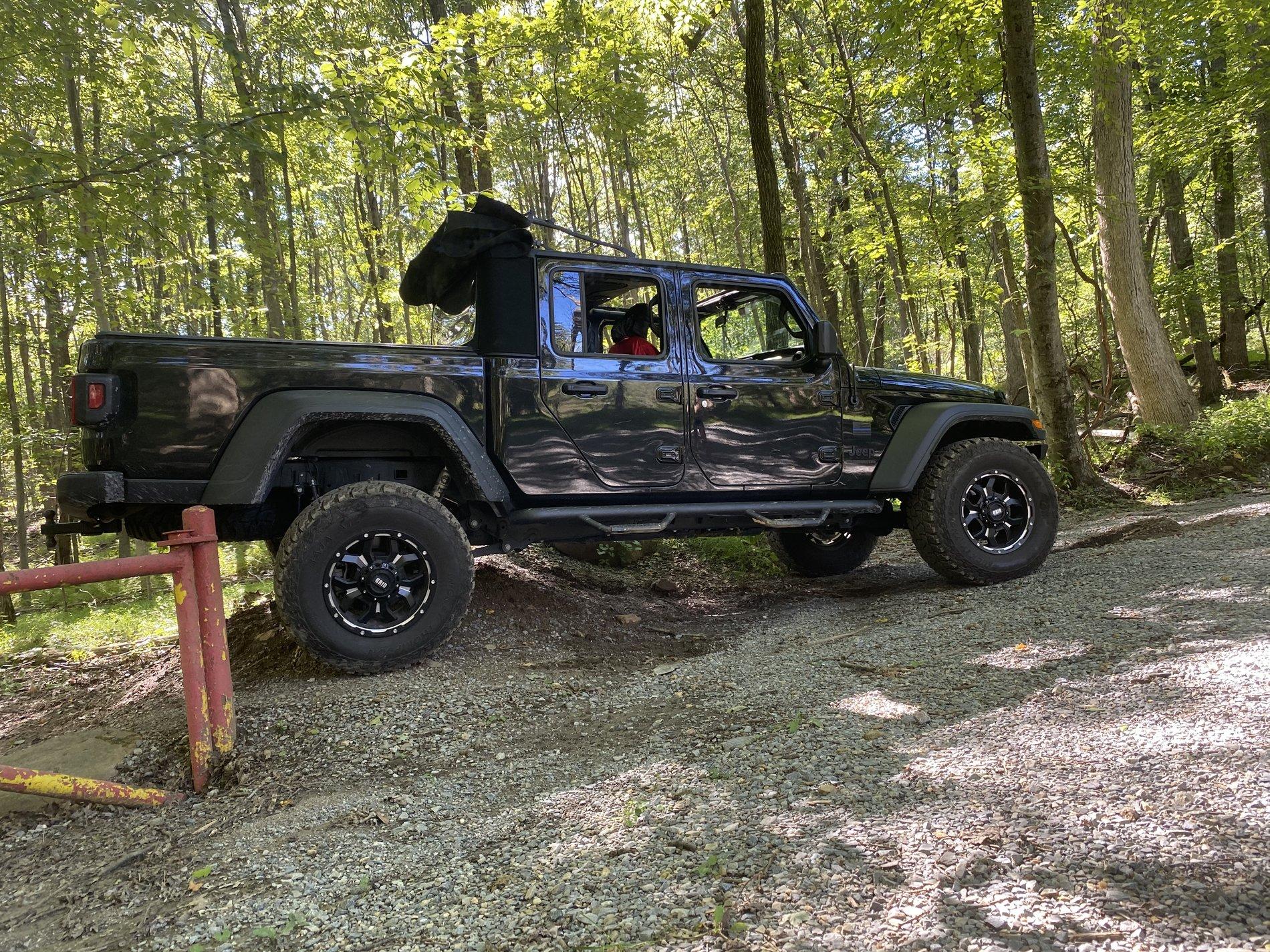

I have a Gladiator Sport Max Tow with the Fox Shocks 2.5 lift on 35 Bajas. Obviously the ride is a little stiff. I plan on going out to Death Valley soon.
I was wondering what y’all thought about swapping the Fox Shocks for Falcon adjustable Shocks. Should it help with the all around ride of the Jeep as well as when I take it to the doons?
Can I replace only the front or only the rear? Would that help/save on cost?
Thanks!
