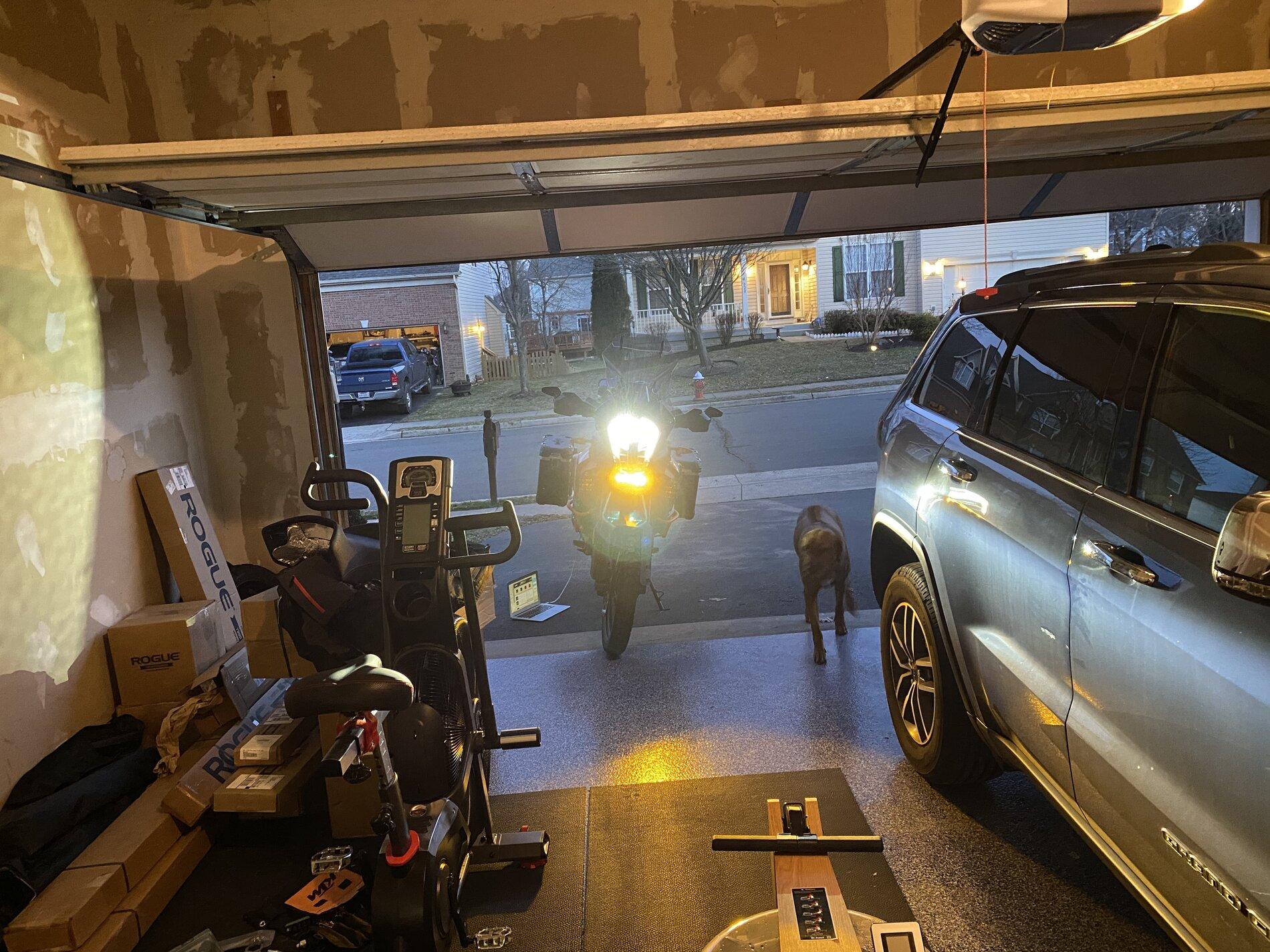

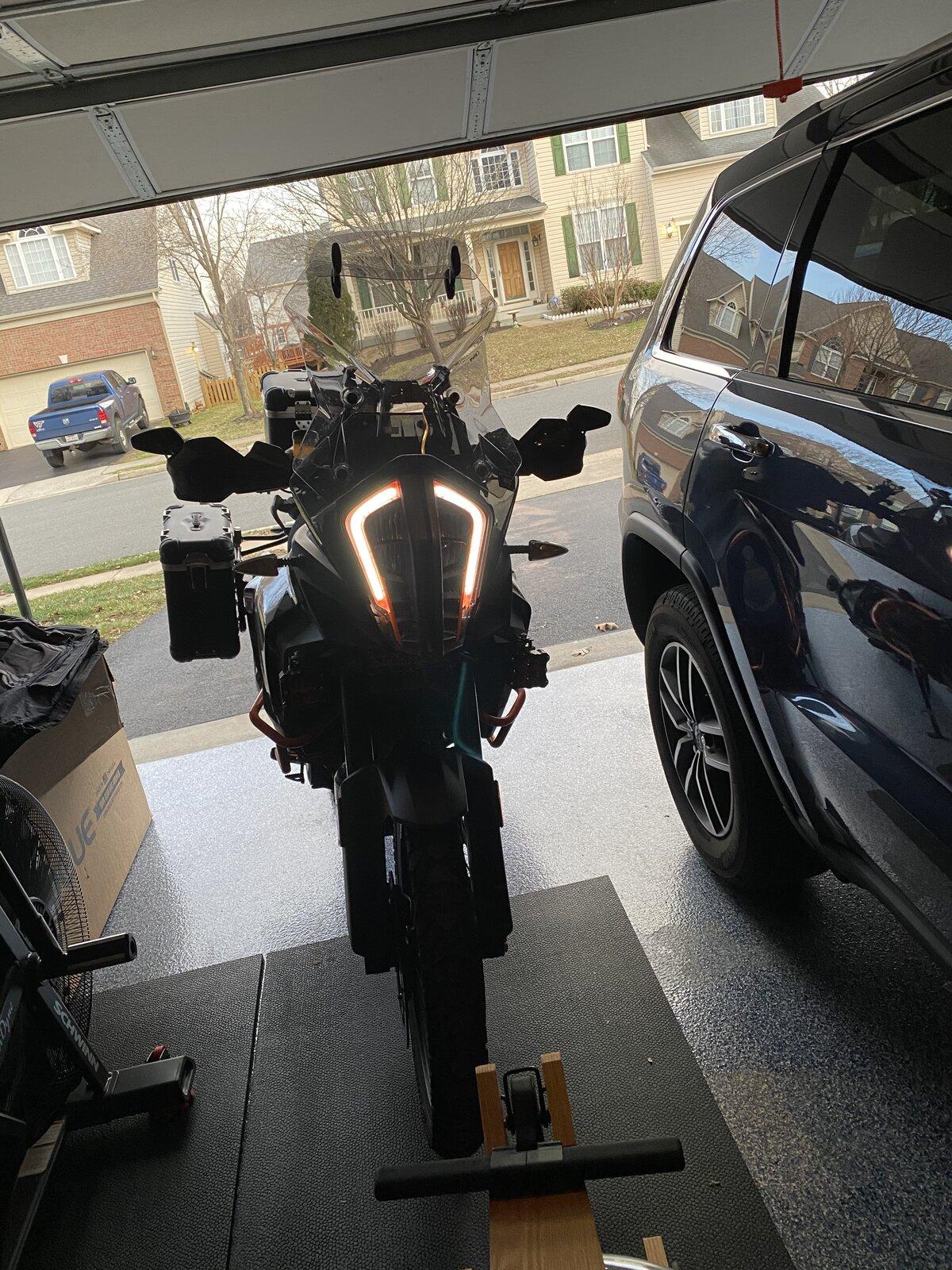

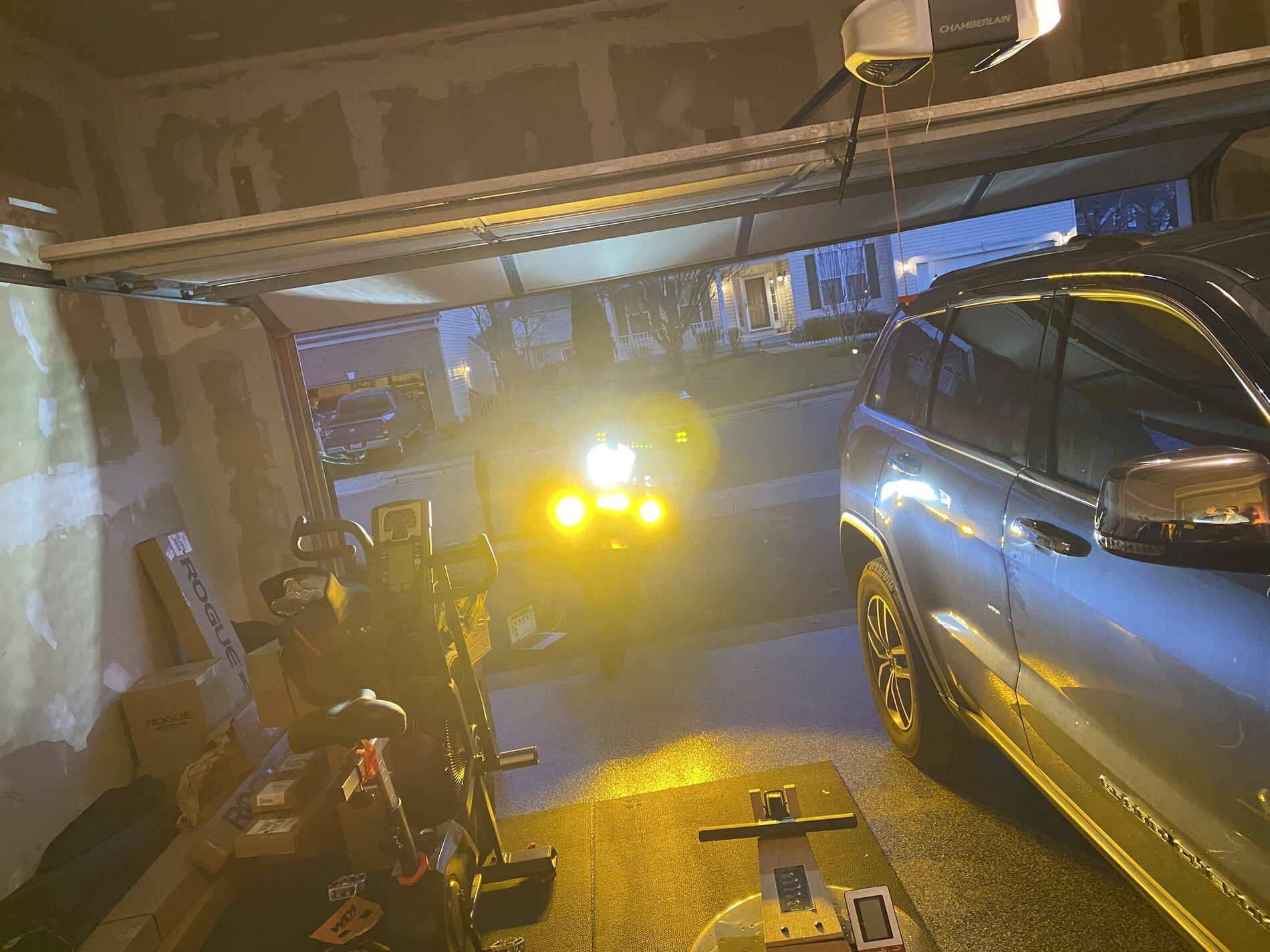

on my motorbike my HereticStudio light bar is set up with a fog/flood pattern and my HS pods on a spot/driving pattern. i wired them up into a CANBus controller so daytime = zero aux lights; night time low beam = spot pods 0%, fog lightbar at 20%. Any time the highbeam switch is hit, the sun comes on.
its fucking rad.
