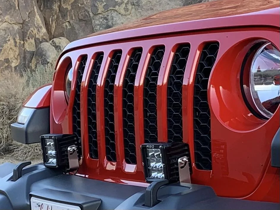

I ran Rigid Dually XL floods on MOPAR light brackets for a while. These were wired to the factory Aux 3 switch. All in all, the setup worked well and looked clean. They were great when I was running the factory halogen headlights. After upgrading to the factory LED headlights, they are less impressive. If you're running the factory halogens, in my opinion, your money is better spent upgrading the headlights first. I was blown away by the difference.
