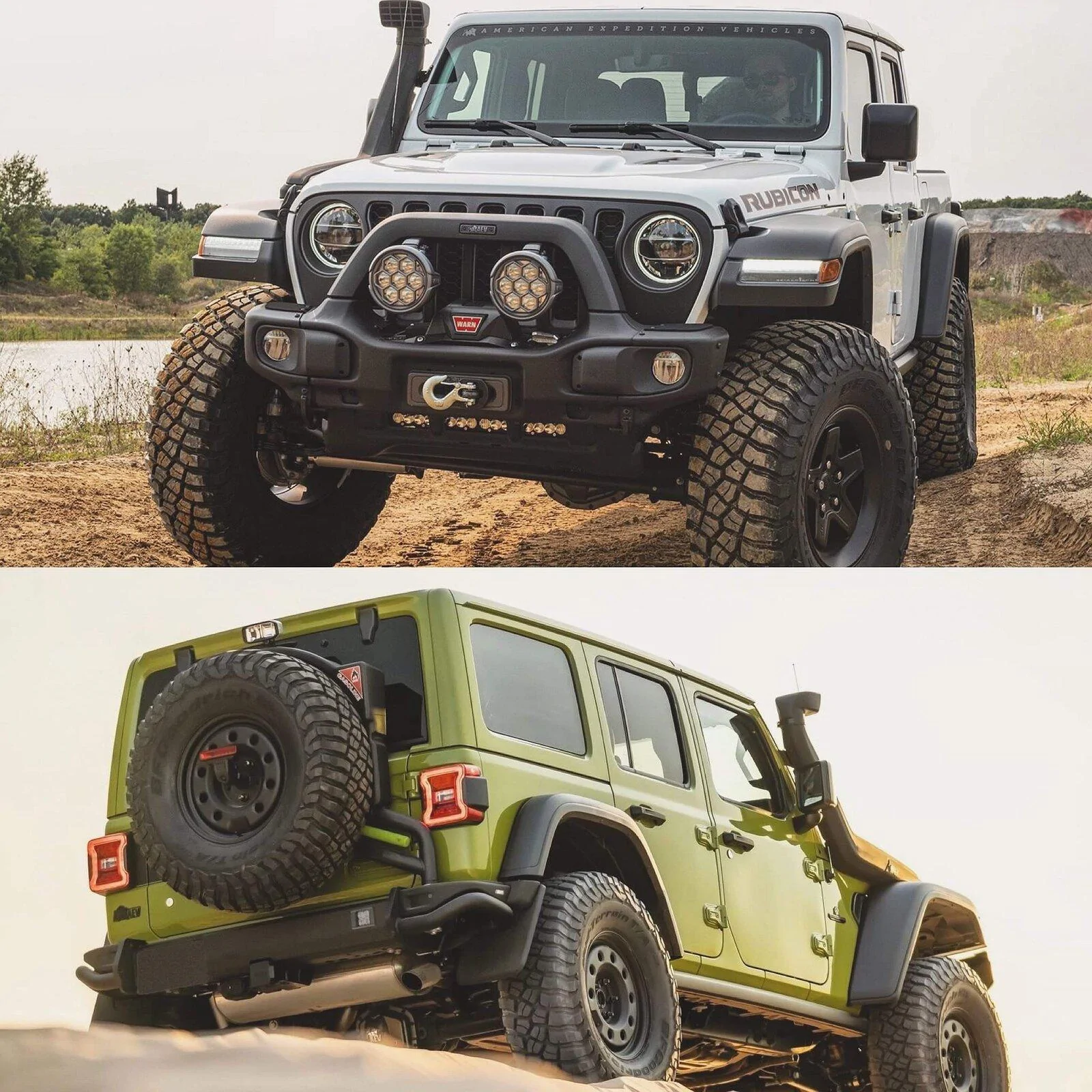

Spotted this AEV Rx with Baja Designs LP6 up at Rubitrax in Boone. This is the first time I have seen another brand of lights mounted to this bumper.
Jeep Gladiator AEV Front Bumper Released For JT Gladiator! 00F91F90-CB49-4076-A190-A7D19BE40B3A
