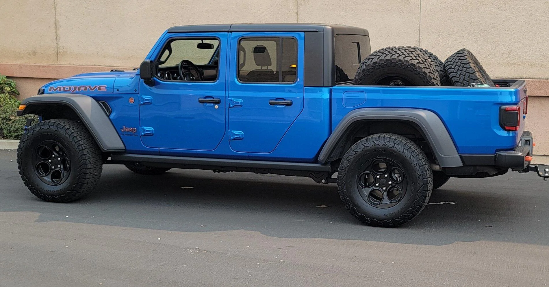

Just installed my lift on my mojave this week. Took way longer than 4 hours as quoted. More like 6-7. Installed correction brackets at the same time. Only one issue with kit. My mojave has different size bolts for the upper sway bar links. Lit includes m12 bolts x 1.75 pitch. Wrong thread pattern for mine. Had to go to true value hardware and get the correct bolts m12 x 1.50 pitch. Attempted to reuse factory bolts and had to clean up the threads.
Jeep Gladiator AEV Mojave Question 20210821_151157

Looks great. Are those 35’s?

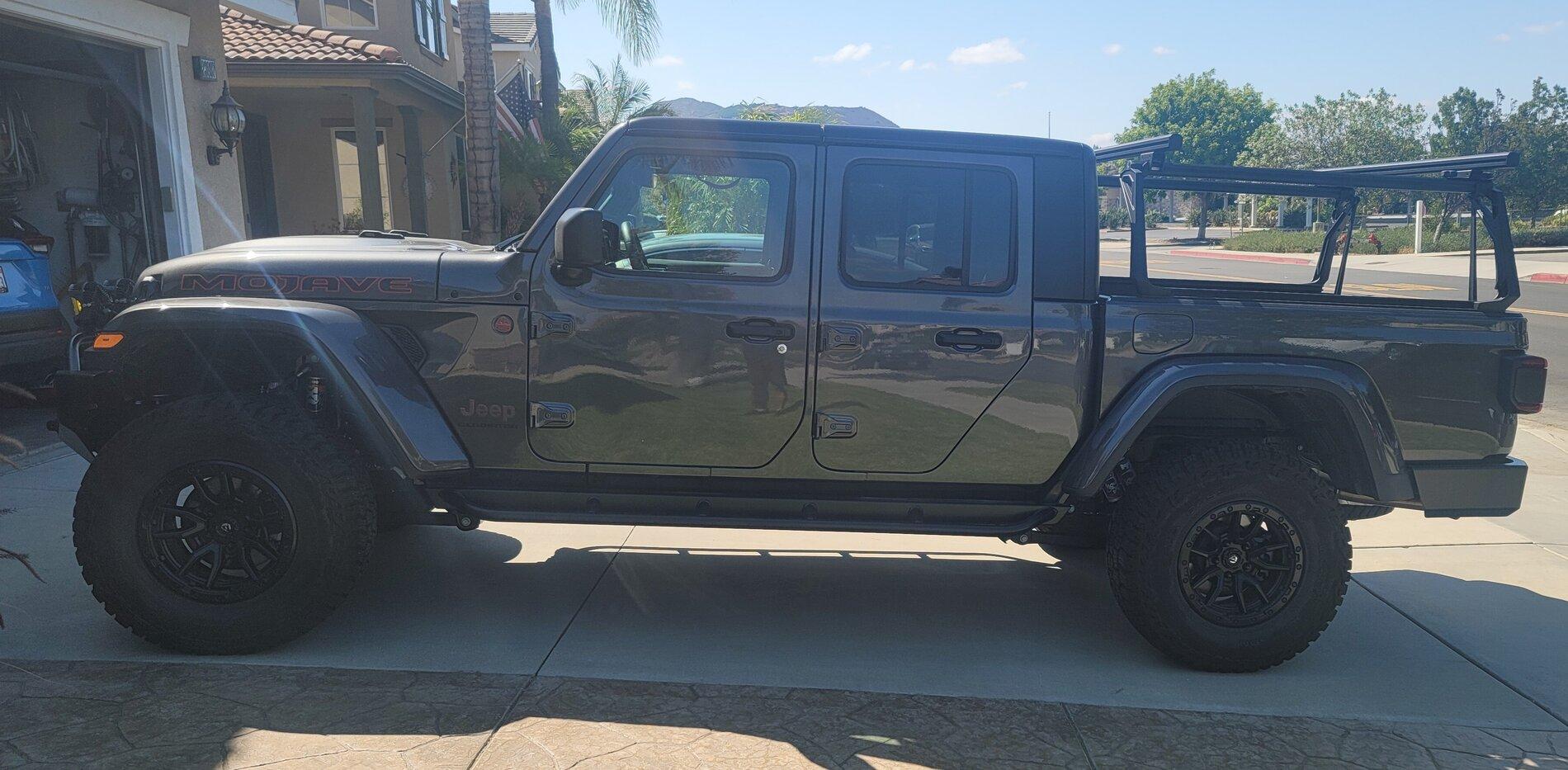

Yes. Mickey thompson baja boss A/T. Handle great offroad and quiet on the pavement
I would have had to wait 2 months for those tires. I ended up with KO2’s. Do you happen to know what the Mickeys actually measure with weight on them? Mine seem so small.
33.6

Wow, ok. That’s about what mine are measuring. Looking at yours tells me to go ahead and use my lift. Thank you so much for answering my question.
