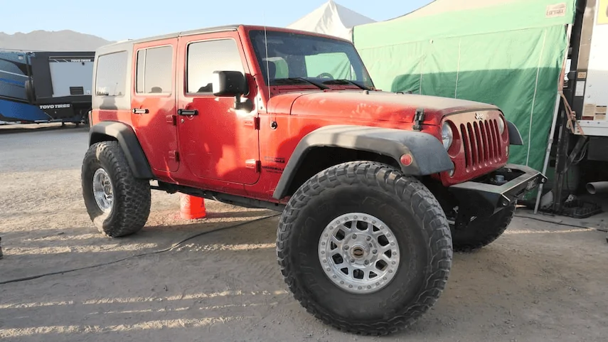

They are cool no doubt. But 5K per corner is steep. I don't see how this is a cost savings.
I have about 4K in lift and shocks plus 2K in my re gear.
Frankly the Jeep in the photo looks like it has ZERO room to flex.

Traditional flex isn’t the benefit here, at least in terms of up travel. For rock crawling, that seems like a great stance. I’d likely add flat fenders, but a big tire and low lift is ideal.

I like, low with big tires and flexy....Just went from 35s to 37s and now chopping those fenders...
Personal preference...

Unnecessary height is definitely a negative but wtf are you gonna do with 2" of uptravel? You will be riding on the bumpstops constantly and they will be trying to push you over while crawling.
I tried running 3.5" of uptravel on my rear ORIs and it was terrible offroad at speed. Constantly hitting the internal bumstops. Im redoing my mounting and will run about 5" at the same ride height.
Im sure with that JK they are just showcasing the additional clearance that the portals give you.
