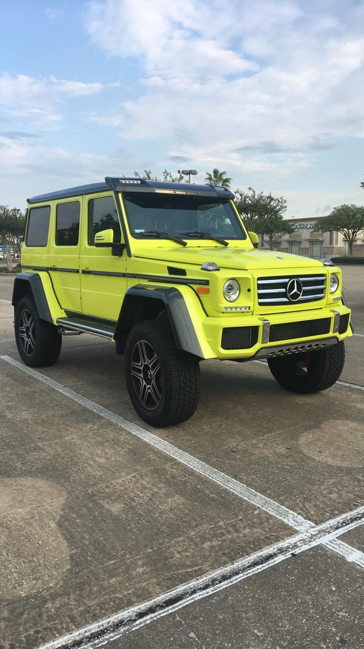

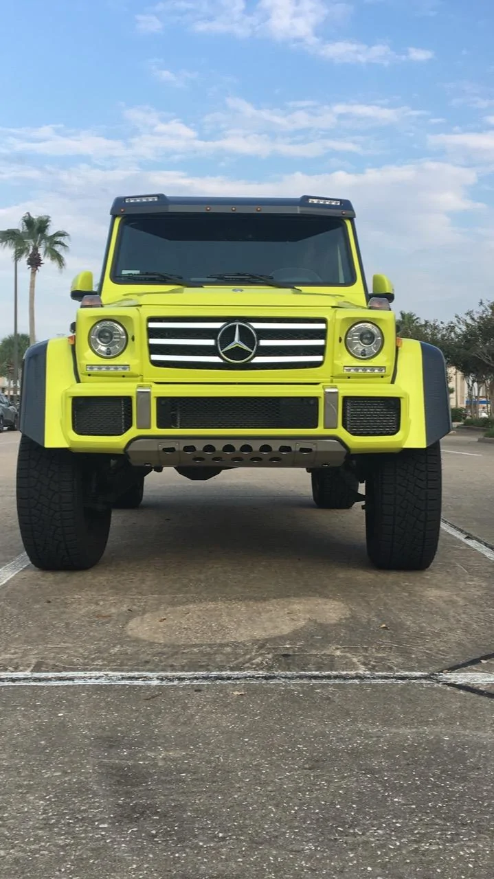

Ghost Rider
https://www.thedrive.com/new-cars/3...the-ludicrous-g550-4x4-rock-crawler-stateside
I saw one of these at my local Mercedes dealer back in ā€˜17 I think.
The first thing I noticed were the dropboxes. Amazing ground clearance. Reminded me of our self propelled swathers!
I saw one too way back in 2017 or 2018. I spoke to the owner too. Let’s just say that thing never saw dirt. Nice guy though.
