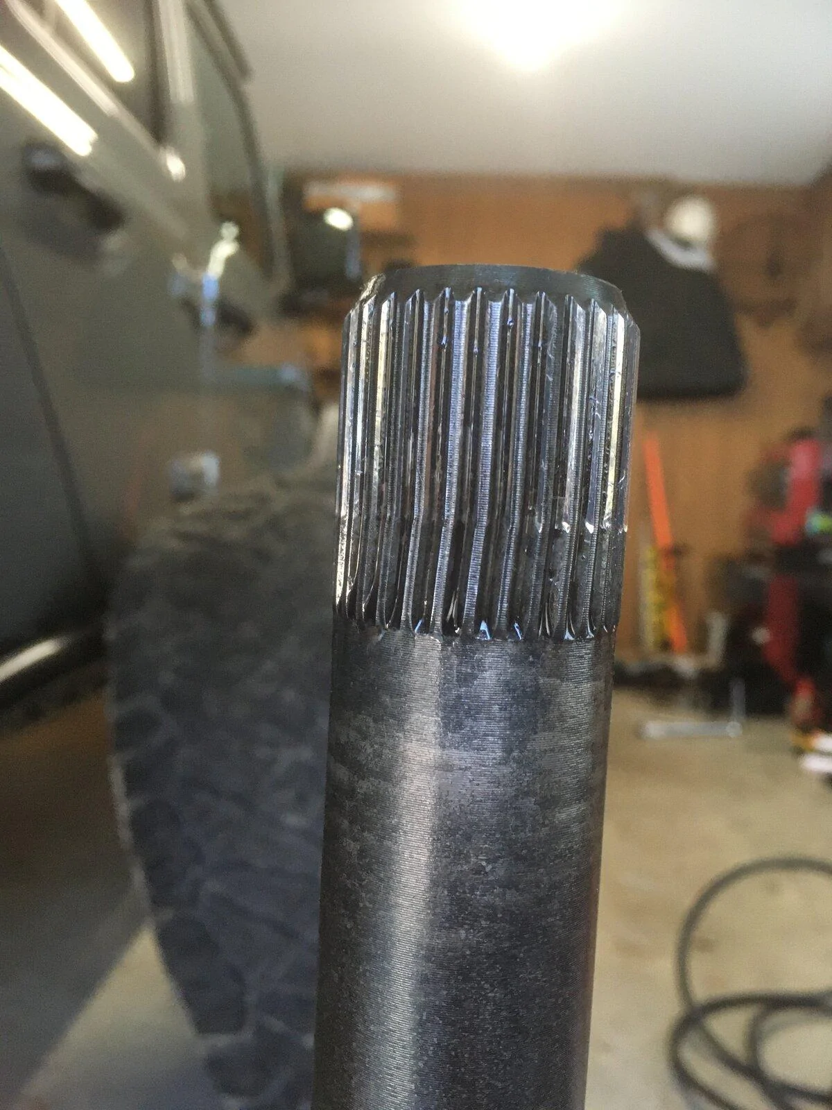

You can bend an axle shaft flange sliding sideways into a large boulder, or break a shaft bouncing while accelerating and climbing. For general off road use with stock-ish tires, stock axles should be fine. When you get up around 37” tires, bending or breaking becomes more common. Replacing stock axle shafts with chromoly shafts is a simple job you can do with a jack, a stand, and hand tools, as long as you get them with the bearings, seals, and tone rings preinstalled. In the photo below, you can see that my axle shaft had twisted, probably from a bounce while climbing an obstacle. That one also had a bent flange.
Ouch, what size tires were you running?
