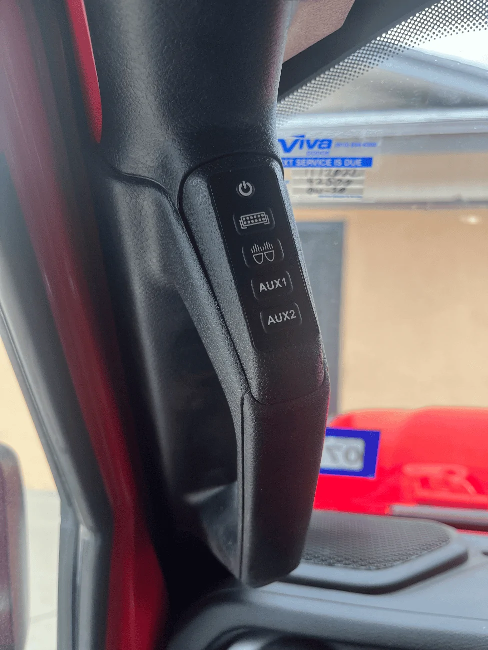

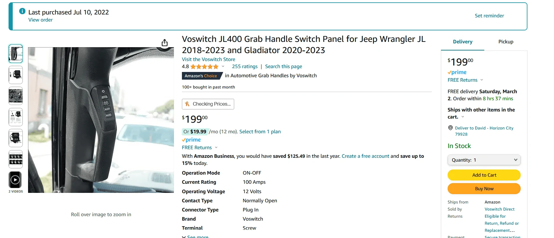

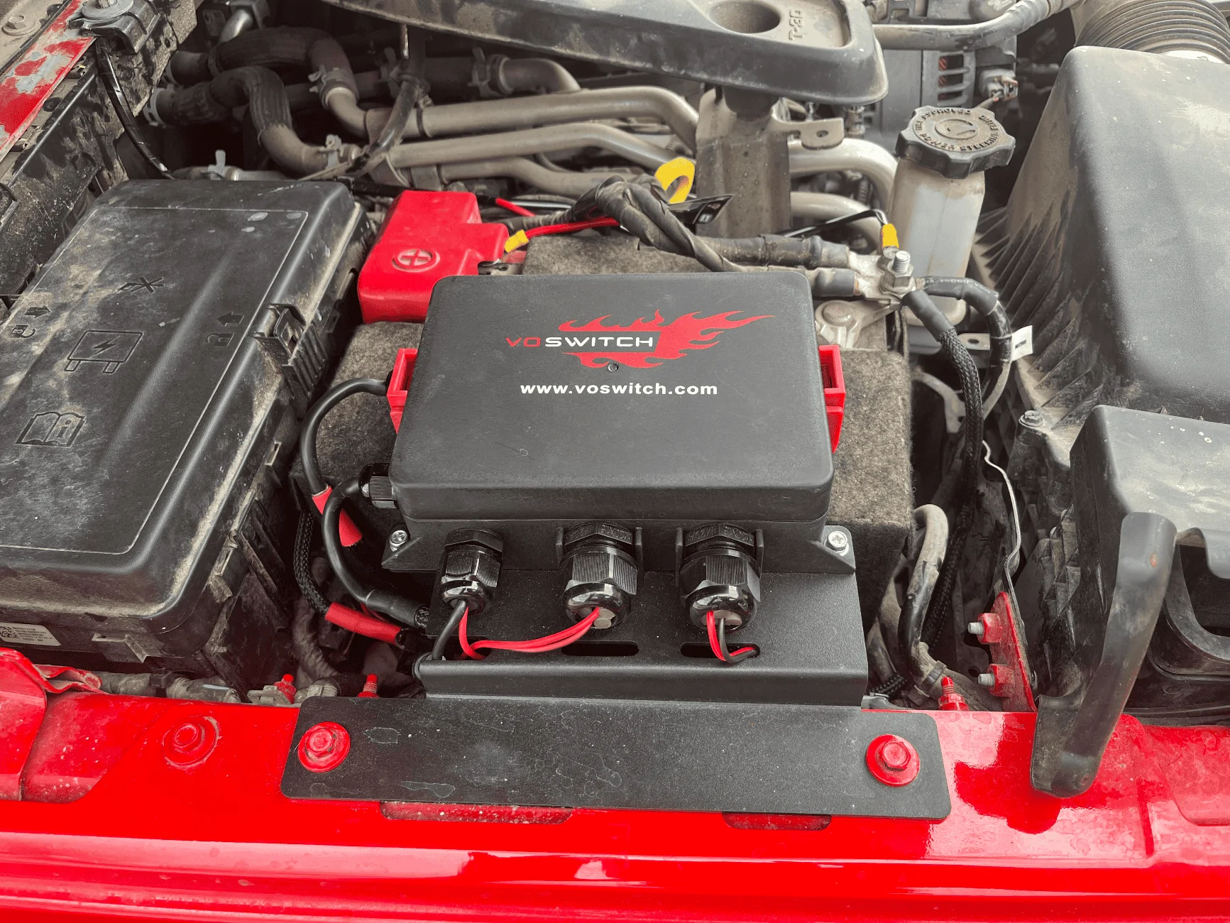

I put in the Voswitch JL400 grab handle switch kit, with power center under the hood, and it works great.
