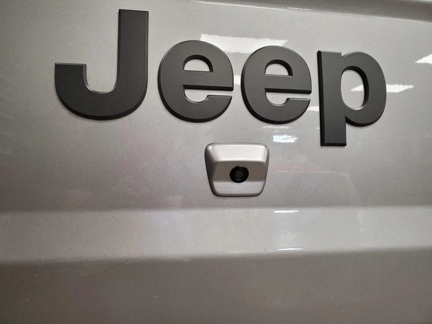

Finally got the backup camera swapped out for a new aftermarket unit. It fit very nicely into the OEM location. While we where adding the back up camera we added remote start as well.

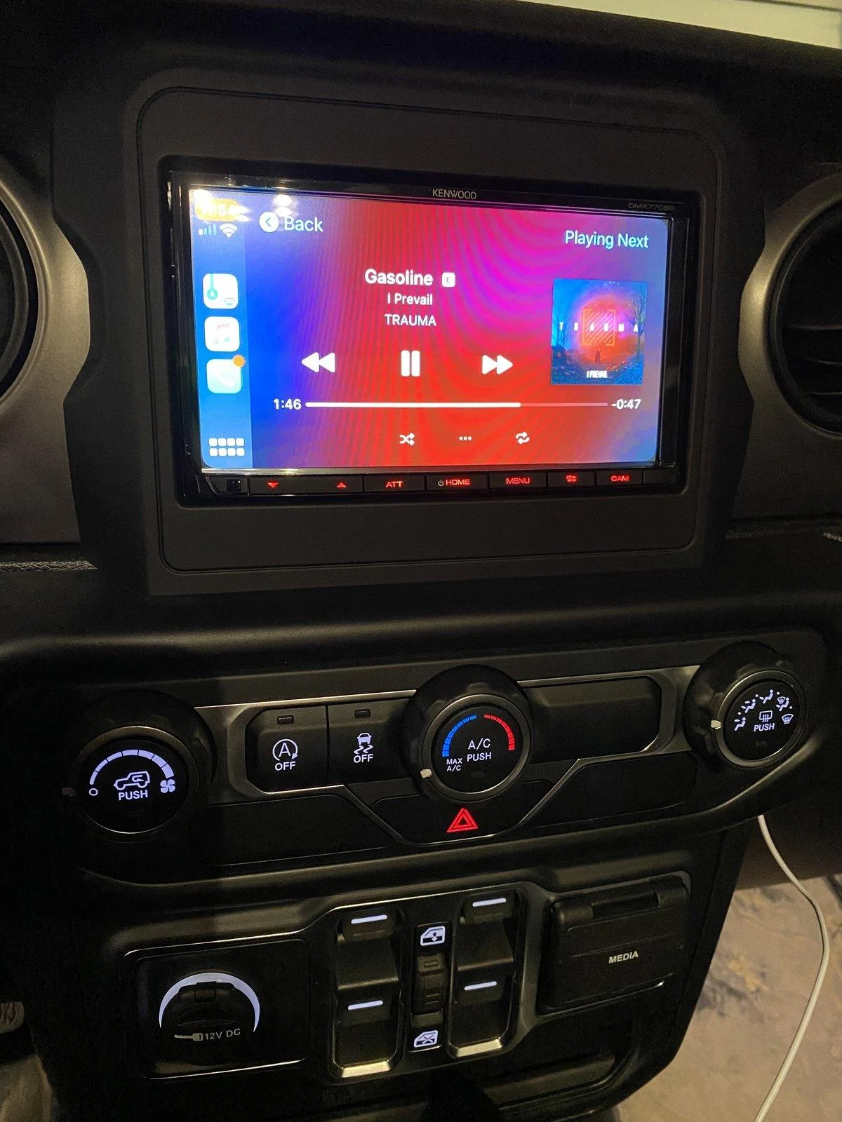

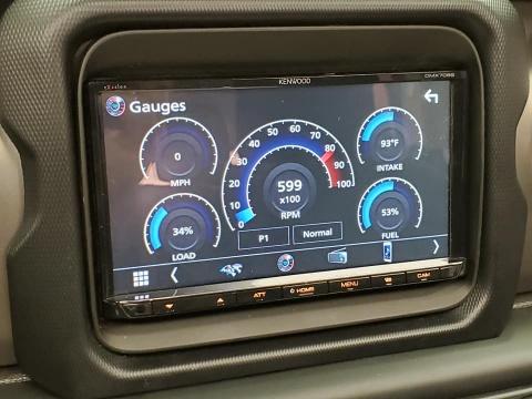

Finally swapped out the factory 5 inch to Kenwoods DMX7706s. I really missed android auto/CarPlay lol Installed myself with Metra dash kit & idatalink maestro rr/ch3 harness to retain steering controls, vehicle info, and temp gauges (also keeps climate control for those that have it). Has anyone figured out which two canbus ports to use behind the glove box to get gauges to work? I have currently lost my rear view camera And OEM USB connections due to no adapters being available, but I knew that going in. I’ll give them a bit longer To drop an adapter before I throw a nicer aftermarket Camera on. Everything else works great. Factory speakers do sound much better, but they will still be getting replaced With 6.5 inch speakers soon!

Very nice! What was the process of swapping out the backup camera and (I assume) wire?

We pulled the OEM camera out and found one that matched up pretty close in size and it mounted up very easily to the factory location. Then we pulled the new Camera wire from the radio to the back. That was also pretty easy and followed the factory wiring.

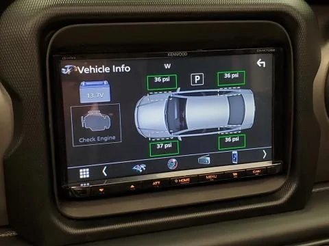

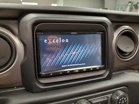

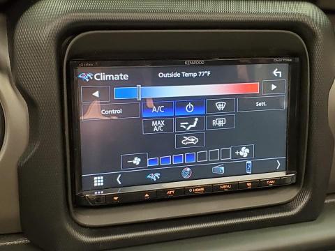

Finally got my new Kenwood eXcelon DMX706s installed and working. We installed it with the Maestro RR and have it working with most all functions operational. We do have a couple things we have to work on. Here are the Pro's and Con's to replacing the factory radio that I have found so far. This is for the 5" Base Radio.
Pro's

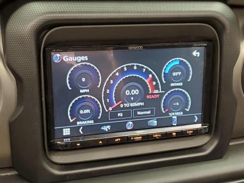

I now have TPMS, Vehicle Data, and Guages on the radio.
I now have Climate feedback on my radio screen. No control just feedback
I now have Apple CarPlay / Android Auto
I now have the ability to add a front Offroad/Parking camera
I now have Navigation
Con's
The factory USB ports will no longer work, so I had to add a new USB port
Still working on making the factory backup camera work. We believe it will, but will require an adapter plug. It is on order and I will report back when we know for sure.
did you use the connections behind the glove box to get gauges up and running? What port did you plug into, I couldn’t find this part anywhere in the instructions and didn’t want to just start plugging it in to random places. Lol
EDIT: Found the manual for the alpine vehicle specific install which had better instructions. For anyone else that installs with the base radio, you can plug the male connector from harness into the top left port of the green can us junction box. The second (female) connector that’s on the harness is only used if there is a connector plugged in that matches the colors stated in the instructions. In that case, you would replace the existing connection with the male connector on harness, then plug the oem connector into the female connector on the harness. Hope this helps someone else!
