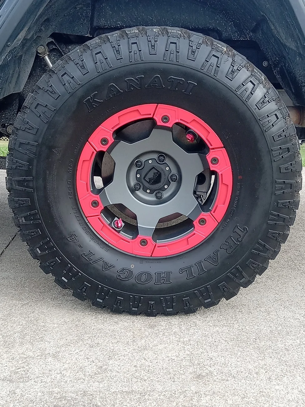

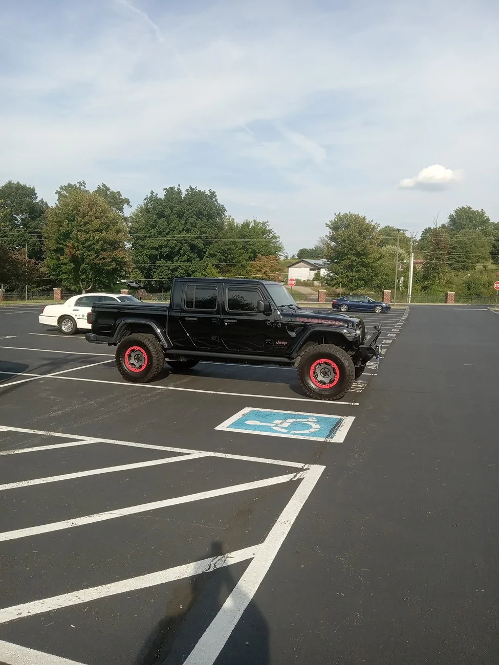

About the Terraflex Nomads. Do any of you that have them know the weight? Also, I bought the Firestone MT's and I will be having them mounted soon. Do the protection rings need to be removed prior? Thanks

If memory serves, they weigh 34 lbs each. You don't have to remove the ring but do make sure they are torqued down ro spec. If loose they cant balance the wheel correctly.

Thank you. On my 2024 Bronco Badlands Sasquatch Discount Tire had to remove the rings from the bead lock capable wheels.

I would assume the Bronco rings are beadlock rings, the Nomads aren't really rings at all. They're just cover plates.
Yeah, the rings on the Nomads are simply protection to prevent against trail damage... Orr in my case, to cover up trail damage because I didn't put them on when I should've.
