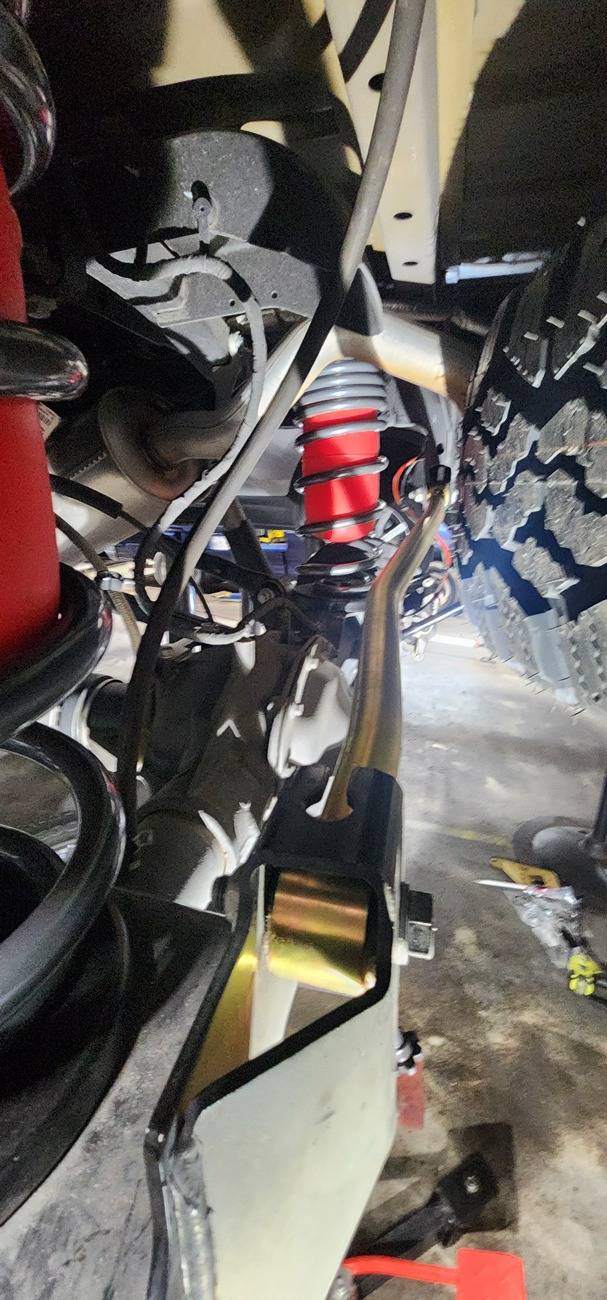

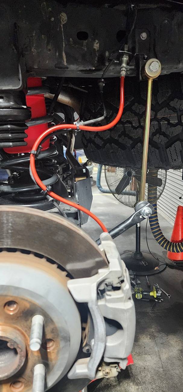

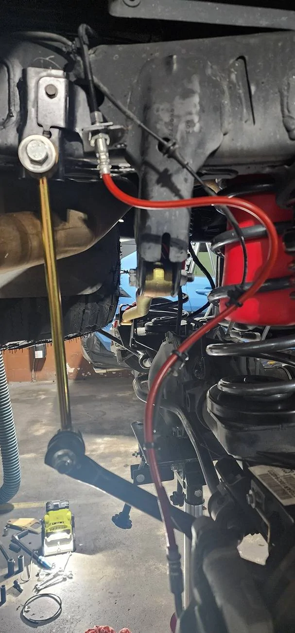

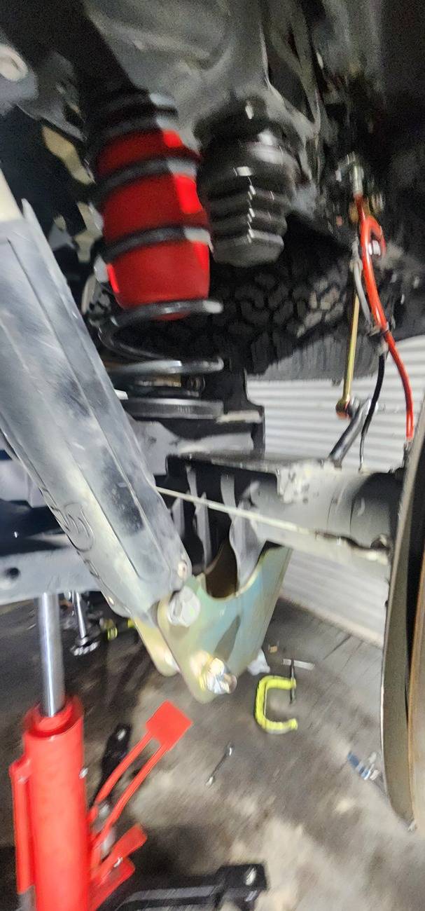

I bought the Gladiator Airlift kit. I have the AEV SC springs 2.5, with a Daystay Spacer beneath them. The Airbag is short by about 2 inches. I installed them the way the instructions said to. They go in with the Airlift spacer on top, it protects the brass ripple and line, they pass through a hole in the Spring perch. I left enough slack in the line to allow for a deflated bag to move up and down or for suspension travel. The line is routed on top of the frame to the rear meats at the frame mounted hitch near the spare on passenger side into a T and then on passenger side behind bumper mount there's a factory tie with an eyelet that I mounted the Schrader valve too.
Right now, I run the bags at 15psi no load. They don't move. I may lower to 10 when it warms up a bit.
I believe max psi is 30.

Suspension is unsprung in pics.
Jeep Gladiator Air bags or new springs? 20250118_141858
Jeep Gladiator Air bags or new springs? 20250118_141904
Jeep Gladiator Air bags or new springs? 20250118_140633
Jeep Gladiator Air bags or new springs? 20250118_140612
