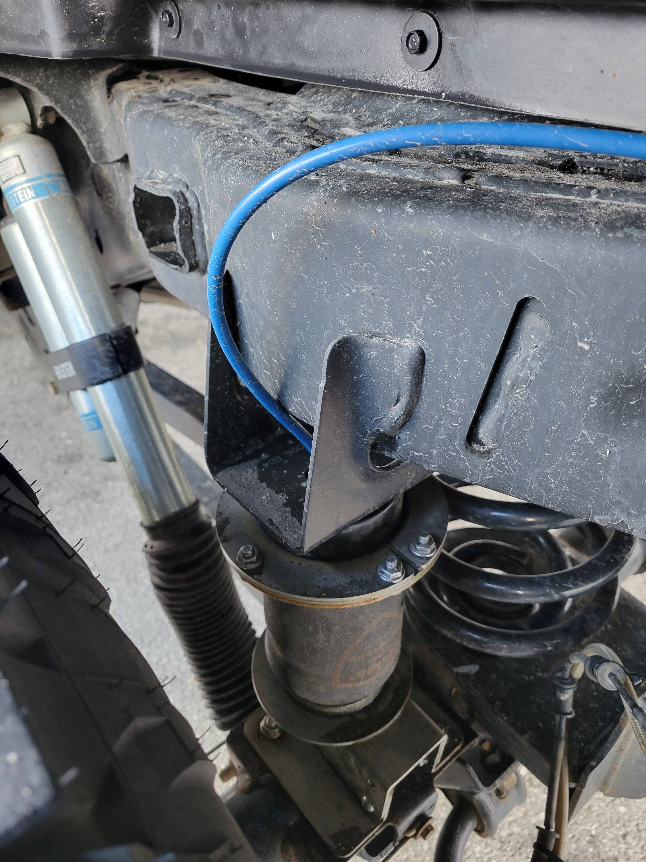

I have a set from Timber Grove. I love them. Super stout, and they don't really affect ride quality when unloaded if you air them down to the recommended 5-7psi. I like this setup because it puts the bags out wider than the in-spring bags, resulting in better stability, I feel...

The top bracket for the airbag in the picture. Is that part of the kit tha comes with the air bags or is it an original part of the Jeep?

The stainless ring with the bolts in it, comes with the kit from Timber Grove. You remove the OEM bumpstop, and clamp the top bracket of the bag to that bracket.
