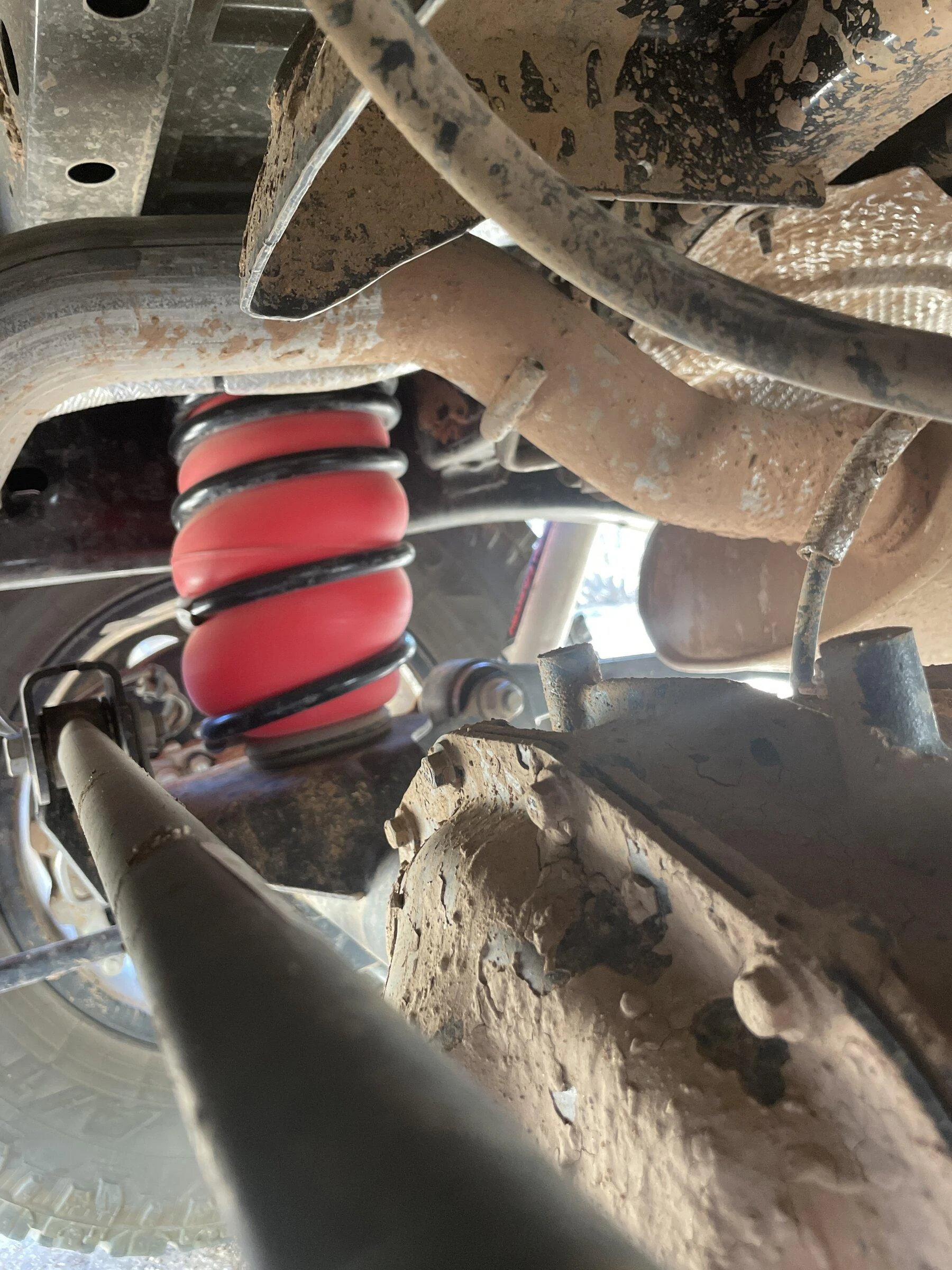

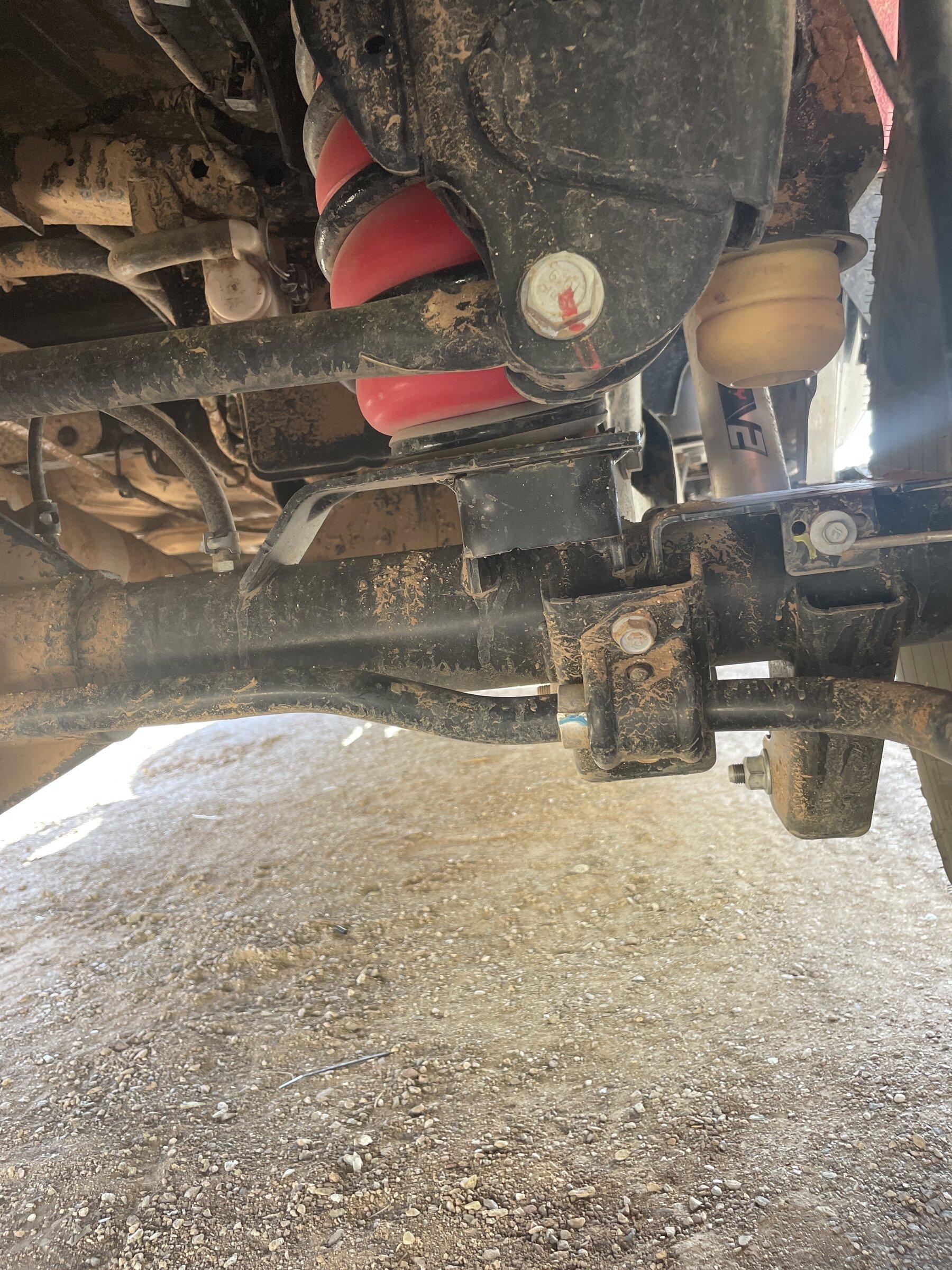

I have searched the forum for the last few days and haven't located any answers. I could just as easily have missed it because I royally suck at these search bars. Is there anyone out here that has a smaller lift (2-3 inches) and has had good luck with rear bags for towing/loads? Any help is appreciated.
3” lift with bags
I used them to minimize roll and bump stops bottoming out
Don’t use to try and increase load capacity spring cups designed for max weight and that’s it they will bend overloaded since it won’t bump stop load

Did you have to make or order any additional spacers to go with 60818 kit or were the bags and spacers provided with the kit enough?
I did not add any additional spacers. I tow a boat, the weight with trailer is about 5k and the bags reduced the sag by about 50%.
