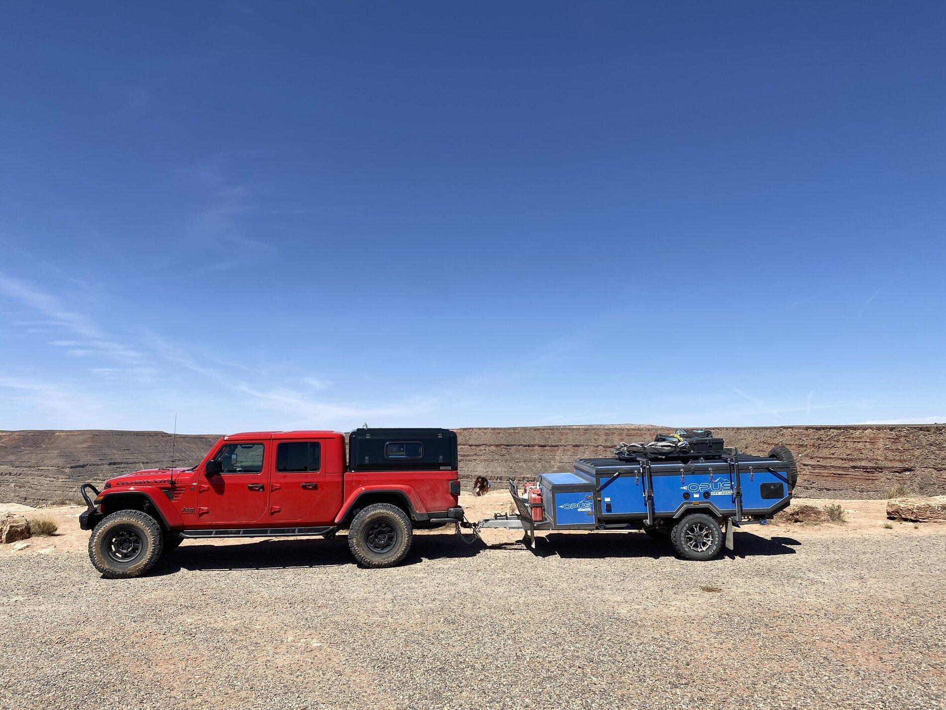

So I have a Clayton 2.5” overland plus kit on my JTR. I also put in the Daystar 3/4” spacer to offset the RLD cap weight (and brake line extensions to be safe).
Overall the setup has been perfect but now starting to tow. And have a 30+ day trip coming in June.
I have an opus OP4 trailer (4000 gross wt loaded max) and took it out last night first time.
I didn’t max the weight in the bed or trailer (1/2 full of water) but noticed I’m under 1” of travel left so it is squatting pretty bad. Also setting the Falcon 3.3s to 3 was a must in wind andfast traffic.
Saw a few other threads on this but does anyone have experience with bags like the Air Lift on 2.5” Clayton lift? Can you tell me which kit I need?
@Clayton Off Road
pic for attention (truck and trailer empty):

My local shop handles the airlift kits and they had to order one that fits (they didn't measure anything but they installed the kit so I'll have to verify they got the right fit before we install). That said we had to leave for the trip without the airbags. We have 1600 miles on the trip so far. It handles fine but there is not much uptravel left in the rear...
