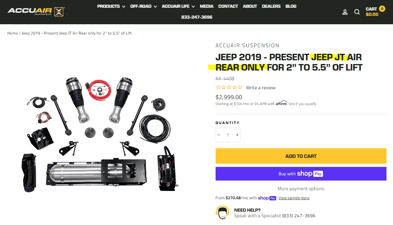

@chorky I think this could be your "goldilocks" solution...
