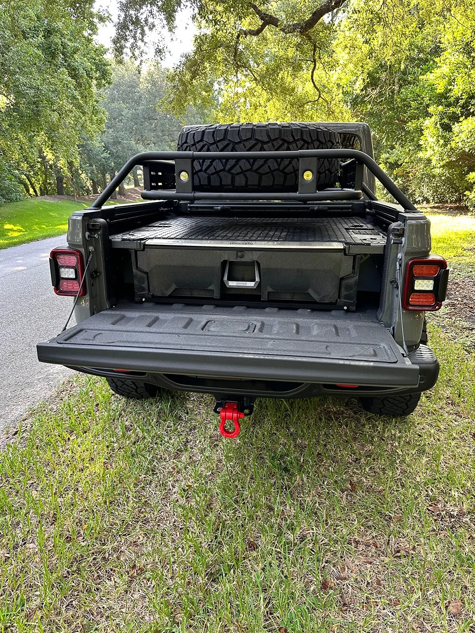

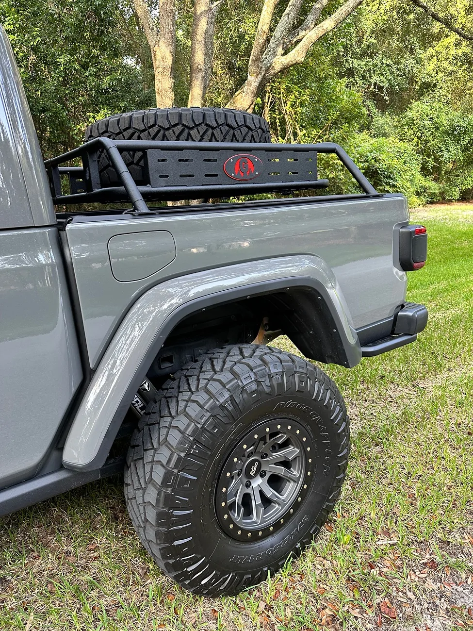

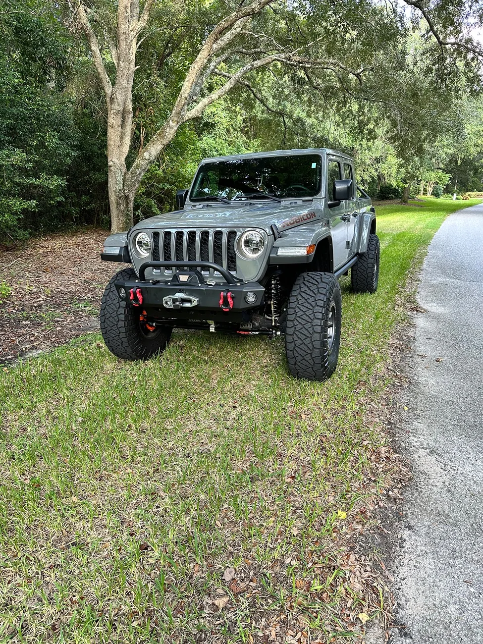

Eco diesel, upgraded to Clayton 3.5", and HD springs. I'm running a tire carrier and Decked bed system for normal use, loaded for camping and towing a teardrop trailer. IMO the ride is perfect loaded or unloaded with the HD springs.

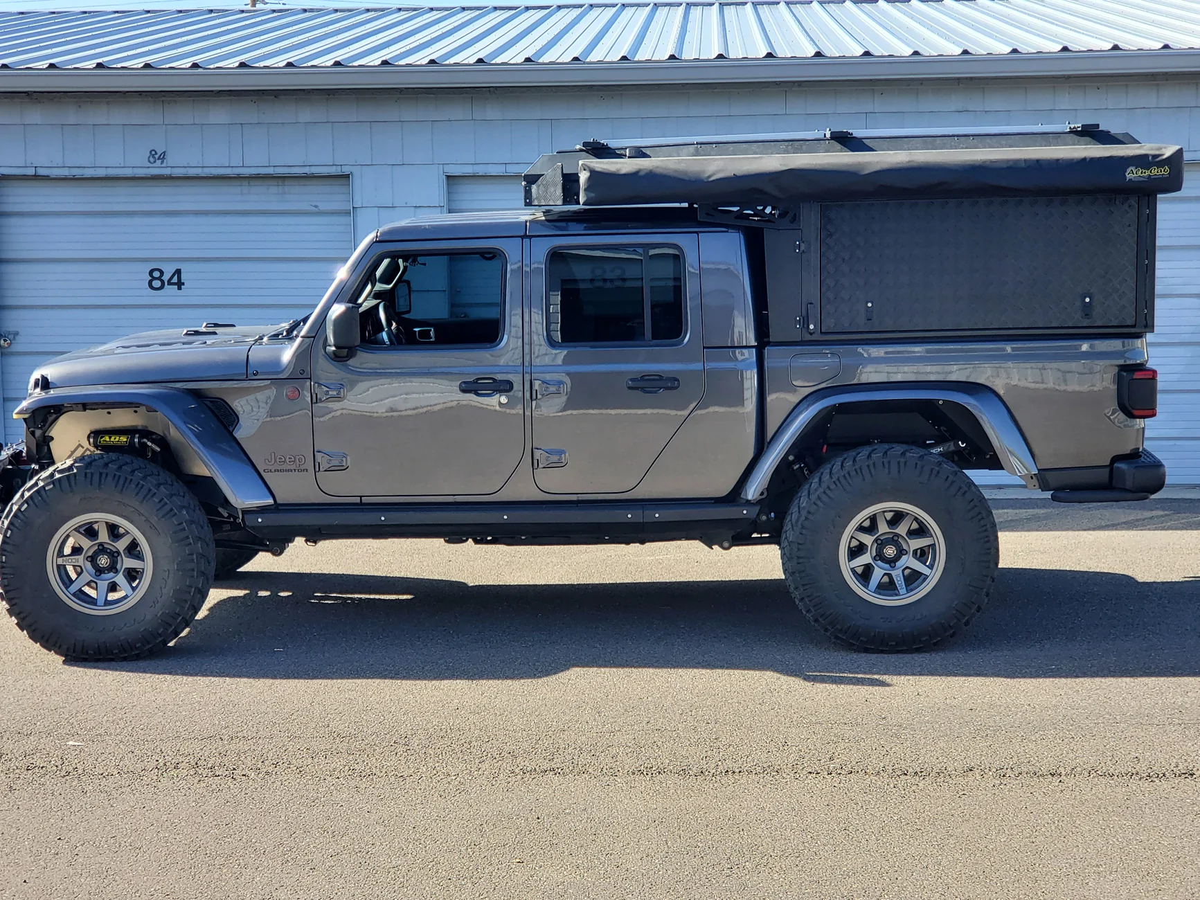

I have a very tail heavy setup, all additional weight I've added is on the rear axle.
Last time I weighed it over a year ago it was 3340lbs on the front and 3670 on the rear I've added weight since then likely at least 250lbs. I need to re-weight it.
At first I went with Clayton HD diesel springs but was high in front and way to stiffly sprung for my front weight.
On a suggestion from Phil @Liberty Mountain Fab who tuned and setup the ADS bypass shocks etc went to 5" gas springs in front. Now the ride is perfect and sets level.
