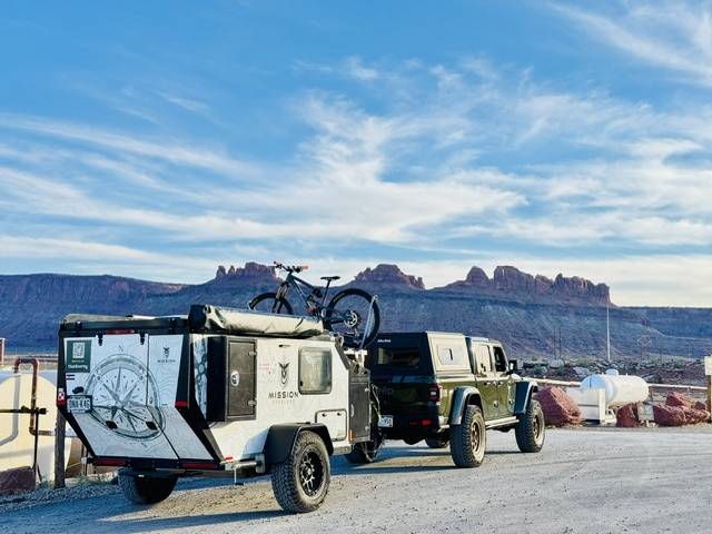

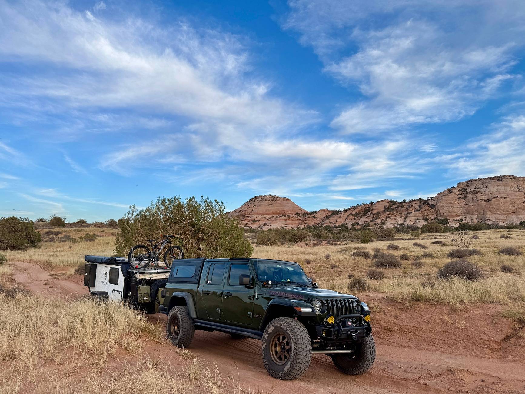

I have a 2022 JTRD equipped with a Clayton 3.5" lift kit paired with Fox Performance Elite 2.5 shocks. The Jeep is outfitted with several weight-adding accessories, including a steel front bumper, a winch with a synthetic line, rockhard sliders, an Alu-Cab canopy, and an ARB Elements fridge mounted on a slide with battery system. Additionally, I always carry tools and recovery gear in the vehicle.
Despite various adjustments to the FOX shocks, the ride quality on the Clayton springs has never been ideal. The 216 lb/in Clayton springs feel WAY too firm, and I’m now considering swapping them for something with a softer spring rate. My goal is to achieve a more "plush" ride while utilizing the excellent adjustability of the Fox Performance Elite 2.5 shocks for dialing in stiffness as needed.
I’m seeking recommendations for a new set of springs that offer a lower spring rate but still provide 3.5–4" of lift. I’m also open to supplementing the rear suspension with airbags to handle additional weight when towing my 3,500 lb overland camper or carrying a full load.
