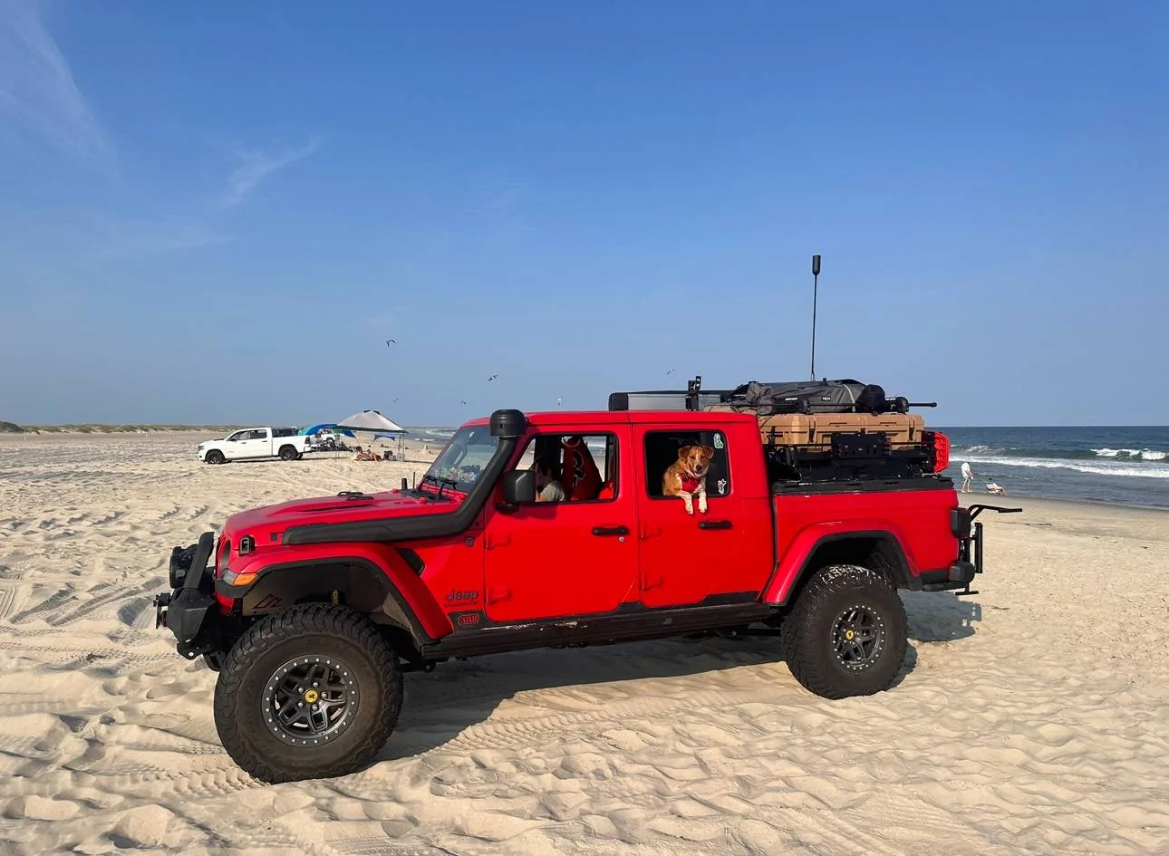

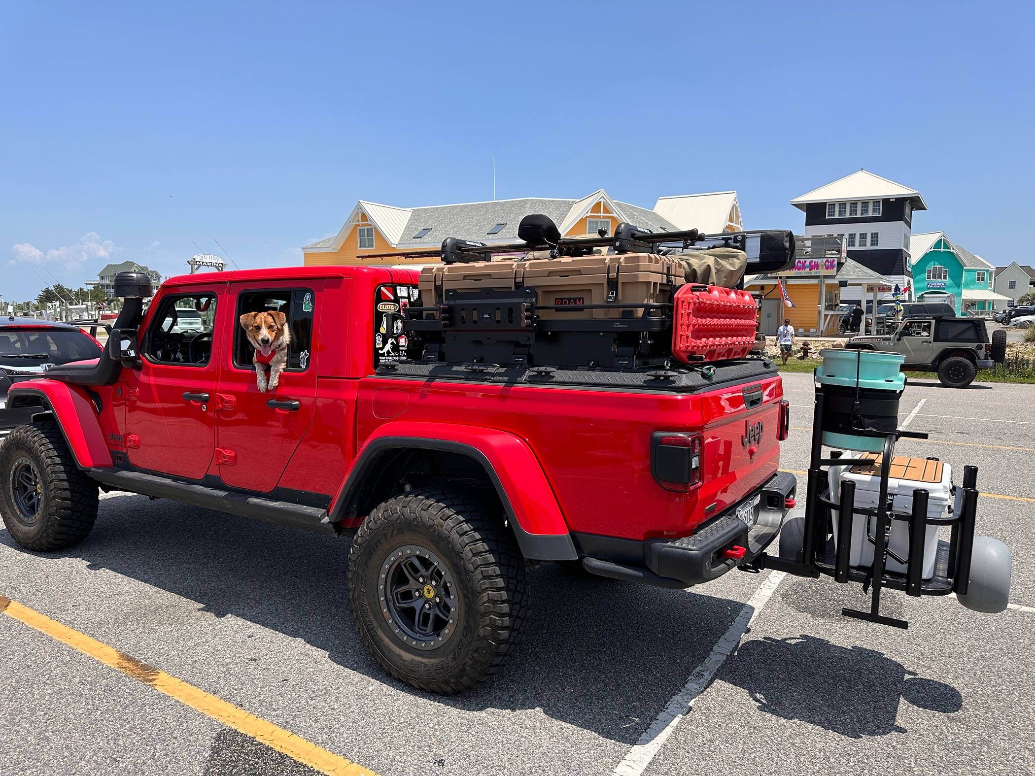

I’ve never run airbags so I can’t speak to those. I run a Diamondback cover, front runner slimline over top of that, enclosed with paneling, 8 gallon waterport, OVS awning, 63qt fridge, slide out, 1 or 2 ROAM boxes, 1 or 2 additional NATO water cans, a massive recovery bag, house battery system and tons of gear including a T8 tent a beach cart with cooler off the hitch and frequently a pizza oven 😂. With the 2.5s I sat even front to back and the rear end felt mushy, like I was moving someone or carrying a load concrete for a home project. Not a good feel for off roading. With the 3s I retain rake while loaded down so I’ve still got the capacity for off roading. I think the 2.5s will work. I’d see how it looks and drives and then decide. Just remember with the 3s you will have to reminded all the control arms since they use bushings. It looks like this with all my crap:
