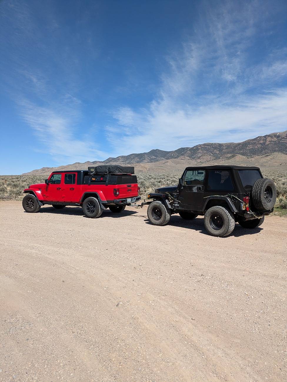

I was also thinking of flat towing mine, and taking both on the trail, my wife driving the 2 door. The 2 door doesn't do so hot for long highway drives and my wife doesn't drive on the freeway.
The only real concern is wear on bearings and such. And any case you make the 2 door undrivable while off-road. But you can always rent a dolly or trailer in that case.
I did a 3k mile trip in my TJ with my wife and that's enough long road trips in the old jeep for a lifetime. so anywhere really far we will tow it.
The plan for me is to use the gladiator as Basecamp with a RTT and tow the old jeep for the fun trails.

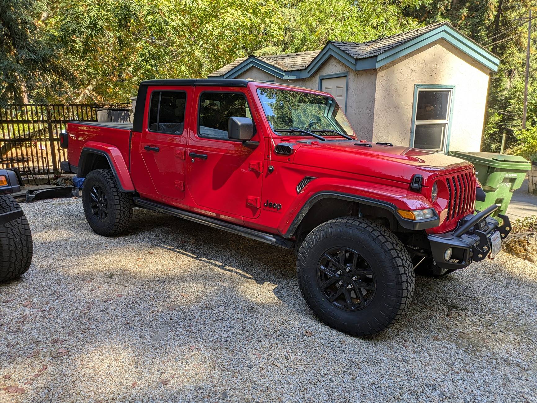

Got some new tires in. Toyo AT3 285/75 R17 on the factory black gloss alloy wheels. 2 inch lift with this tire size is pretty perfect in my option.

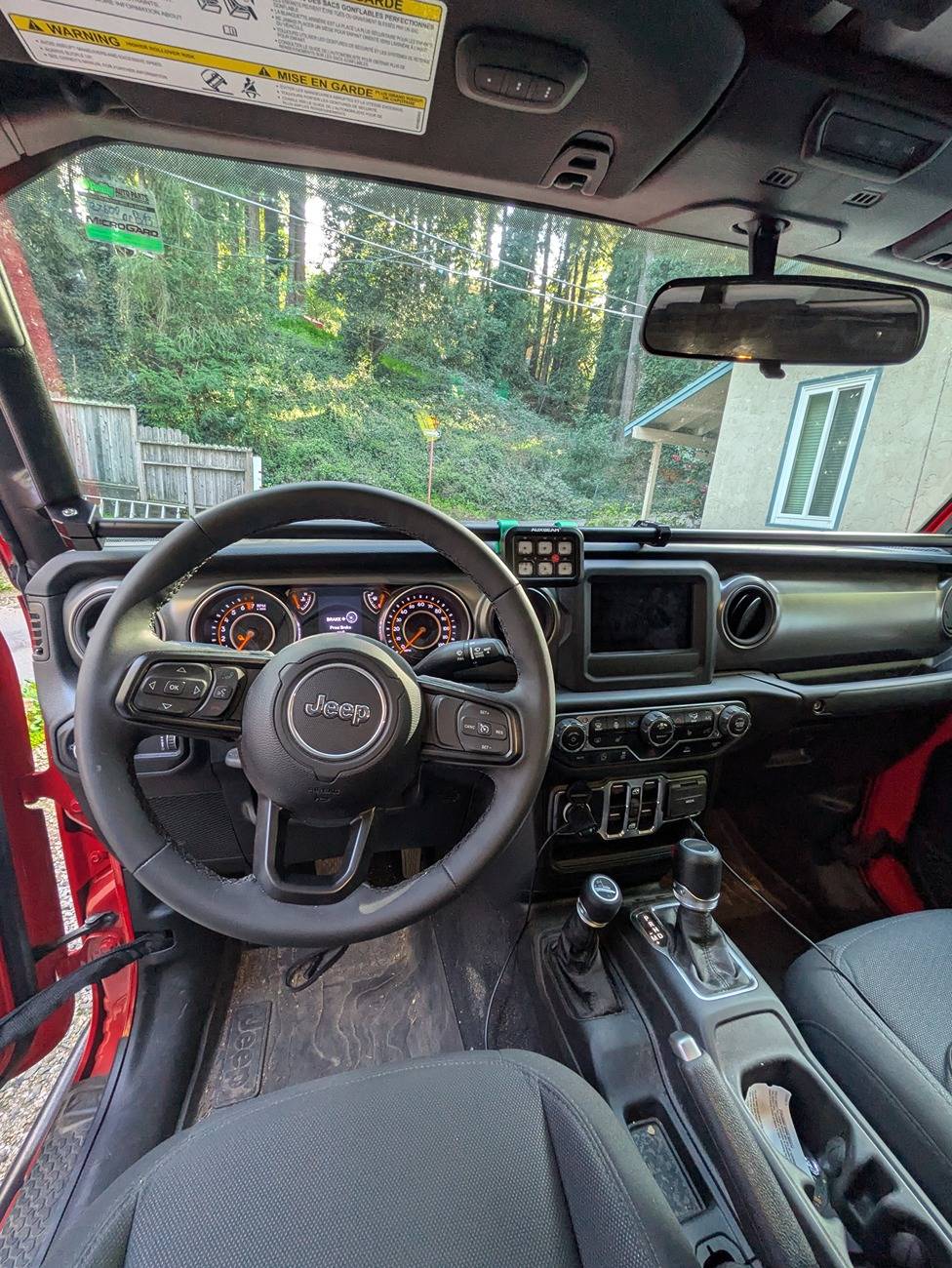

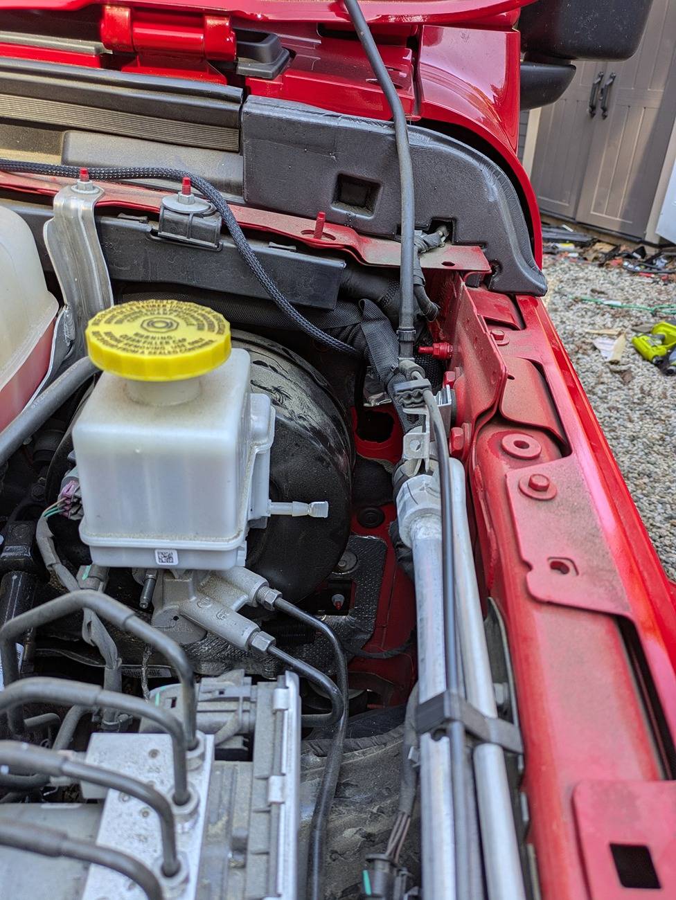

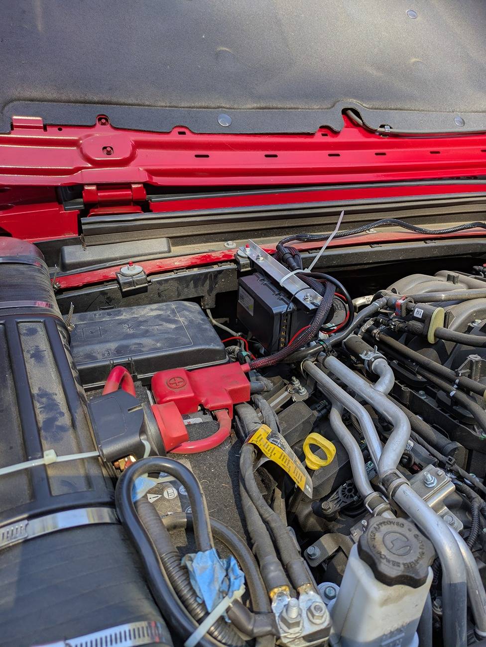

Installed an auxbeam fuse box/panel today. The panel isn't mounted yet since I don't really want to drill a hole in my dash. So I'll figure it out eventually.
I'm not sure if this is common, but my truck doesn't have the big plastic V6 cover I see on a lot of jeeps. But that meant I had a big gap to place the fuse box.
Jeep Gladiator Almost Rubicon - Family camper, weekend overlander, TJ tower PXL_20250301_201646778
I can't really put it on the fender nearby since my snorkel tube is there. The price I pay for not having a giant external snorkel I guess.

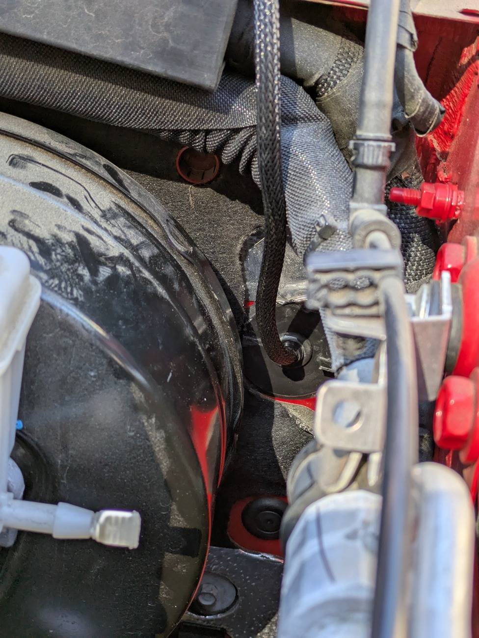

Then I just ran the cab side wires along the cowl area and in the plug for the clutch hole. Don't be sorry it's all tied down after an ace run.

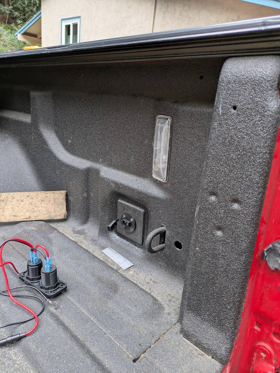

Now working on the bed aux plug. Using this style so I can easily adapt to anything.

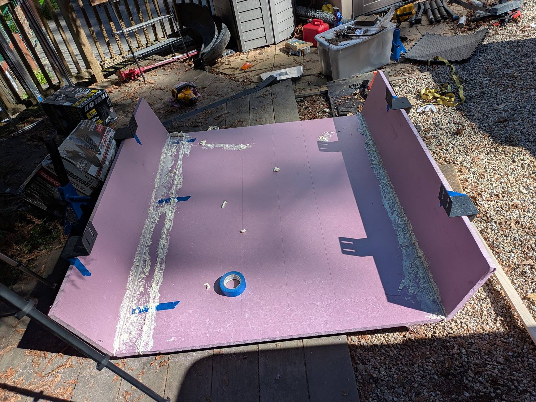

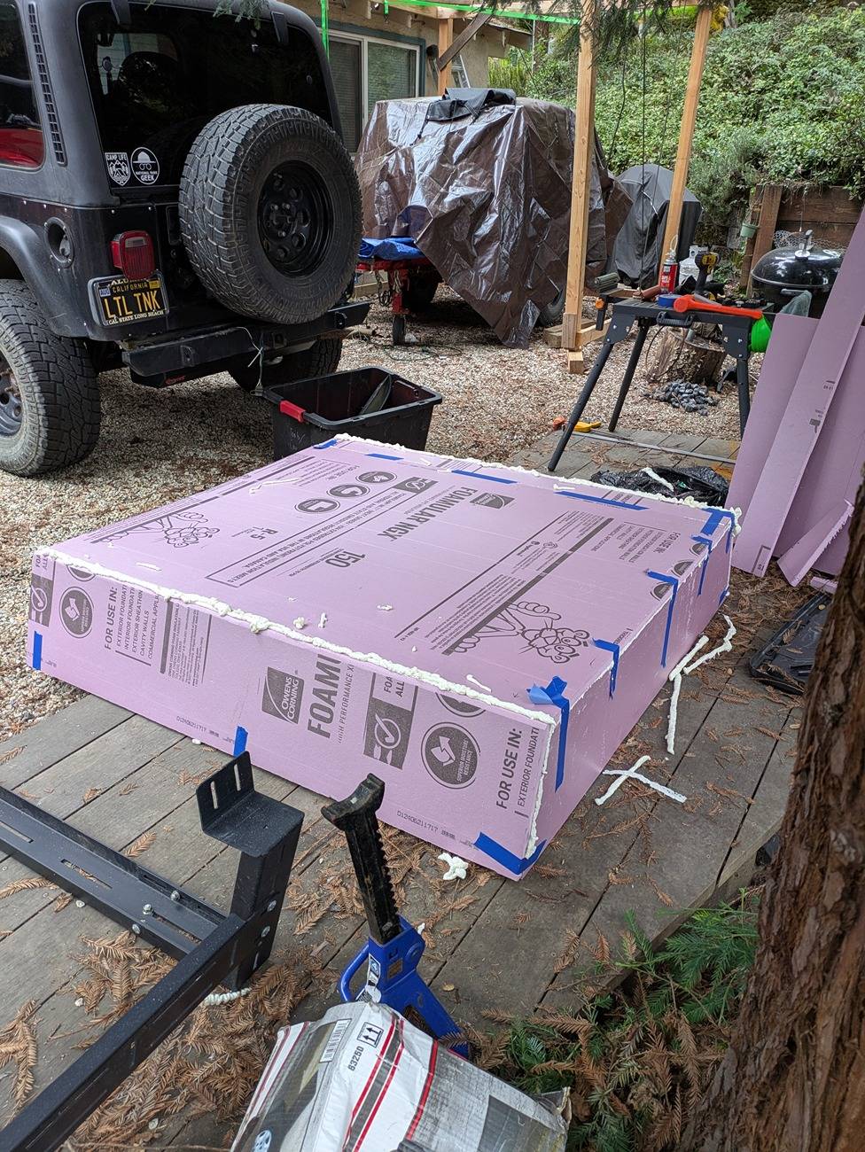

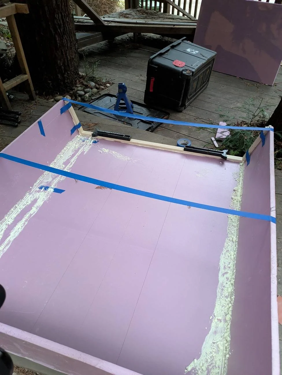

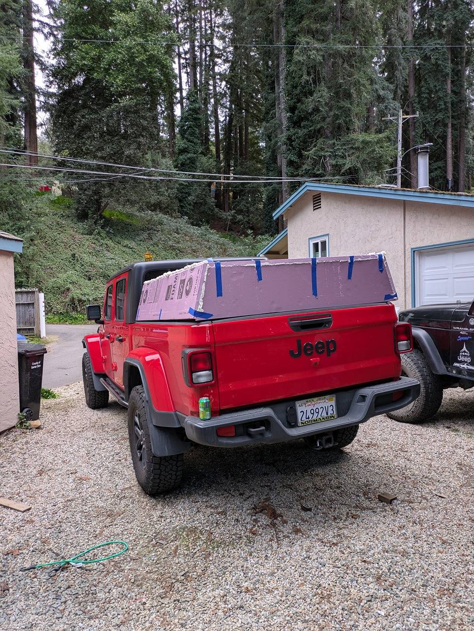

Now the actual fun project I have been working on! I previously made my truck bed cover work with the jcr off-road adventure rack. Buuut. I went with the flush hard trifold cover and it just barely catches on the cooler and other items in the bed.

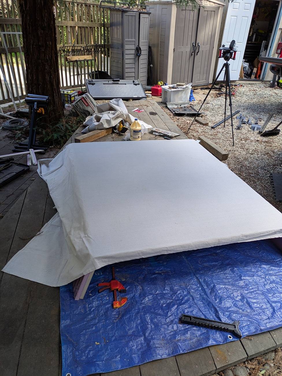

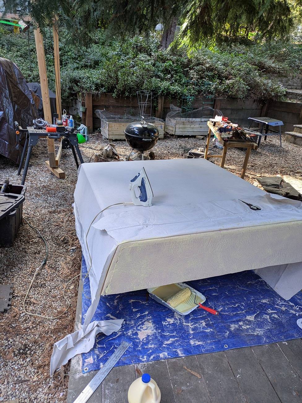

So I have decided to build a foam based hard shell using "poor mans fiberglass". Which is using cotton dropcloth as the glass weave and wood glue as the epoxy. Then outdoor paint to waterproof it. All in with the glue, dropcloth, foam, paint and wood I'm currently only in $180. I'll update here after I "glass" it and then again after paint.
This it roughly fitted in place. The rack for the roof top tent will go around it.
Jeep Gladiator Almost Rubicon - Family camper, weekend overlander, TJ tower PXL_20250302_004305984
It's just made from XPS pink foam and using great stuff expanding foam as glue and filler.

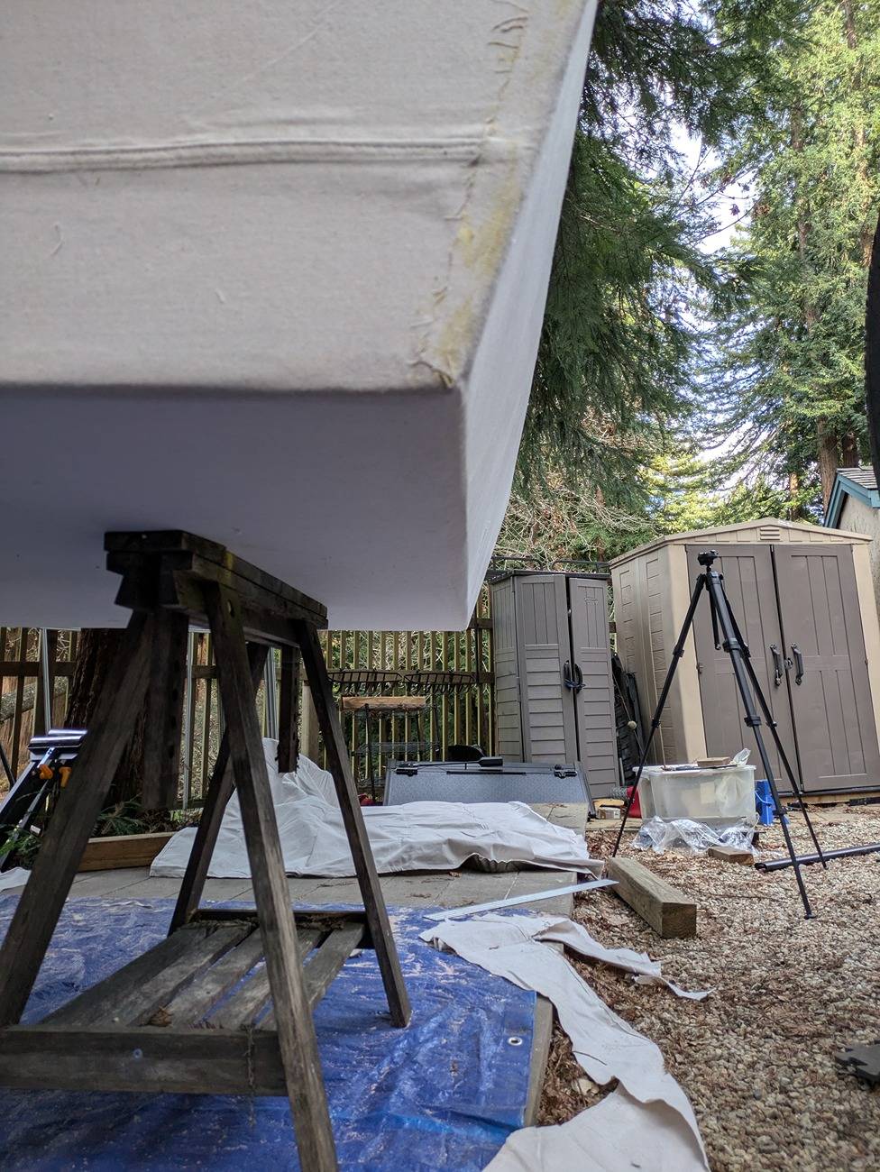

Canvas went on today!
Jeep Gladiator Almost Rubicon - Family camper, weekend overlander, TJ tower PXL_20250303_215730571
Jeep Gladiator Almost Rubicon - Family camper, weekend overlander, TJ tower PXL_20250303_222229195
Jeep Gladiator Almost Rubicon - Family camper, weekend overlander, TJ tower PXL_20250303_234458528

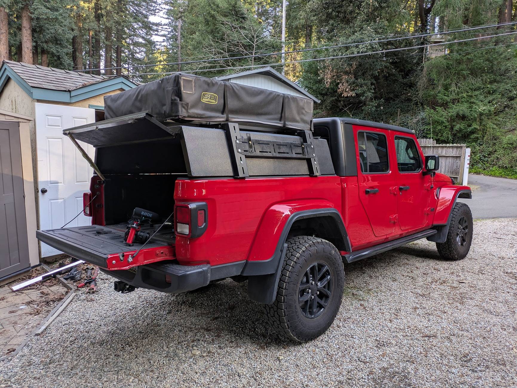

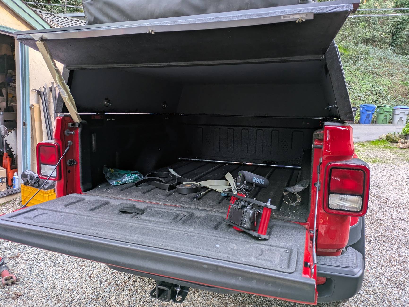

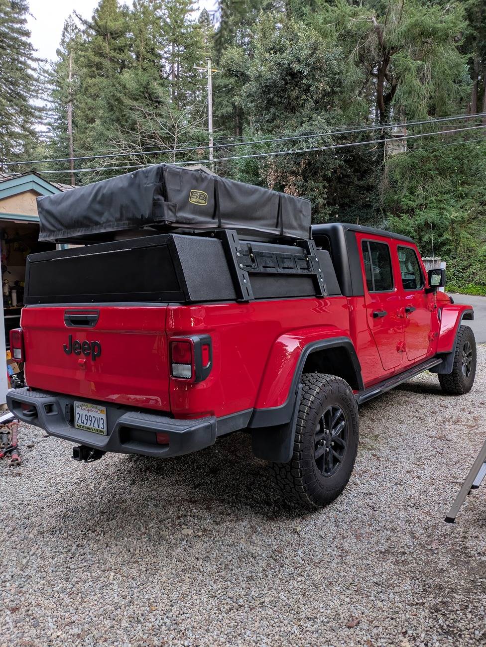

My camper shell is complete! 25lb and just about $250 for peace of mind when our camping or getting last minute groceries on the way to camping.

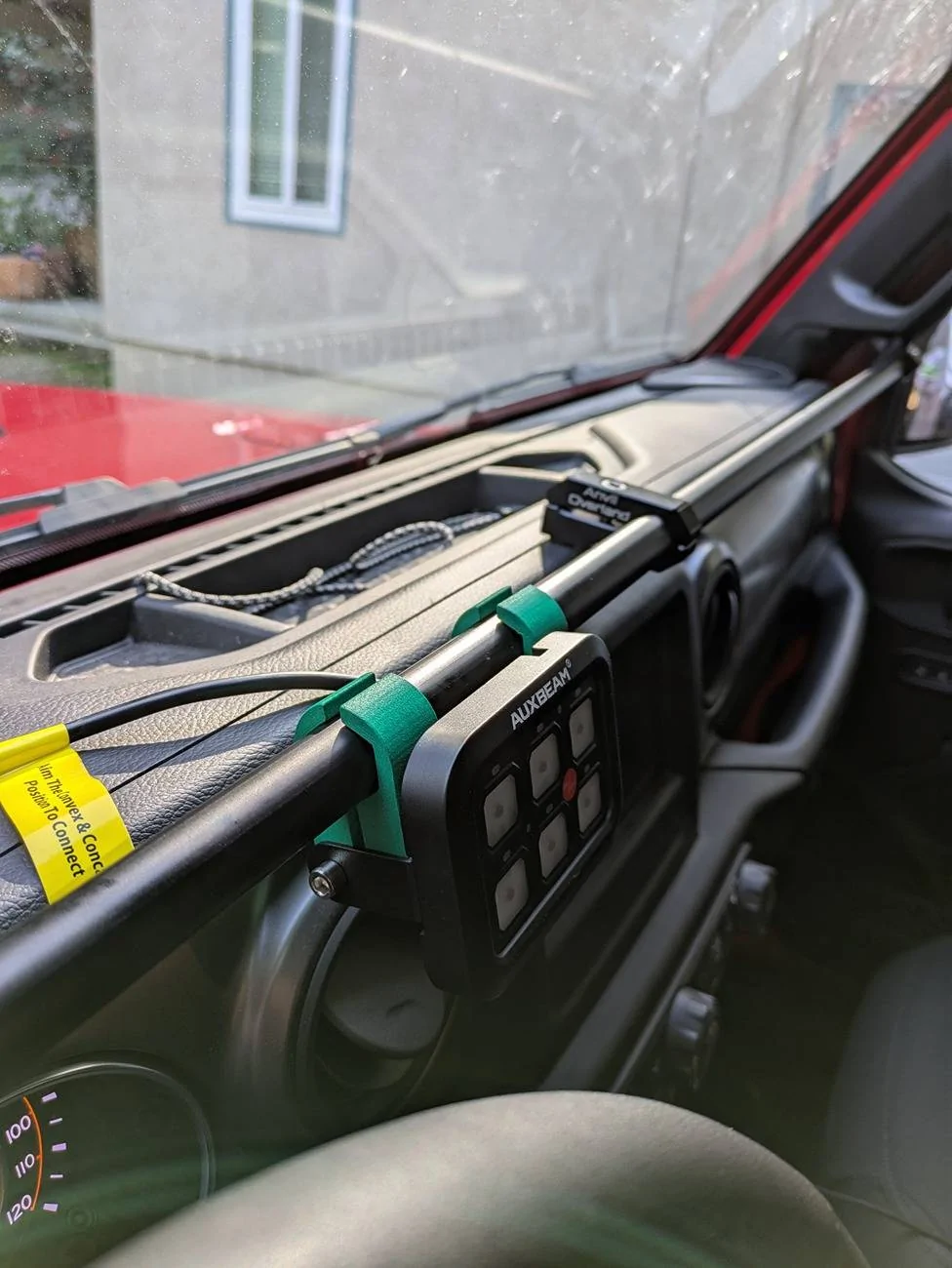

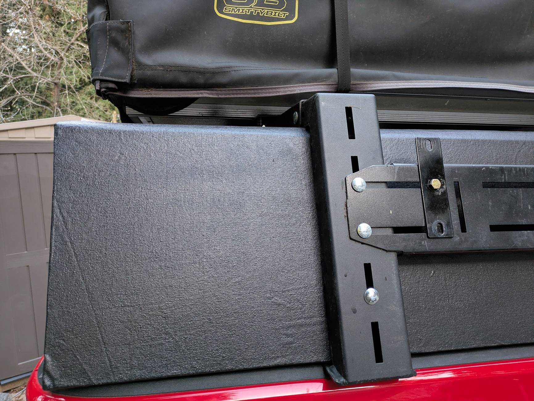

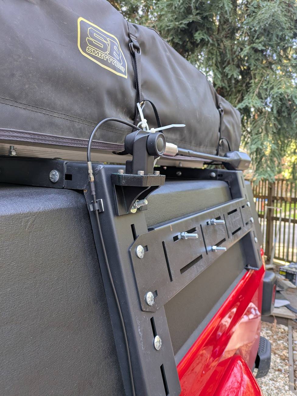

Got the Anvil Overland bar in.
Then got to modeling and 3d printing a mount for my auxbeam panel.
Also modeled a mount for my weboost antenna. I'll post a link up to the models when I upload them
