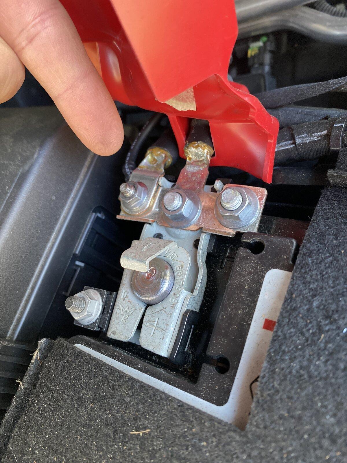

Benjamin , may I ask what the final arrangement on the gains and filters were? I was going to use 125 on the F&R and gains at 9oclock and set the sub to 120 and it's gain at 3oclock.. I did read a lot of posts..
Secondly what terminal on the battery did you use or did it not matter?

I did those setting except set both gains to 9 o'clock. There's only a single wire that passes outside the cab and it goes to the positive battery connection on the battery. There's a ground point under the seat next to where the sub will reside

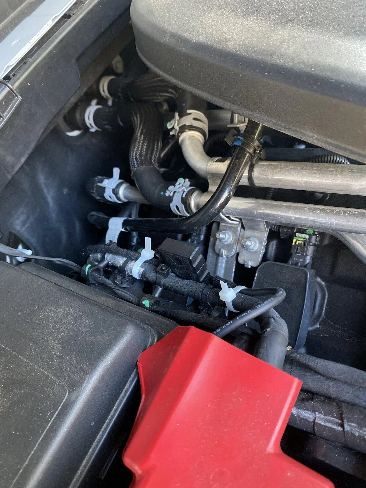

I had all settings the same as the manual—
When I disconnected the negative lead I also disconnected the aux battery negative as well; I noticed my interior lights stayed on until I disconnected that so I wanted to make sure I didn’t short anything.
The only thing I made a mistake on was the RCAs labeled sub; I didn’t initially plug those into amp with the orange connector because the orange connector was attached to itself so everything seemed clean and buttoned up.
Also one thing to note which no one really explained were with the wiring harness behind the radio—the labels on the harnesses say “in” and “out” on the white and black it makes sense if you take time to think about it but can be easily wired wrong.
You got OUT from radio IN to amp; than OUT from amp IN to car speakers. So IN connects to OUT and vice versa—if I designed it I would’ve labeled differently to make idiot proof.
In the attached picture of the positive terminal I’m pointing at the one used.

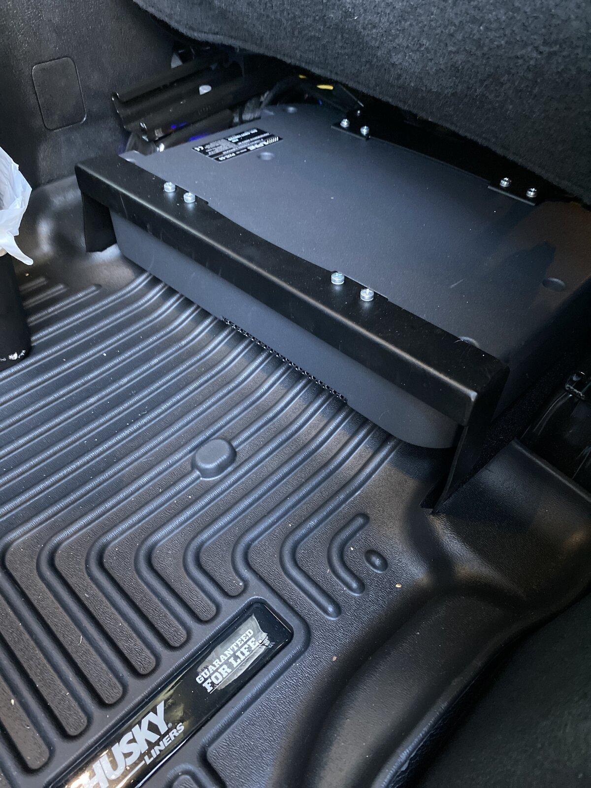

Also I showed a pic of the husky liners I had to cut I order for the sub to fit properly.
