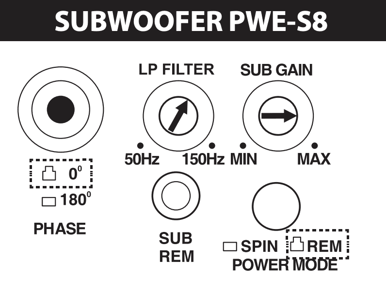

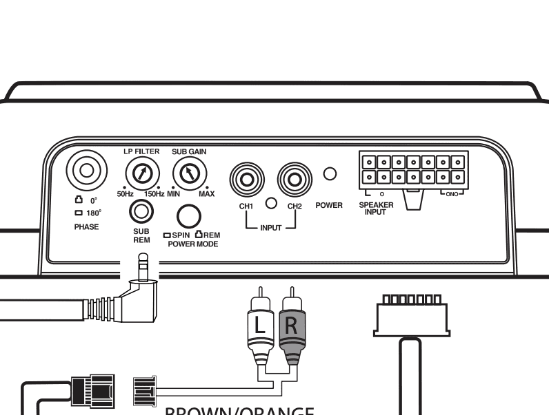

There is a button on the side of the subwoofer that is labeled "Power Mode" make sure that button is in the UP position.
