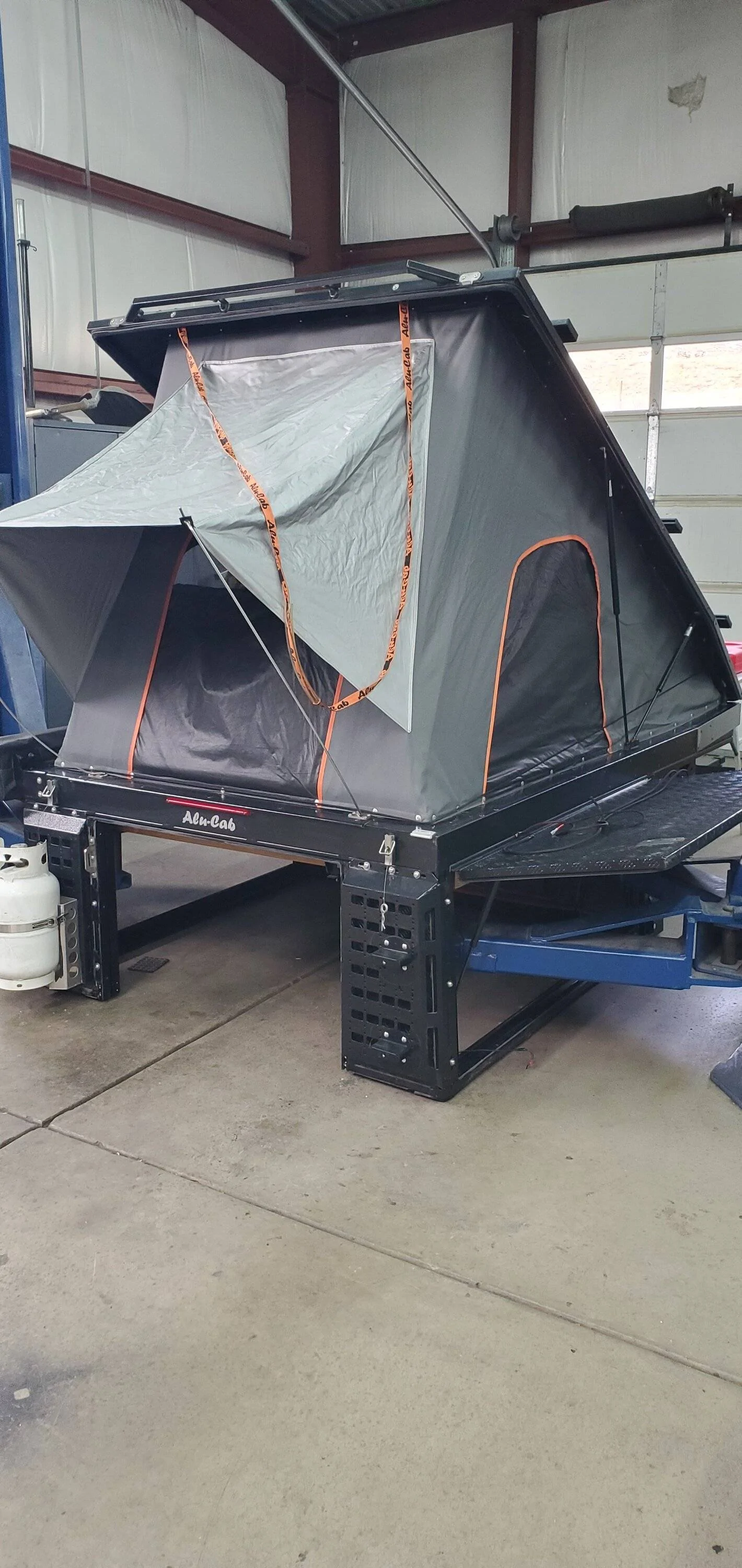

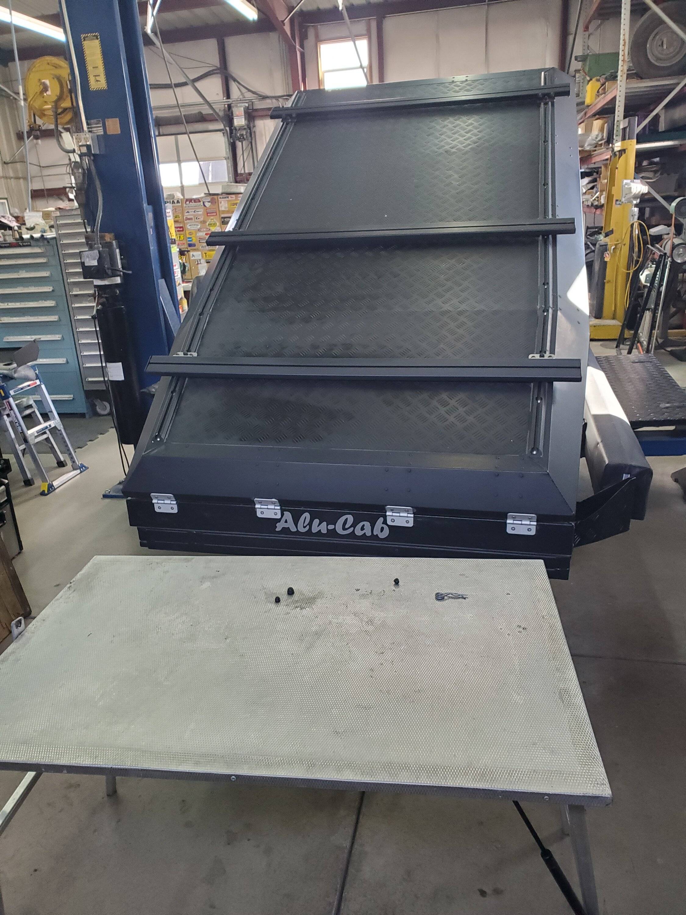

I guess having my build would have helped.
I have a Canopy Camper, older model no entry for Solar.
I have room for 2ea 200w Redarc panels and they will fit down between my rails.
A Redarc full manager 30 system and a GP factor mount for all.
230ah LiTime battery.

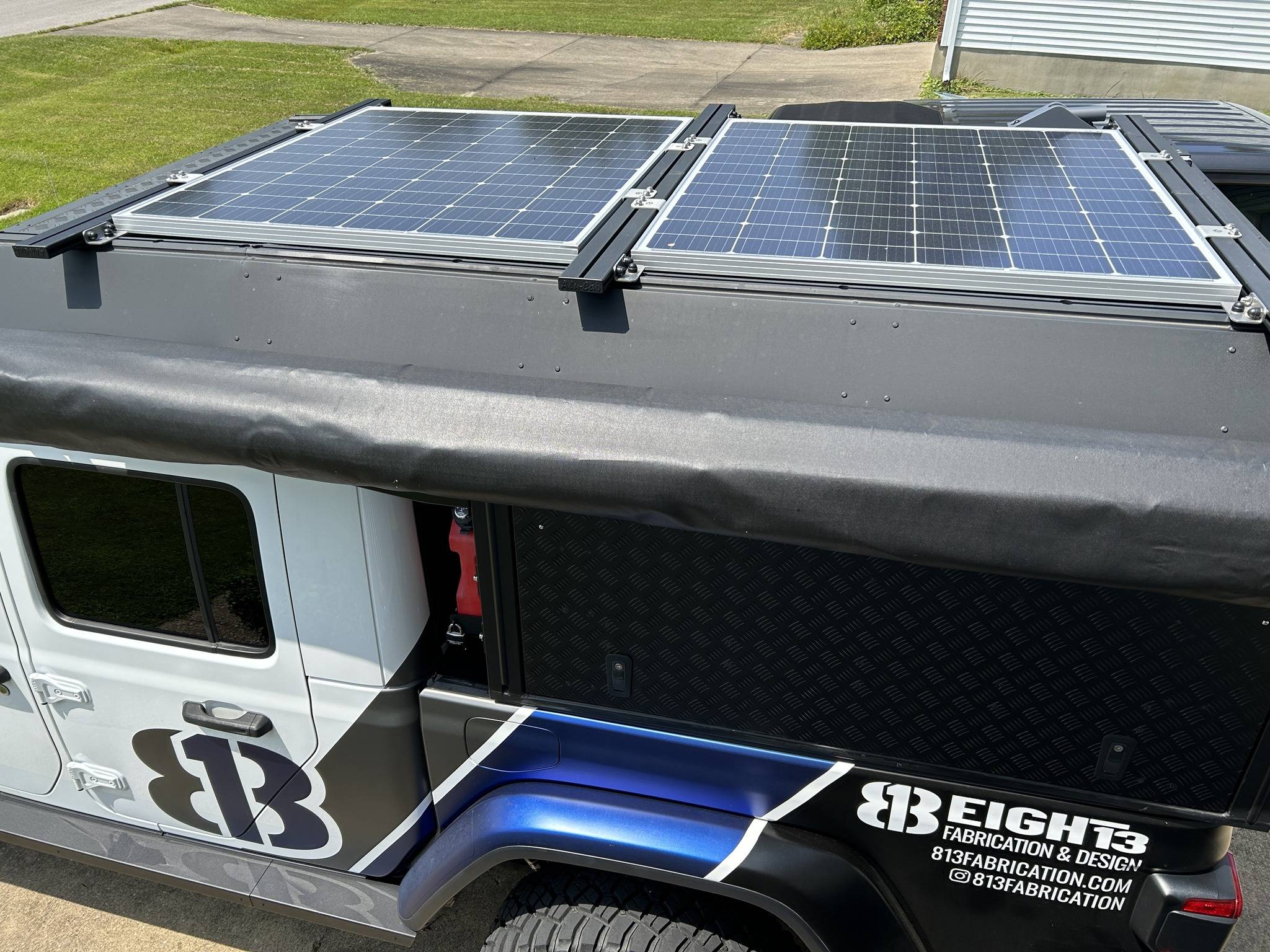

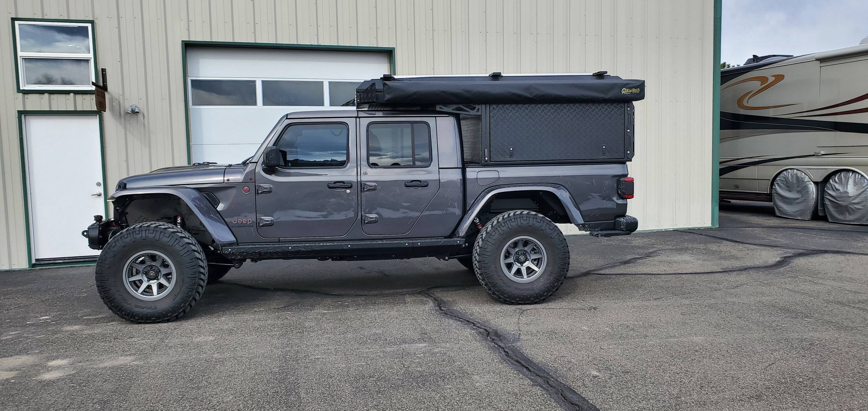

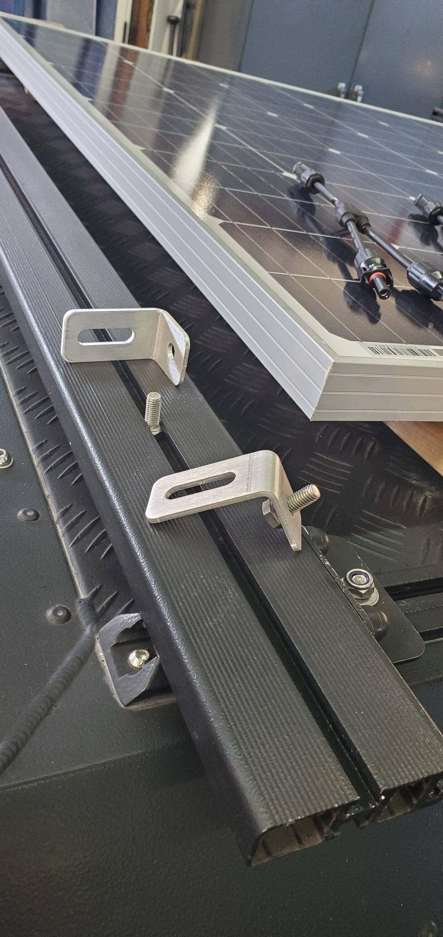

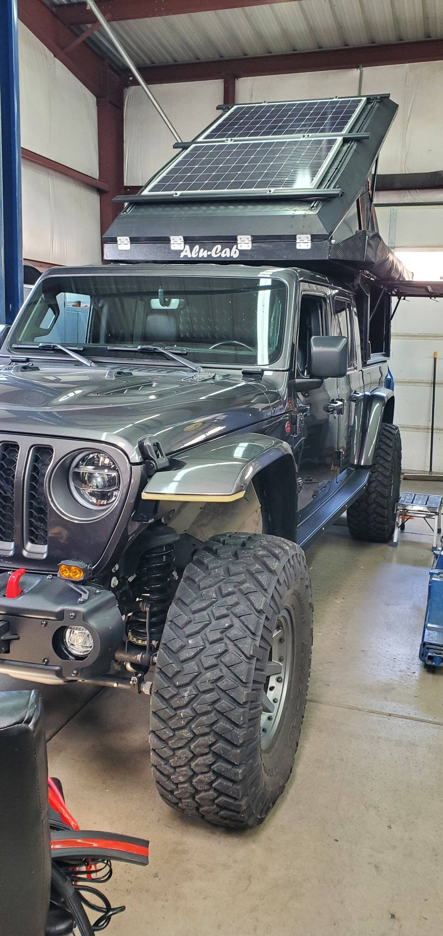

Got the panels mounted using tabs from 813..Thanks! and the Alu-Cab mounted..working on elect and insulating all the bare metal where possible.
Ordered up a pair of Clayton 3.5" HD rear springs as the Synergy's as expected are not up to the added weight.

The Mod Cap looks to be a similar size as mine, in fact wider. I used Redarc 200w panels as shown above.

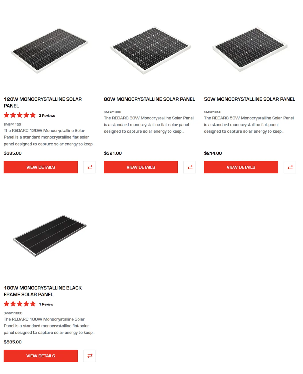

I see the panels in your picture, but I don't see a 200W panel on RedArc's website. They only list fixed panels in 50W, 80W, 120W, and 180W. Am I missing something? Do you have a link to the panel you bought? The smallest 200W panels I've seen are ~ 50" x ~30". It doen't seem possible to get 400W up there with the space available (~40" x 76" on the modcap family"), which is why I'm very curious about the 200W RedArc panel you used.

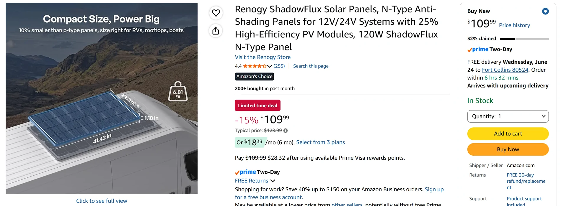

I bought 3 of the Renergy Shadow Flux 120W panels. They are the exact width of the rail and ~3" shy of the length of the rails. I can mount these directly to the rails by riveting/bolting them together and then bolting them down to the alucab rails using L brackets similar to what you used on the 4 ends of the rail. This covers 95% of the roof area and is still only 360W. But if I can get 400W and only cover ~75% of the roof as you show, I'll return these panels.
I can post a build picture in a few days when I get it all put together.
Panels I bought, but have not installed yet:
Jeep Gladiator Alu-Cab Canopy Camper Solar question 1782161040821-n0

Just to clarify for anyone else looking to do this. Rail length is ~76", and these panels are 22.75". 22.75" x 3 = 68.25"; so it would appear you have 7.75" to spare along your rail for L-brackets, but the alucab's rail widens at both end and doesn't allow for mounting. In reality, you're left with only about 71" of rail length to mount on.

I used Redarc SMSP1200 they measure 39.1x43.7". But seems they are no longer available.
