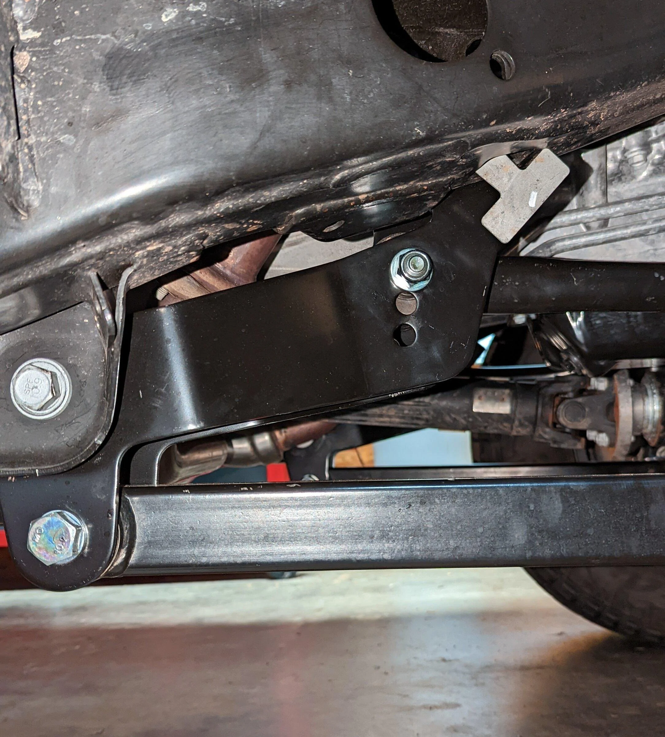

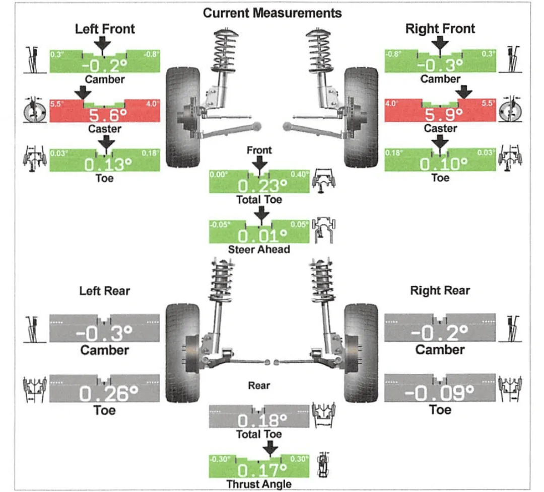

This is my alignment report.
I have the Rancho brackets installed. Uppers are currently in the top hole.
Move down one hole?
What's the best way to get it to line up? On Jack? On ground?

After studying a bit more positive caster I think I'm going to leave it right where it is.. It's driving great.
I am mounting these tomorrow morning. I am also question which mounting location to use. Instructions say for non rubicons to use top hole for 3.5" lifts, but it looks like Instructions are for the JL Jeeps, not Gladiators. I'm going to gamble on top mounting location. How are you liking these?
They seem to have improved the steering and the ride quality significantly. The bumps feel less bumpy.
I'm also running about 35 psi by my gauge/ 33 by the tpms.
