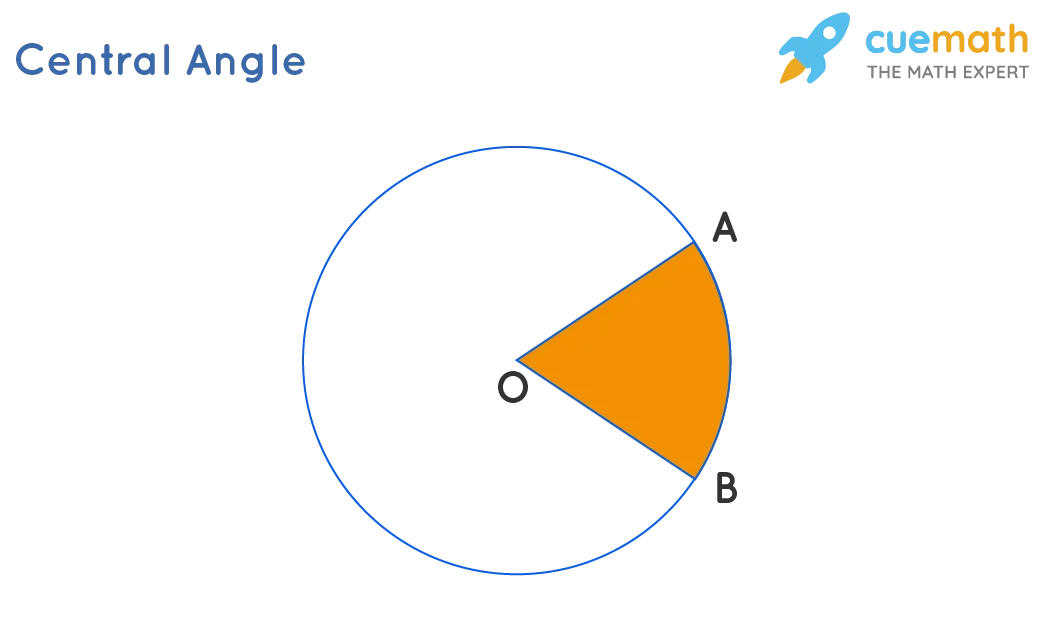

Now here's the flaw in your theory -
The control arms swing in an arc. Assuming they are perfectly level, parallel to the ground, on a stock vehicle, any downward swing in that arc will result in a minimal swing "back" in that same arc.
The more you swing the arms down, the more they swing backwards.
You can visualize it this way - draw a 10" circle on a piece of paper.
Now take a pencil on the far left part of that circle and follow that circle around with the pencil until you are exactly 1" down on the paper from where you started - note how far to the right the pencil has moved.
Now take that pencil down 1 more inch - and note how much farther to the right you have moved that pencil on the paper.
The more you drop those control arms, the more backwards the front ends of them move.
So the first inch of moving the axle down results in very very little caster change.
The second inch down you go with the axle away from the frame, the more back the front ends of those arms move from where they started.
Go more than that and you are swinging them back even farther. Go far enough and you move the fronts of the arms back a lot compared to how far down you move them.
So the FIRST 1.5" is a minimal swing back, but each added inch means you have moved those so far that now they are moving BACK when swung down.
Correction brackets move the rear of the arms down so you keep them parallel and they don't move as much fore and aft on a swing.
In other words, no change 'required" with the FIRST 1.5"
2" is pushing it, best to change caster.
3.5" means you are really swinging those arms down - and thus BACK, best to correct the geometry
That's where I stand as a person who restores vehicles, and worked through college in the 70s doing alignments, etc.
You can "get by" with a lot - but eventually, you'll push the limits. a 3.5" total lift is pushing those limits.
Note this circle - the control arms swing in an arc like this - part of a circle. Notice that once you get beyond the angle shown, you move farther to the side......
