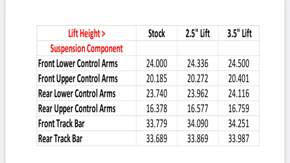

Adjust your upper arms to around 19.75" eye to eye and your lowers to the stock setting.
Typically this will set you close to 6 degrees.
Test and let us know how it does. You can adjust more if needed but that is what ive done on mine and another gladiator with no wandering issues.

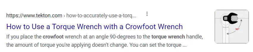

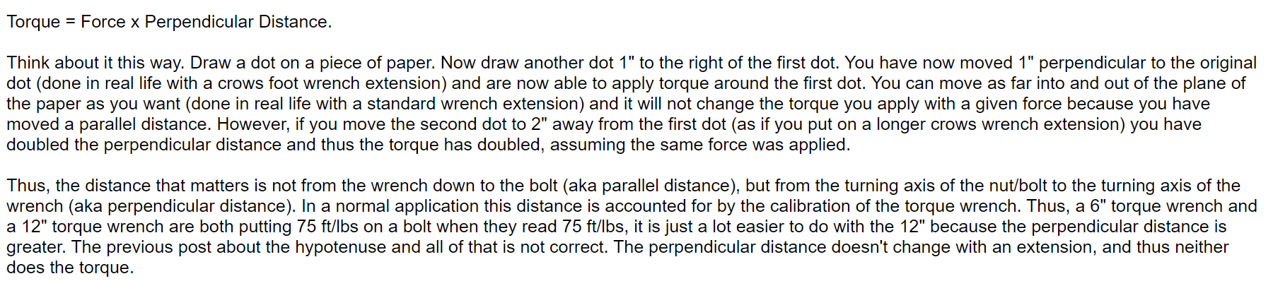

Use the crows foot at 90 degrees - not straight out. Even the torque wrench people say it will be accurate. The effective length isn't impacted like going straight out with it.
(for those who won't believe it...........
