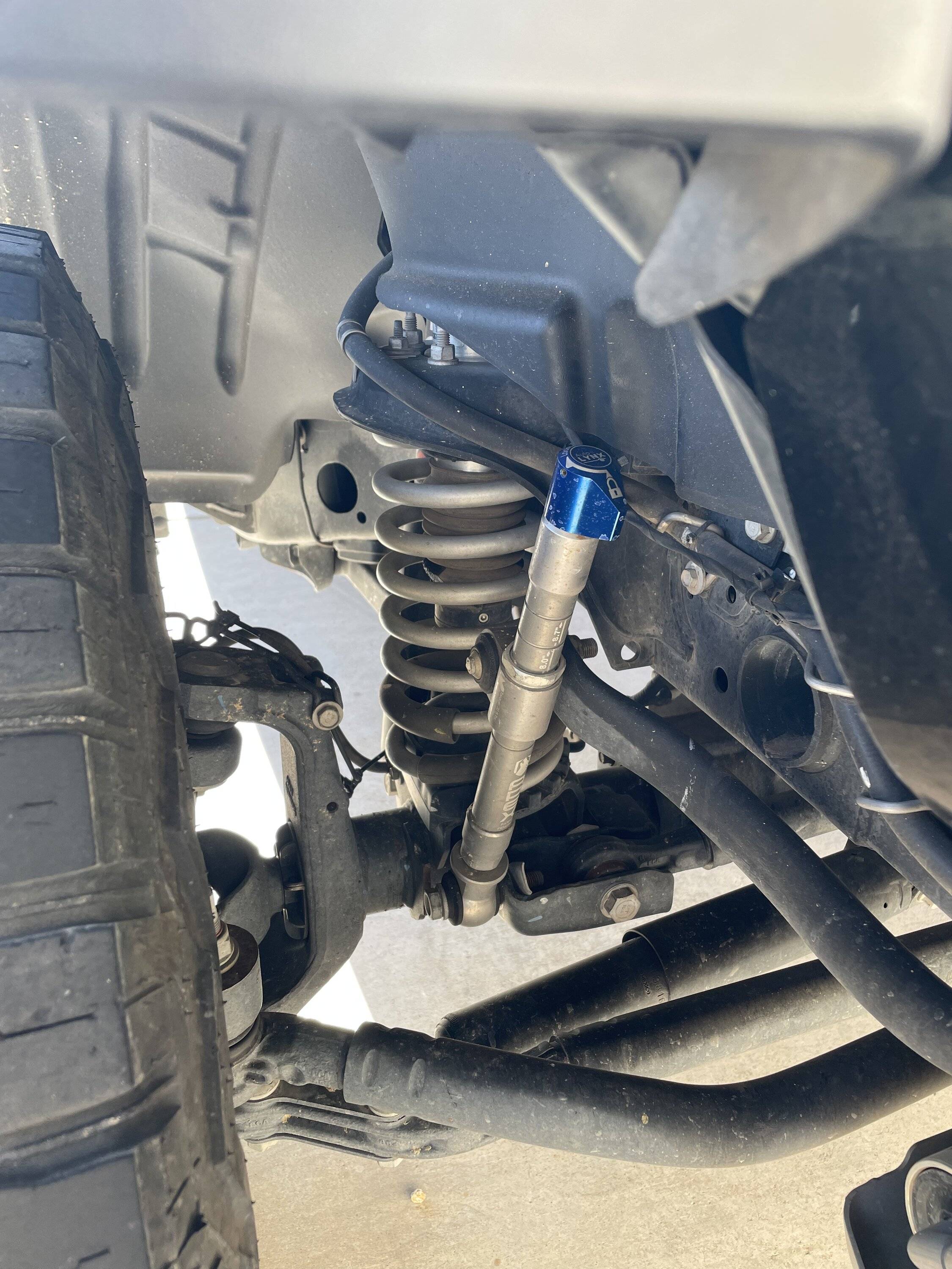

What they look like installed on my JTM. I am running 35's Toyo Open Country R/Ts

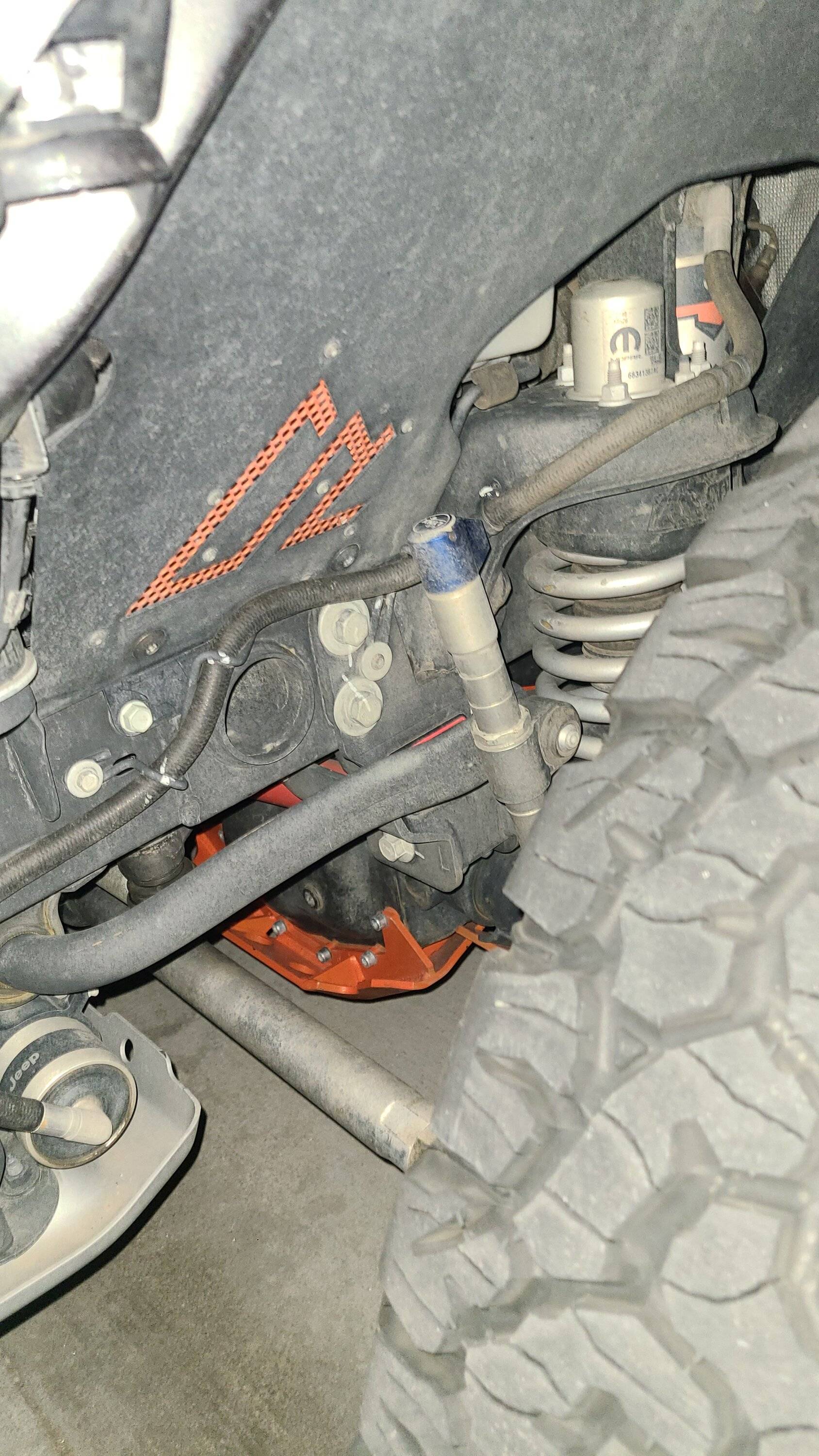

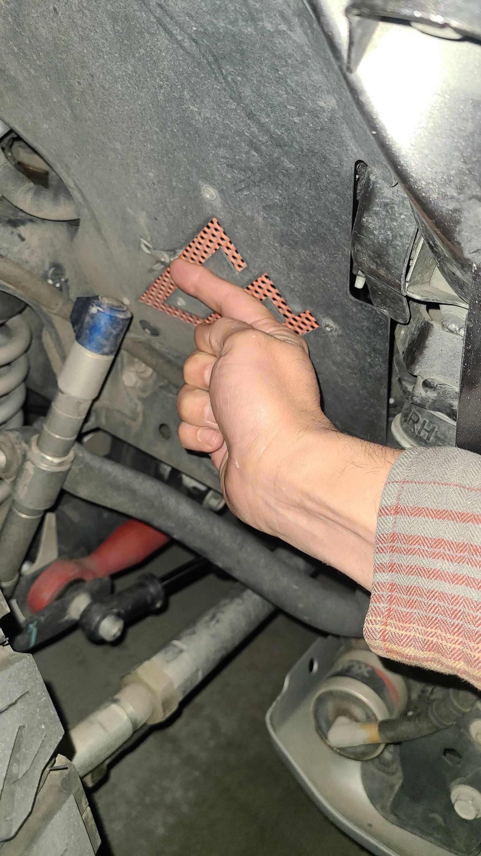

2021 JTM ... 2 inch AEV Spacer Lift ... Apex Lynx ... AAL Inner fenders ... occasional contact on passenger liner (see slight silvering in photo) with hard right turn at speed uphill (e.g. accelerating from stop with a right hand turn onto an uphill road)
Happy to answer more

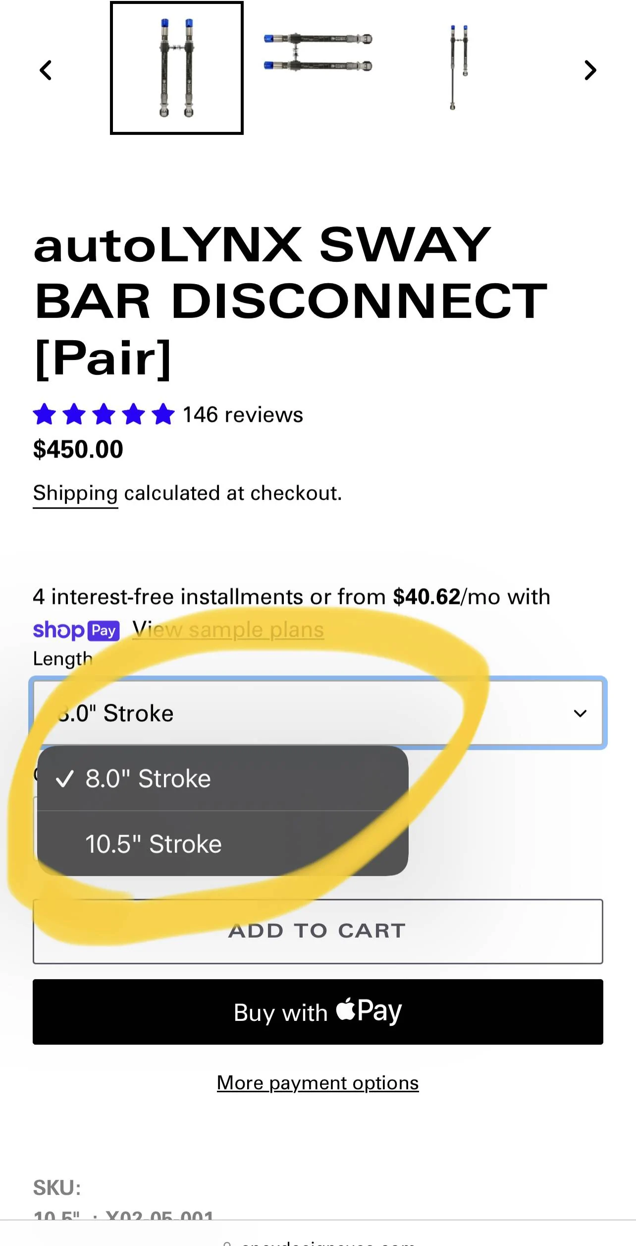

Thanks. This is why I ask, if you're having slight contact with a Mojave which to my knowledge have higher fender clearance to my understanding than my Overland for example, this makes me think I may have the same issue if not more so. I have the AEV 2" spacer as well but on Rubicon shocks.
Considering you have the same spacer lift, I assume you went with the 8" stroke AutoLynx. Appreciate the helpful info but you still really didn't answer what size AutoLynx you have which is what I was asking. Again I assume it's the 8. Trying to have a basis to go on.
Really don't want to buy some and find out afterwards I'll need to cut up my fenders

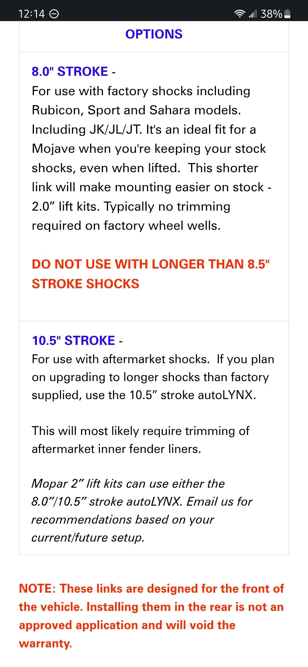

I'm well aware of what their website says. I literally just posted a screen shot from their website on my previous post. So it's safe to believe I clearly seen this immediately under it. Besides the fact I've been on their website off and on for about a year debating on them after finally getting my lift to an acceptable state.
Regardless of what the website says I've been on this forum awhile and have seen numerous claims of people having to trim/cut their fenders I'm sure all while still going by the information given. I can't for sure say that all the claims I've seen have been from those with the 10.5 stroke. But still. The website only mentions possible trimming required for the 10.5 but as clearly stated a few posts ago, someone with 8.0 stroke is having rubbing on basic up travel, not to mention what amount they'd have on actual off-road setting. Besides I've personally known people with the 10.5 stroke that DID NOT need trimming. So again the info isn't clear on what determines why one would verses why some don't regardless of size.
So seems like that info is rather vague then, doesn't it? Hence the reason for my question.

When I initially installed these, I static load tested them by jacking one side of the axle and letting the other side droop ... there was no contact on either side ... the results that I am showing only occur with asymmetric dynamic compression ... I will likely take a small hole saw to the AAL liners just to eliminate the occasional "clunk" ... and with these being Aluminum, I expect this to be straight forward... also for reference, my track when level is within a 1/16" (last I checked)
I would not anticipate a significant difference in the type of contact between trim levels given that the bumpstops should stop us at about the same point (honestly, I haven't actually seen a comparison between the hydro and standard bump stops though) ... the frequency of contact will be different though - depending on things like spring and shock rates (factory for both here), front end weight (e.g. I have a light winch and a mopar steel bumper), and any lift (mojave springs have approx 1 inch more than rubicon and the 2 inch spacer lift)
