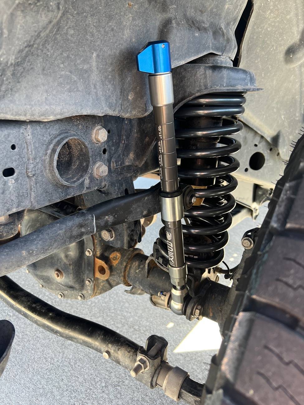

Absolutely love mine. Got them used and have put over 30k miles on them. Flawless. Just bought a new pair for the wife's Wrangler. She had Teraflex quick disconnects, and after the 10th time struggling to reconnect those I bought her the Apex as a very early birthday present.

Liked mine enough that when I increased my lift beyond what the short set could do, I purchased the long set for my new lift
