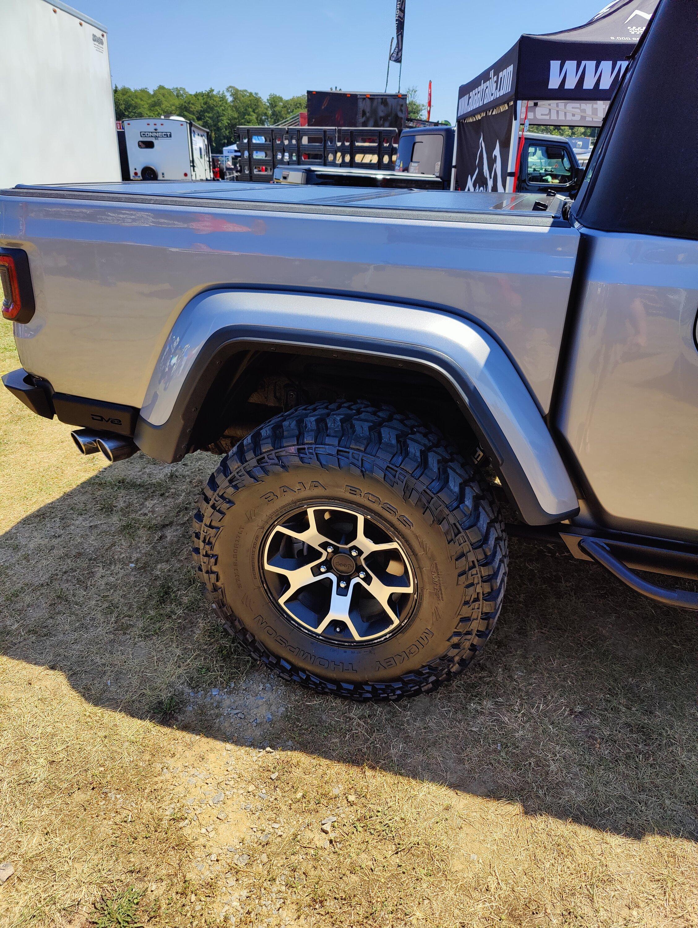

Was just looking at some other gladiators at a show this weekend and noticed that some had a slightly different inner fender both front and rear that extended a bit more than on my 2021 JTR.
Is this a newer version or aftermarket?
Here is an example of the rear. Fronts look similar.

Max Tow I believe.

No they aren't nearly as far out as those. Looks very much OEM. Just never seen them B4.

Max Tow package. Has the additional lip on the wheel well trim to account for the slightly wider rear axle.

Interesting. Thought the rubi would have that too. Can these be installed on Rubicon flares? Do they add any width?

No, but the Rubi flare is already the same width as those. It isn't needed in those. That flare is for the max tow, since it has wide axles like Rubicons and Mojaves, so that it has the same wheel coverage as this trims.
