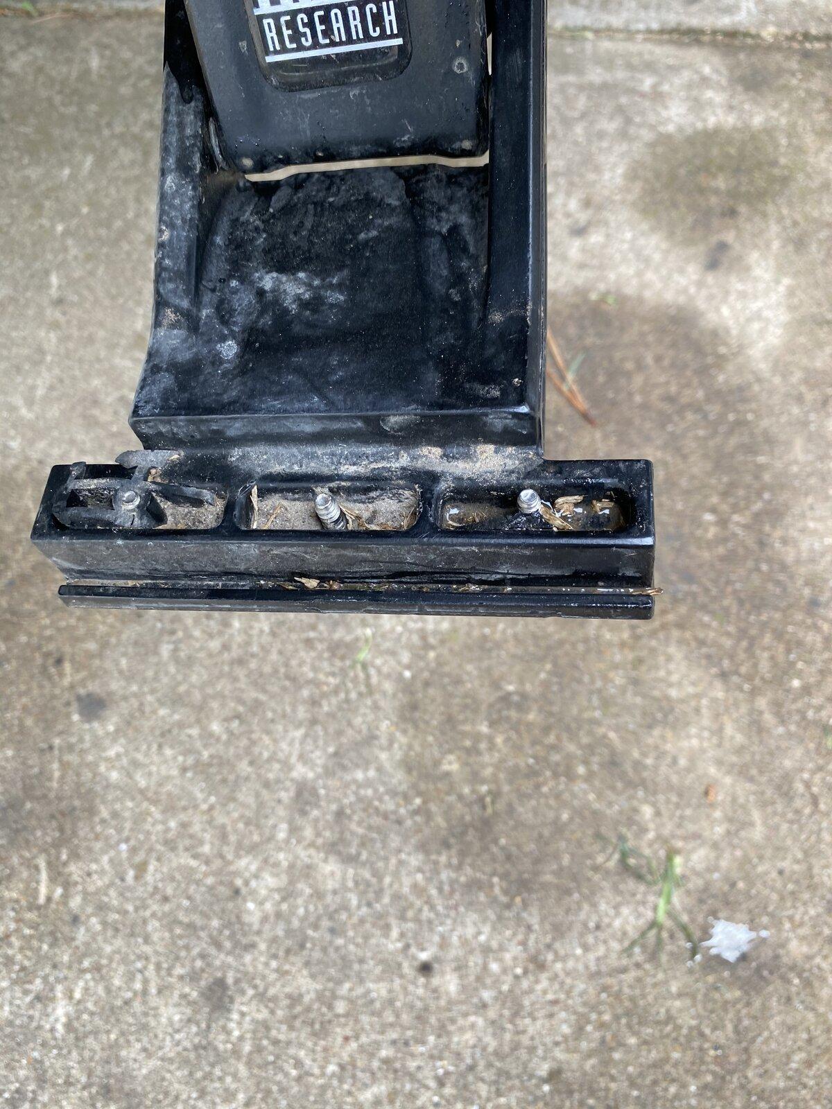

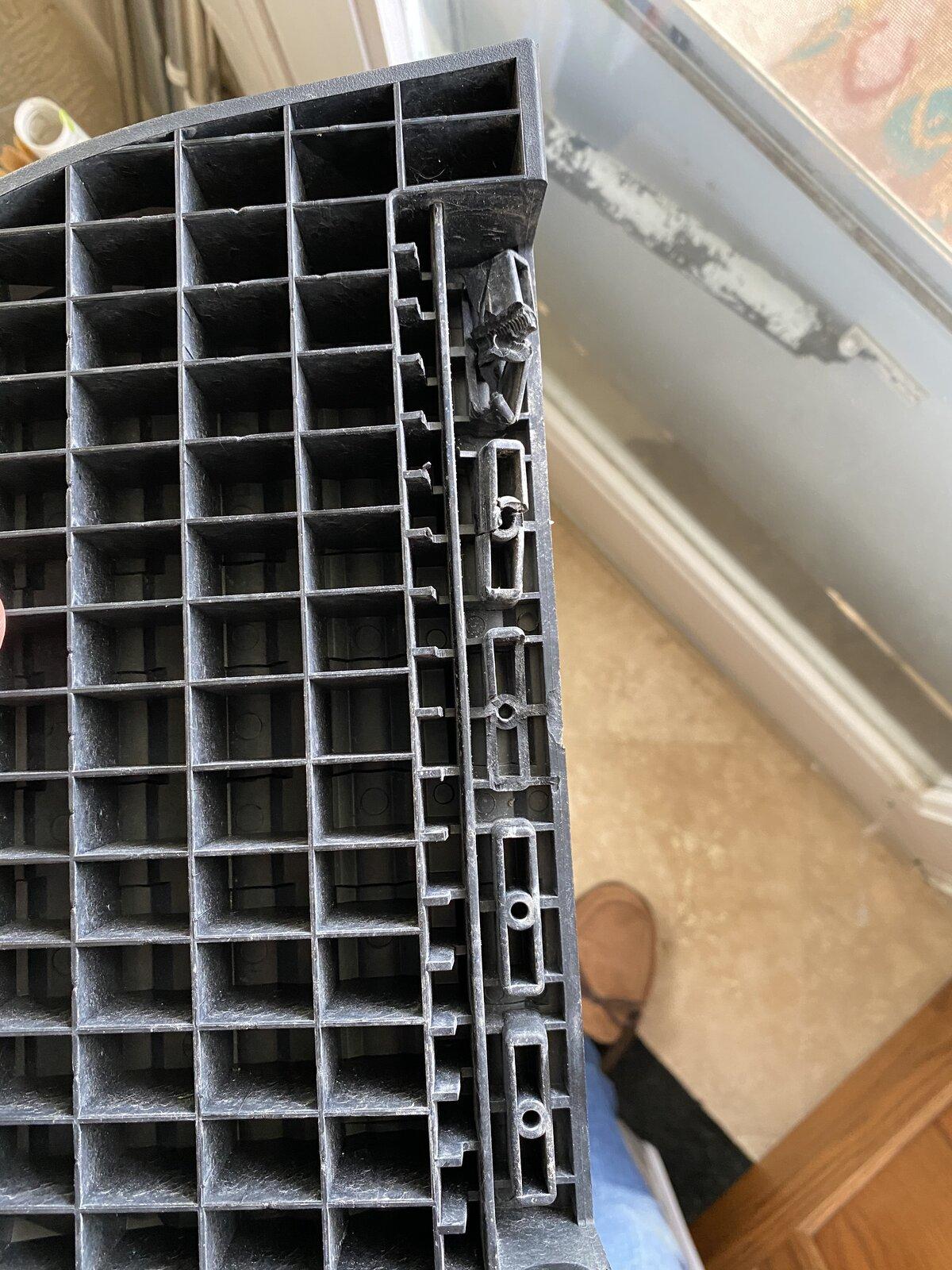

Has anybody had issues with the AMP bed step? After 4 months, with tailgate down, I stepped on the bed step and it broke off, with my left leg hitting the open tailgate. Luckily I wasn't hurt, but it could have been bad. It says it's rated for 300 lbs, I'm 160, so that isn't it.

I don't have it but where did it break? That would be the biggest thing on getting a refund... did the actual step break? or did it rip off where it was supposed to be mounted?

It ripped out of the step where the 3 (only 3!) screws attach to the step. 4 Wheel Parts in Dallas installed it. They already said they would reorder because I bought their 3 year warranty. And I wonder if they installed it wrong. Using those 3 holes, put the step further toward the tailgate.

Looks like they installed it wrong. It should have been the center 3 mounts not on the end. That may have given you the extra leverage to break it. Sorry.
Its designed to be mounted in the center, left offset, and right offset. as per their instructions...
Such a shame, cause for the price of that little step. It had better be damn near bulletproof. Actually, I was on the understanding that they were cast alunimum :movember: Then again, i never looked at them in much more detail after i saw the price ahaha
Imo, that's a poor design anyways, having what looks like 3 m6 screws just threaded into some thin plastic. I get its keyed to fit, but damn.
I thought it was installed incorrectly also. Only 3 screws doesn’t seem to be an engineering design! I’ll get my new one and this time make sure it’s at least installed properly. Could have some injury liability if they’re not more careful.
