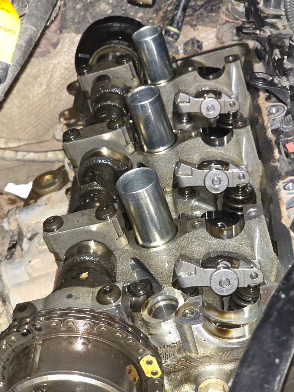

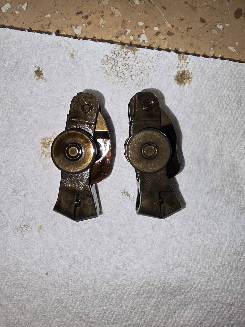

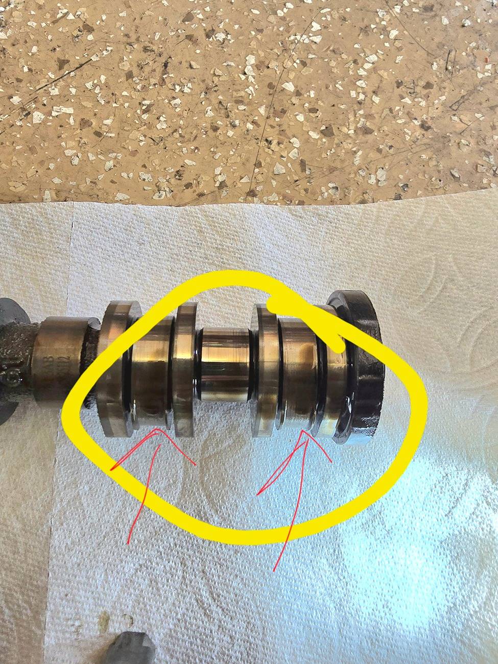

I joined the tick of death club.
Intake rockers and one lifter were shot on the pass side. Buttoned it all back up and it won't start. My buddy said he heard something hitting the valve cover.
Are there common errors to look for as we tear it back down again tomorrow?

Curious as to how many miles you have on your JTM?

95k.
The issue ended up being the rear rocker fell off its seat when we assembled it the first time.
Second Time around replaced that rocker and all is good.
