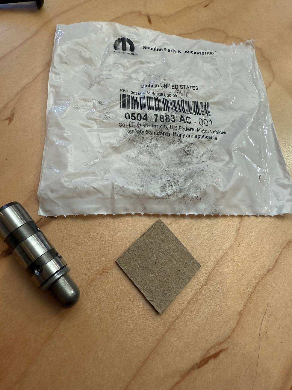

Jeep Gladiator 68661147AA - Right Side Intake Camshaft IMG_3576
Does anyone know why the lash adjusters all come with a little square of cardboard?

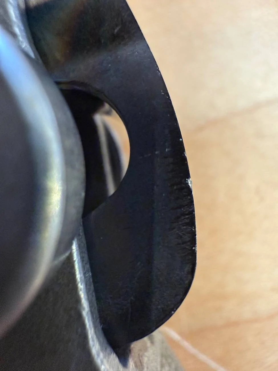

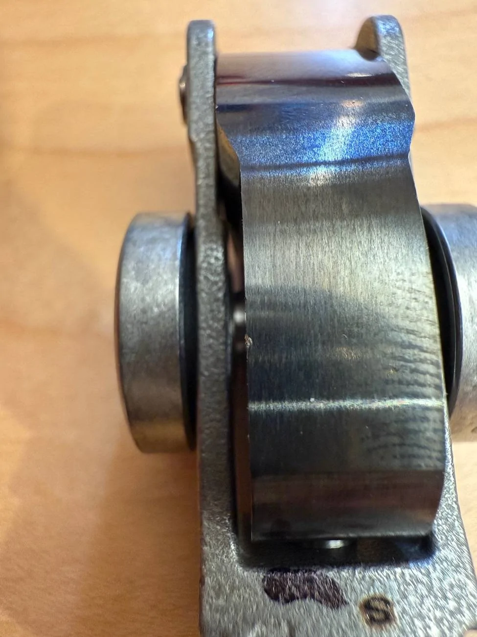

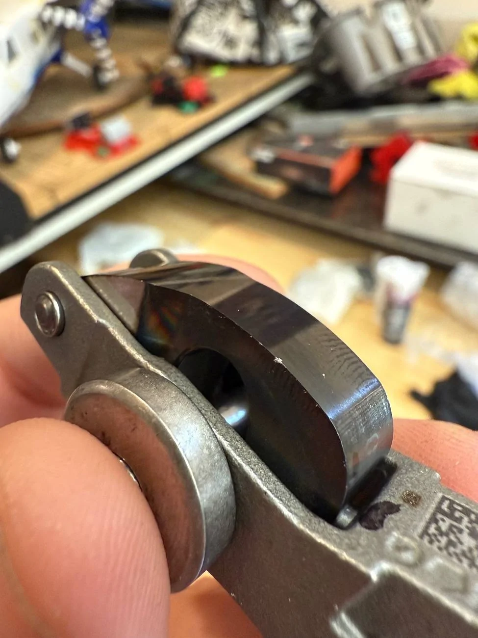

I also found this burr in the edge of one of my new rockers right out of the packaging… It easily catches my fingernail. I’m thinking this rocker will not be getting installed.
Jeep Gladiator 68661147AA - Right Side Intake Camshaft IMG_3578
Jeep Gladiator 68661147AA - Right Side Intake Camshaft IMG_3579
Jeep Gladiator 68661147AA - Right Side Intake Camshaft IMG_3580

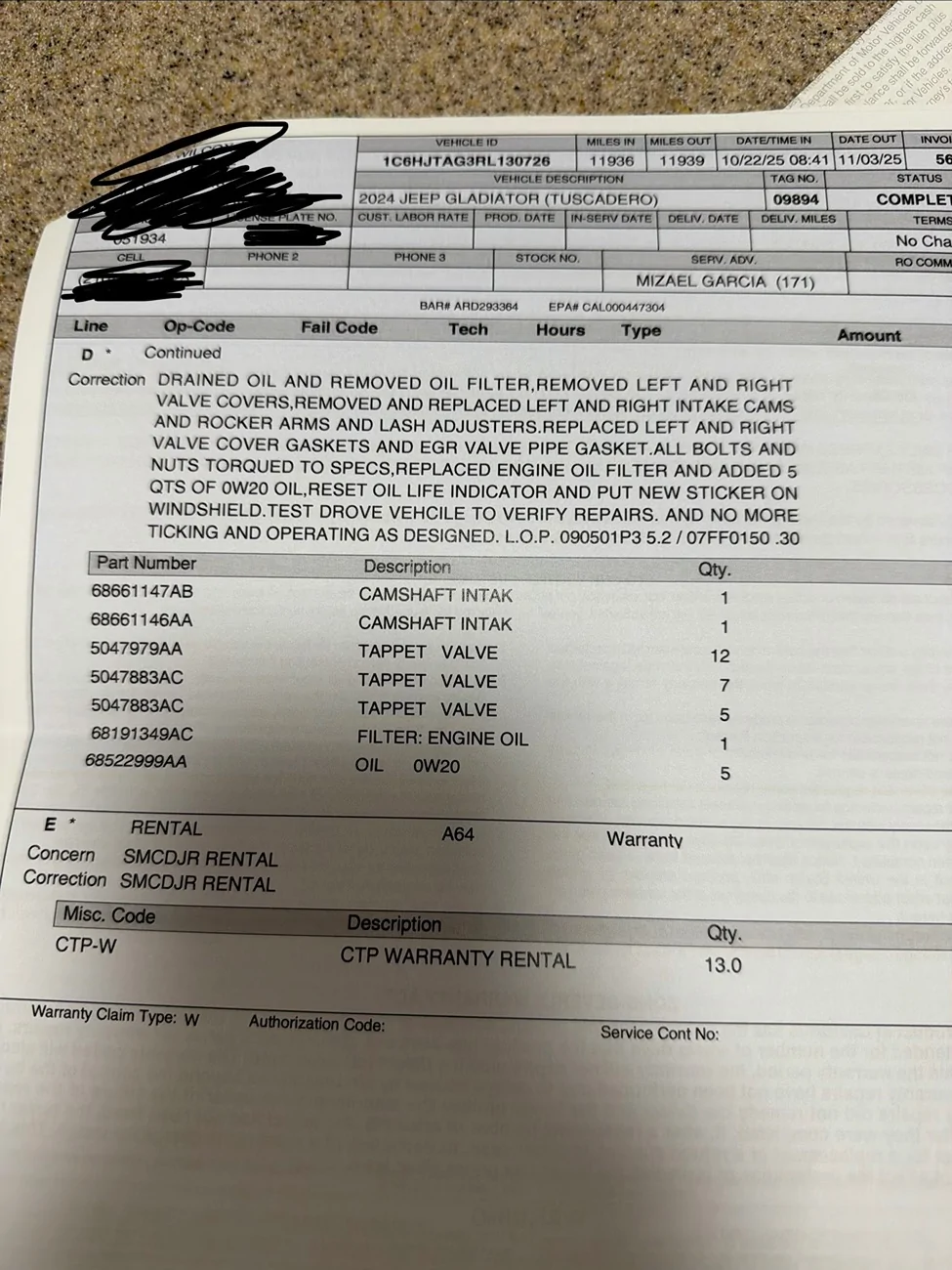

Been quiet cause parts were delayed and delayed so we kept the Durango rental through the weekend for our Big Bear Lake trip (wasn’t great, wasn’t bad, it was just ā€˜OK’). Got the call on our drive home today that our Glady was all ready for pickup! Got to her and expected a light tick still but nope! Purs like a kitten again šŸ™Œ
All-in-all, the dealer had her for 13 days and replaced both sides intake cams, rocker arms, and lash adjusters. See invoice:
Jeep Gladiator 68661147AA - Right Side Intake Camshaft IMG_0077
I’m very happy for now, just praying this tick never comes back again. I’ll keep a mental note for all future oil changes to listen closely for the return of that god awful noise lol
I’d like to re-iterate that this has been an ongoing issue with these Pentastar 3.6L V6 motors and most dealers do not have this kind of turn around. Idk if these guys have a parts hookup or what but most people describe waiting MONTHS for this warranty work to be completed, not two weeks.
I’m chalking this up as a win for this dealer (Santa Maria CDJR) and the MOPAR parts distributors as I’m assuming they’ve figured something out with these back ordered parts. Or…they replaced them with less superior parts in which case they’ll replace them again down the line under warranty šŸ¤·ā€ā™‚ļø
