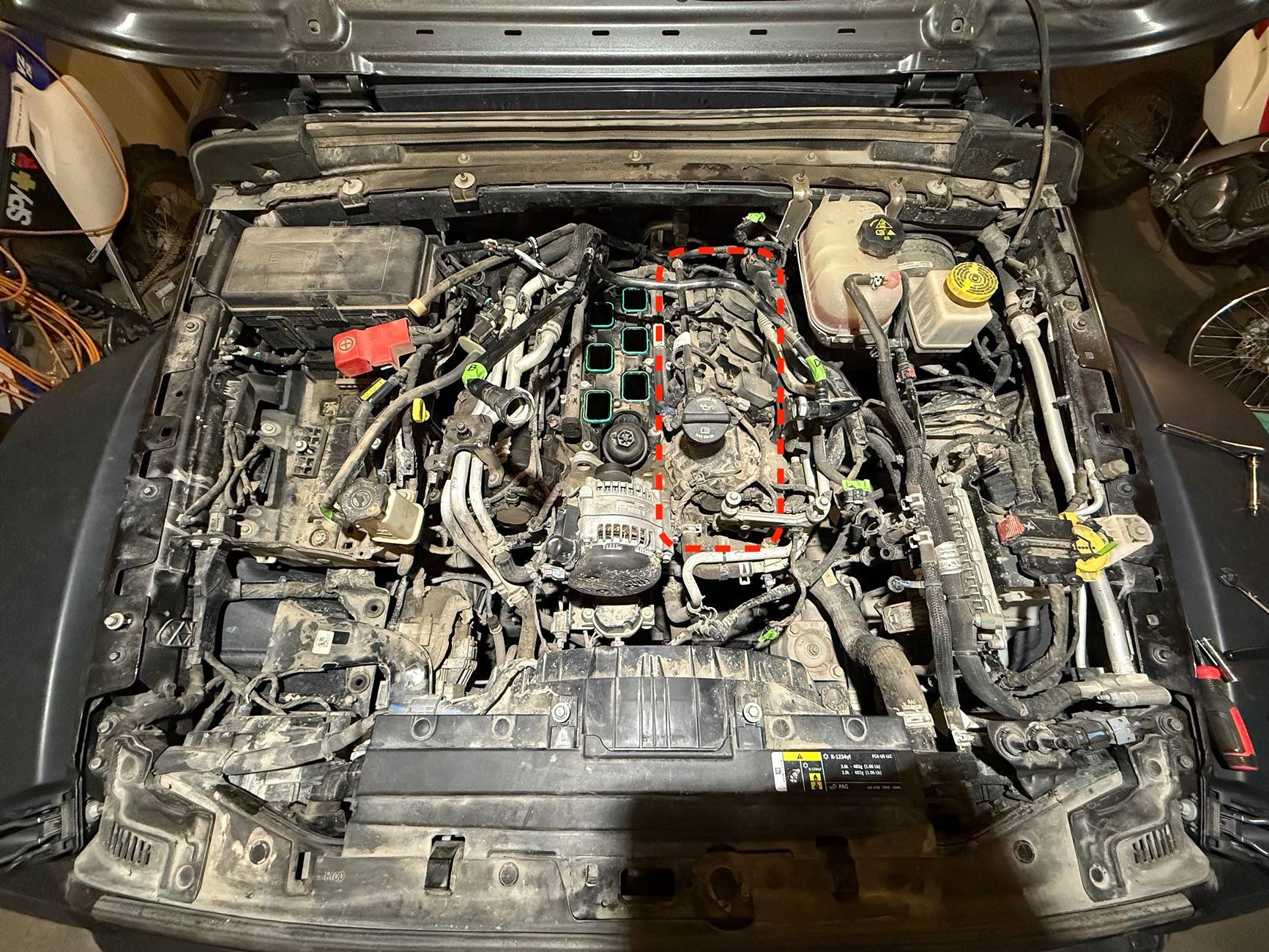

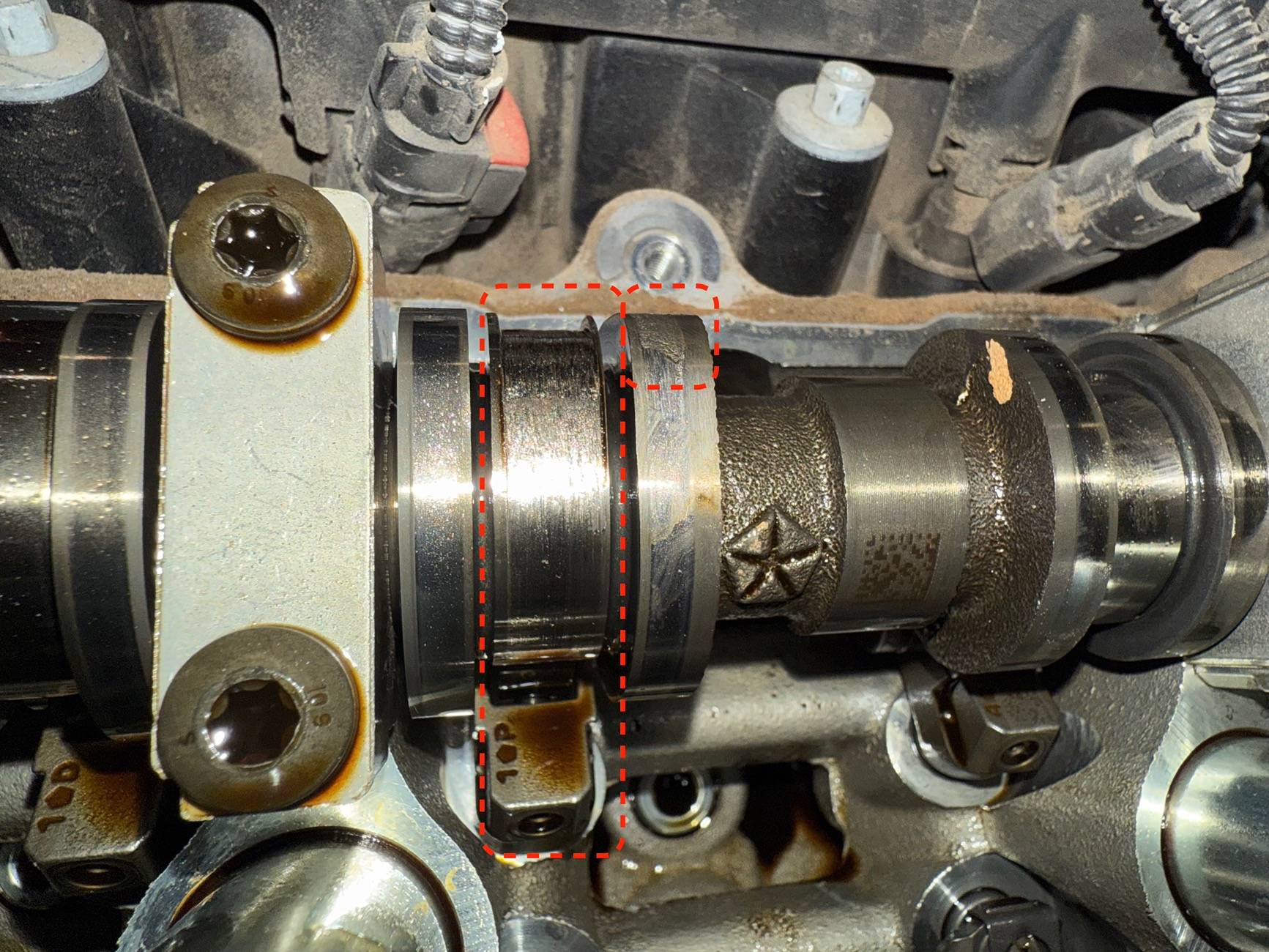

Well I found out which one it was late last night... Drivers side intake cam. Do you call this one the Left Intake Camshaft? (Drivers perspective).
Always go by sitting in the driver's seat, regardless. So even in Australia, the left bank is the left bank. And that's bank 2 on these.
Bank 1 is the right side - again, sitting in the driver's seat.
Since there are Aussies and Brits here - I try to make sure if I use "driver" and "passenger", I'm clear on left or right.
Short - that's bank 2, the LEFT bank.
That's good to know, thank you.
Well the good news is this is not the part on 12,000 backorder with no lead time in sight! I actually had that one replaced last year and I was very worried that it already failed again.
I should be able to have the parts to put her back together next week. What I don't know is do you typically replace the lash adjusters each time? I'm getting all the gaskets as well.

If it was mine, and this is how I operate on engine repairs and builds, especially if it's me doing it and not a dealer - since the exhaust lash adjusters are where the oil comes from that shoots to the intake cam lobes, I probably would.
And since there's been a TSB for later year intake lash adjusters, i'd be tempted to do those as well. I'd check the exhaust followers (rockers) to make sure that opening for the oil to shoot at the intake lobs is clear, clean, no flashing or other debris or build-up.
