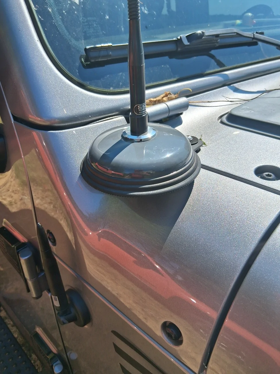

I run 2m 70cm ham rig. The antenna mount is from Amazon. the antenna and magnet mount is from DX engineering. Diamond antennas are top shelf and they make some for GMRS. It stays on just fine at 80mph.
I just remove antenna from the mount and set it inside when I go through the car wash.

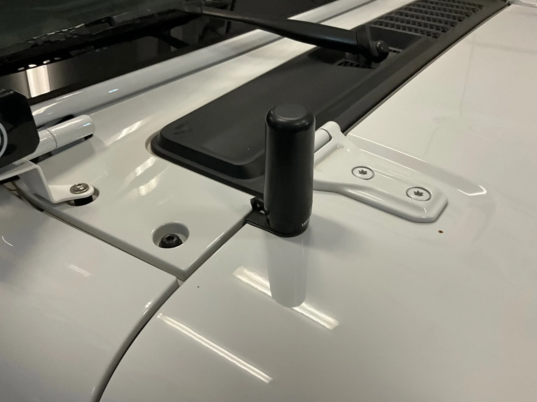

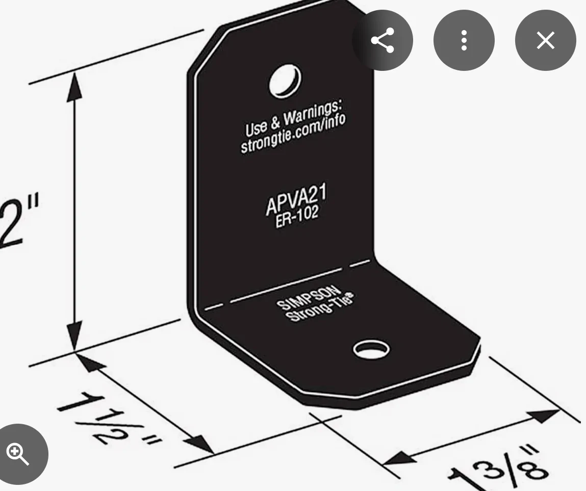

I haven't had any performance concerns with the Ghost antenna mounted directly to the windshield hinge bolt. I think I just used one of these Simpson Strong Tie L Brackets from Home Depot. Couldn't find any better pictures unfortunately.....

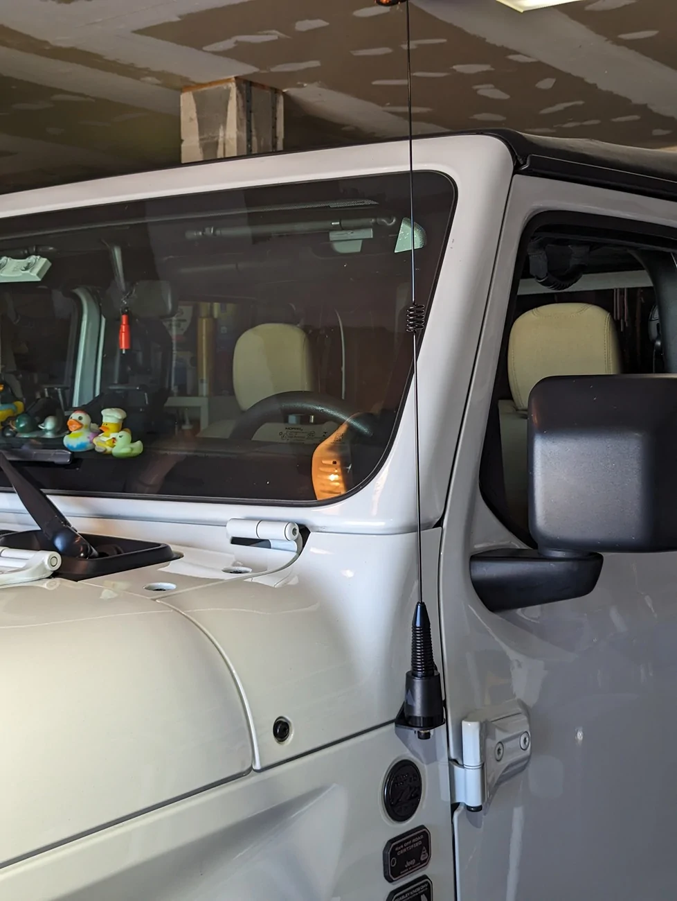

I have been using the Midland MXTA26 6 dB High Gain Whip GMRS Antenna for my 275 radio, mounted as shown in the image. The bracket (~$20) mounts near the A pillar using an existing bolt hole.
Performance has been more than satisfactory for my use while wheeling in national forests.
(Also, I've since moved the bracket to the forward bolt to make room for another accessory.)

This is a very good use case for the 6db gain. It emits a higher “plume” of signal that gets out over the trees and cascades. 3 db is flatter so doesn’t achieve as much height.
Did you have to drill out that bracket to fit the antenna connection? I looked at the Rugged Ridge version of that one but wasn’t sure on mounting hole size for antenna.
It's been a few years since I installed it, but my memory says that it worked without modification. (Fishing the cables and creating a proper ground connection actually took more time than assembling and mounting the bracket.)
