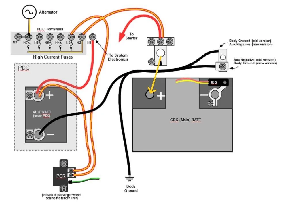

True that the aux battery now doesn't power the N1 post - the MAIN battery does UNLESS the engine is running, then it's the charging system - and it's absolutely fine. There's not that much of a load. It will handle it. Many people have removed the aux battery ground and been FINE.
As long as the engine is running and the output from the alternator is greater than battery voltage, the ALTERNATOR powers things. He who has the most voltage/pressure, wins.
Power flows from source with highest voltage to the source with the lower voltage (or the load)
We've been over this for over a year and Jerry as well as others have indeed pulled that ground.
N3 is a huge fuse - more than capable of running all electronics and HVAC, cluster, heated seats and so on.
Heck, when the aux battery is bad N3 handles things anyway - the aux battery isn't doing it because it's bad. Open sell, weak cell, diminished capacity, whatever. Batteries don't run the systems, the charging system does. Even when the aux is fully charged, the charging system is running things. So normally, N3 is feeding things.
N3 down to PCR, back up to N1 past the aux battery positive. N3 powers things normally - the aux battery even if good is only 12.8 volts tops. The charging system is pushing out over 13 - so, tell me where the power is coming from ? Not the aux battery - from the alternator.
It works fine, many have done it, not only Jerry. There's no reason for it to not work long term.
Reading this shematic I believe my 2022 diesel falls into the new version and the Aux battery is the main plate over the IBS. You can't just remove this terminal without relocating the wires on the wing. Correct?
Small wire is Aux wire and the larger wire on the wing is the body ground??
