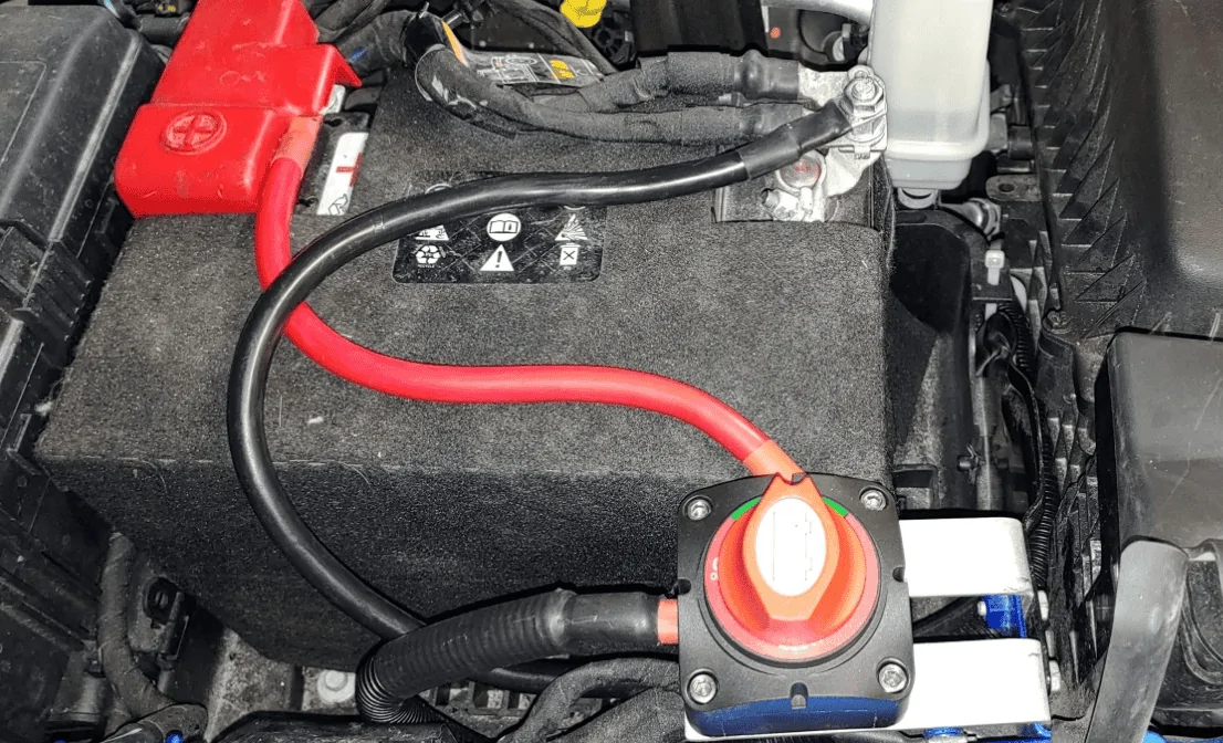

Small main battery - no aux switches, etc.
End of battery almost even with rear of PS reservoir
and plenty of space to feed cables and so on->

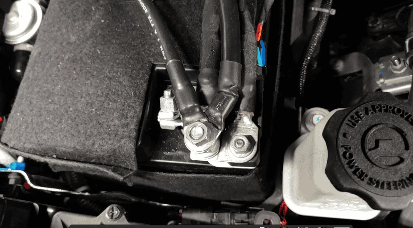

Larger 700 amp battery - crowded in tray,
